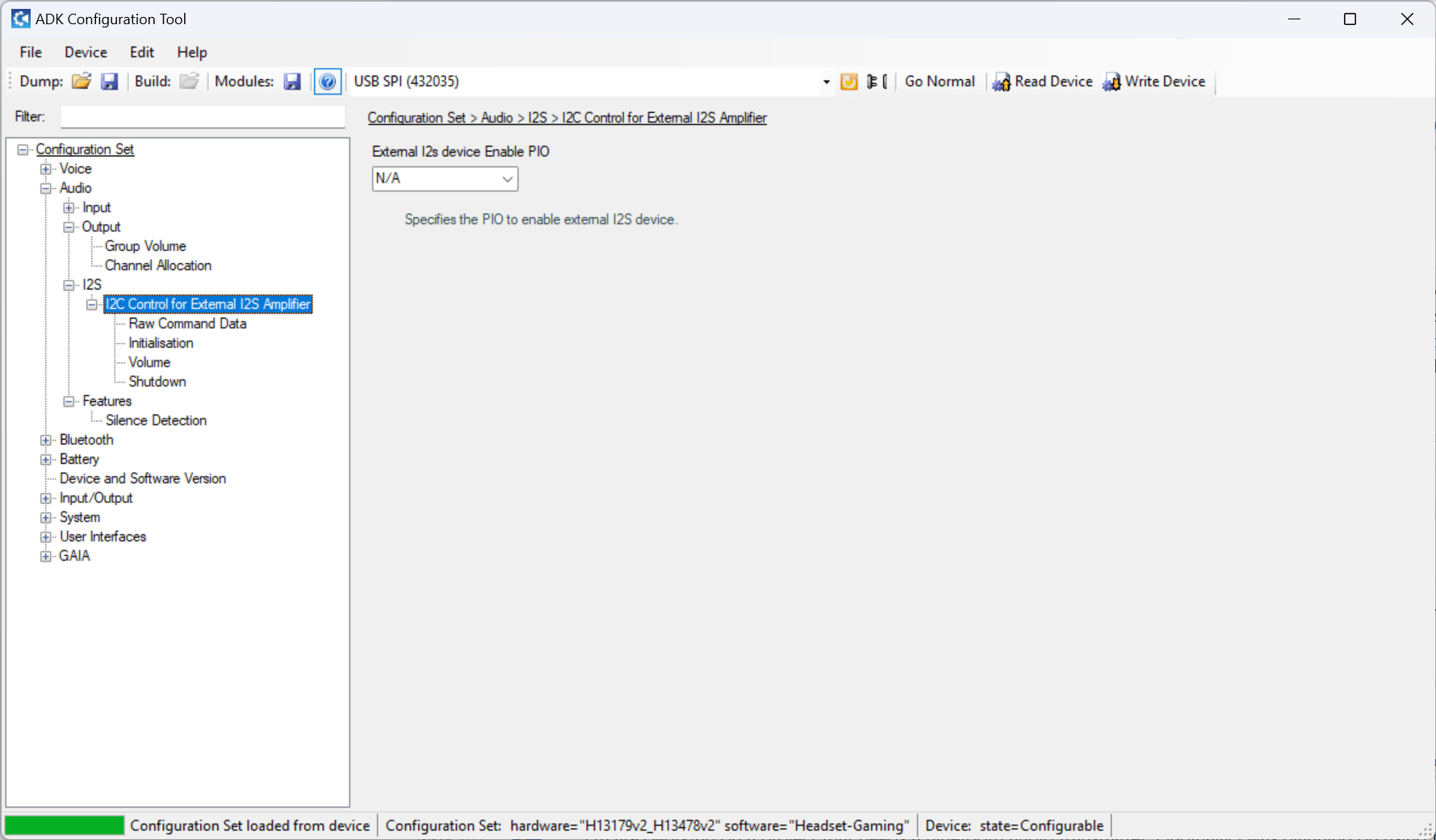

Where is SCL and SDA for I2C on a CSR8675? My application requires driving a CODEC using I2S alongside I2C. I read the datasheet and its not helpful:
"CSR8675 BGA contains a configurable hardware I²C interface. For more information contact CSR."
I see the following in the ADK config tool, but there is no indication as far as what PIOs are used for I2C:
I am using a BTM875-E module. Thanks.
@goose_ader you are looking at the sink project configuration. If the sink project uses I2C this tool will only have I2C configurations specifically tailored to the sink project (for eg, controlling an external I2S device as shown in your screenshot) and you might not be able to do any generic I2C communications if that's what you want. Look under Input/Output, System and User Interfaces in case there is anything relevant. The pin numbers 60 and 61 you quoted are for a completely different chip and development board, so they are not relevant for CSR8675 at all.
The CSR8675 datasheet does not have any information about I2C as far as I remember. There is a separate document that has more details about the sink project configuration specifically, but I don't remember it having any information about I2C either. Look for a file called "Sink_ConfigSetDefinitions.xml" (This depends on which version of ADK you are using, your filename might be different or this file may not exist at all). If it exists, this is the file used by the configuration tool app to display the tree structure as well as all it's text. Search for everything related to I2C in this file, if looking for it in the ADK config tool app itself is tedious. If there's no information at all, search for everything related to I2C in pstool for more information. Look for a file called pskeys.txt in your ADK installation. This file contains all the text shown in the pstool application. Search through this file for all information related to I2C.
@mahaju Thank you for the response.
There is another key for the SDA too.
It explains that the "default value of I2C PIOs are defined in device datasheet" but this is not true after my findings. I'm assuming I can just configure the PIOs in PSTool to the options available above?
It seems silly to me that CSR would advertise I2C configuration and not have any information regarding it. Anyways, I did not find anything helpful in the ADK config tool. But I did see something of interest in the pskeys.txt file:The CSR8675 datasheet does not have any information about I2C as far as I remember.
Code:
NAME
PSKEY_I2C_SCL_PIO (0x25f9)
SUMMARY
I2C SCL PIO Mapping
TYPE
uint16
DEFAULT VALUE
<none>
DESCRIPTION
This PSKEY is used to configure a PIO as I2C SCL line. This
configuration is restricted to the lower PIO bank
( i.e. PIO0 to 15 ).Consult the BlueCore data sheet to determine
the PIO number which can be used.
Value SCL Mapping
0x0000 PIO0
0x0001 PIO1
0x0002 PIO2
0x0003 PIO3
0x0004 PIO4
0x0005 PIO5
0x0006 PIO6
0x0007 PIO7
0x0008 PIO8
0x0009 PIO9
0x000A PIO10
0x000B PIO11
0x000C PIO12
0x000D PIO13
0x000E PIO14
0x000F PIO15
Note:
1. Any out of range value (Values other than 0x0000 to 0x000F)
maps I2C SCL to its default configuration.(The default value
of I2C PIOs are defined in device datasheet).
2. The user must set both PSKEY_I2C_SCL_PIO &
PSKEY_I2C_SDA_PIO to enable this feature.
@goose_ader give it a try. I don't know what default I2C configuration is, I've never used it. Your best bet is probably setting SCL/SDA in pstool and hope for the best. You will still need to find the relevant functions/API in the C code in order to actually start using it. And as far as I remember it only supports I2C master.I'm assuming I can just configure the PIOs in PSTool to the options available above?
One thing you should keep in mind when using CSR8675 is it recycles parts of it's documentation from older versions and but does not make it clear when it does so, and sometimes outdated documentation makes it's way into newer versions of the ADK. It's possible that
was true at some point when this part of the documentation was originally written, but it's not anymore. Sometimes the features you are trying to work on in a newer version ADK, are explained in more detail in the corresponding documentation of older version of the ADK.The default value of I2C PIOs are defined in device datasheet

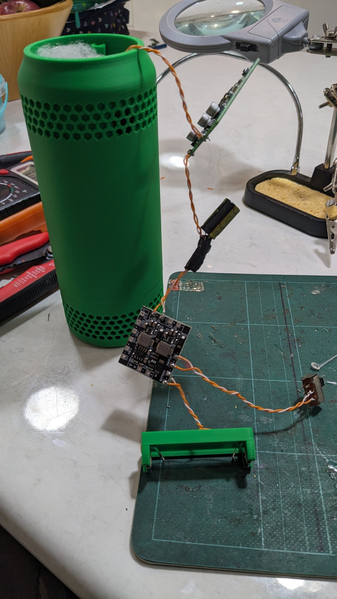

Hi folks, i was trying something new with a combined BMS/Voltage Step up module and a different QCC BT Amp and have an issue. For a starter, i asked a guy on fivver to design me up a PCB which has a TP4056 BMS and 3 voltage boosters which i thought was a MT3608. I also wanted the ability to have a SPST and solder some LED's and USB C breakout board. i asked as well that this board could handle a full 2x 2A at 5V and a 2A at 6.5v for me. The amp i used is a QCC3034 chip that has a self boost apparently to 5.5v which will give me 8watts per channel at 4ohm. From another build using a smaller chip amp, it was advised to put a small cap on the power leads which i assume is to prevent a brown out.
So why am i posting you ask? I seem to have an issue out the power out to the amp where at full volume being put through a bass heavy song that the amp turns off and putting a volt meter on it you can see it drops from 5v to 4.8v then 1.6v which causes the shut down. What i would love to know is can i somehow prevent this without being told to run it at 3/4 volume as i want to make sure i can punish it if needed.
Its my own "Boozetooth" 360 degree speaker i've been refining and fiddling with for the last 4 years and now up to MK12 (or 13), which this one has a Dayton Audio DMA45-4 driver (mono), custom PCB\BMS, QCC3034 amp, 1x 18350 Li-ion battery (1100ma). Any help would be greatly appreciated as i would love to keep the limited parts, otherwise ill have to go the less powerful QCC3003 (2x 5w/ch), TP4056, MT3606 and just take up more space.
(PS the QCC3034 is hanging off the top of the can in the image).
