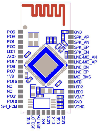

just out of curiosity for maybe another project, but which ones are the four I2S output pins from this ebay PCB? I mean BCK,LRCK,DATA and MCLCK
I've attached the document I got with my module which is, I believe, just a breakout board for the CSR64215 module.
I'm not sure about MCLCK, but the others are as follows:
DATA -> MISO (pin 11)
BCK -> CLK (pin 9)
LRCK -> CSB (pin 10)
Also SPI_PCM (pin 7) has to be connected to GND to enable I2S.

and this is extracted from mine, the chip on the pcb is rotated by 45 deg (CSRA64215 4.2 Stereo Bluetooth Audio Module support AVRCP A2DP APT-X CSR8645)
