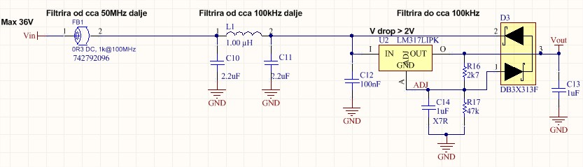

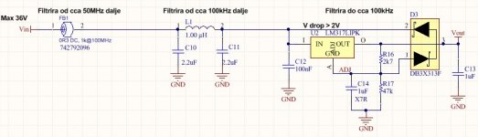

...If CSR8645 is powered by LM317 from the same 12V, there is some hum noise. I wonder what is the best way to get rid of that hum.
This is my solution to the noise in the power supply with lm317.
Keep in mind, that lm317 is perfectly capable of maintaining reference voltage 1.25V up to 100kHz(-3dB). The trick is to use capacitor(1u - 10uF) on the "bottom" resistor to maintain the voltage on the divider as stable as possible independent of the output current.
The drawbacks of using LM317 instead of LDO are:
- the need for dual diode to protect the circuit at turn off from voltage in the capacitor.
- Large voltage drop because of the lm317(usually around 2V)
- High power dissipation at high current(eg. 1A at 2V drop = 2W => TO220 case can heat up to 100°C without heatsink)

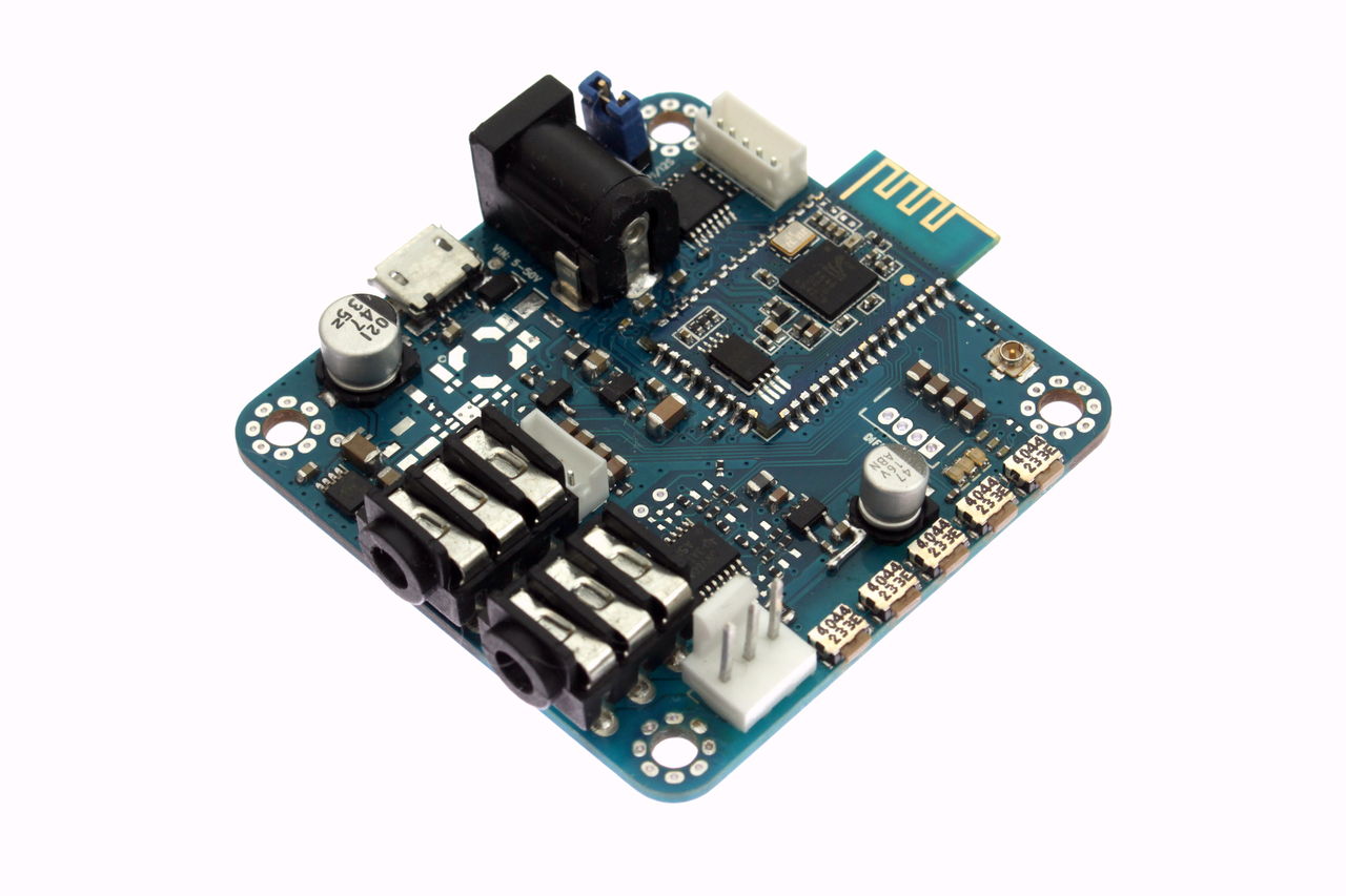

Attached is the last iteration of circuit I use, for powering noise sensitive preamplifiers, that is serving me quite well.

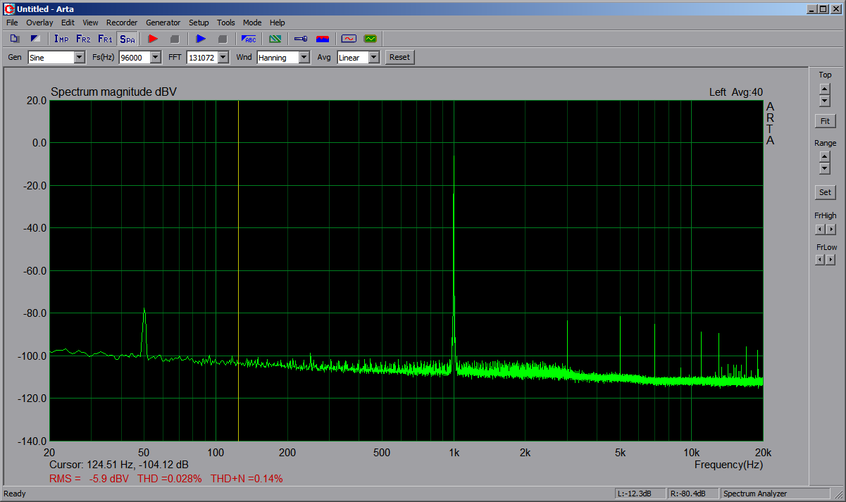

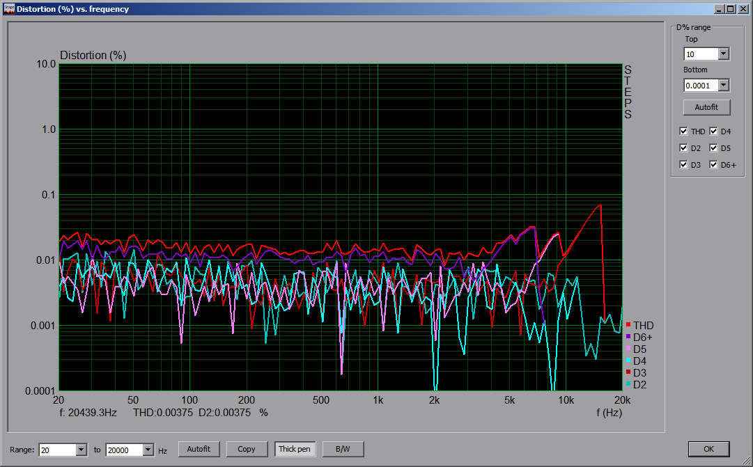

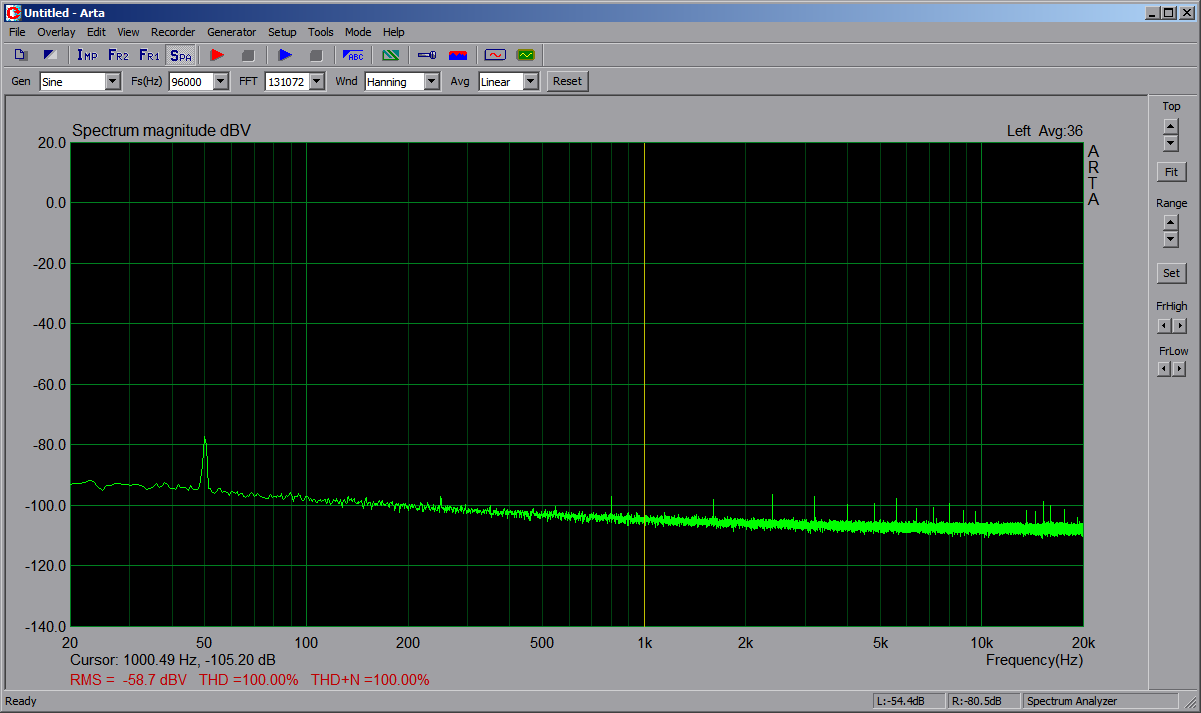

I measured the performance of by breakout board. This configuration doesn't make use of the flybuck isolated analog supply option. It's straight cascaded LDO option.
TPS7A6601-Q1 input LDO (5-40V)
TPS799 Ultra Low Noise, High PSRR LDO Vdigital
TPS799 Ultra Low Noise, High PSRR LDO Vanalog
Analog GND is linked to system GND at one point only.
Static noise with open link:
1kHz at -6dBV output level:
THD at -3dBV:
With harmonics at 0.005% at THD at around 0.01% i would call this a descent audio performance.
Complete results are shown here:
THD at -3dBV:
CSR8645 Bluetooth 4.0 ? APT-X MP3 AAC FastStream ? Breakout Board ? #360customs

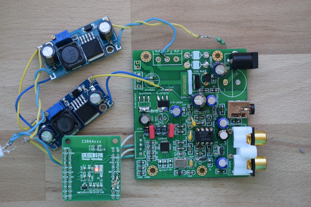

Thanks to this thread and some luck I have made two dacs/amps with a bluetooth receiver. One is a car bluetooth dac/amp and the other one is a pocket sized dac/amp for use with a smartphone or tablet.
Thank you all who replied about fixing the noise issue with CSR 8645. For the most part, loud clicking noise was due to using only one phase of analog out from CSR 8645 module. After I made a proper low pass filter the clicking noise is gone.
The other source of noise was a computer PSU that I used as a 12V power source, after switching to a simple transformer 12V adapter the noise is gone.
Thanks to a post about CSR64215 with I2S support, I have ordered that module as well and I can confirm that it works with an ES 9018 K2M dac board over the I2S. It all worked on first try and sound quality is really good and a big improvement over smartphone/tablet audio and even over a PCM 5102 based dac. ES9018 K2M dac board is very cheap at only $12 on AliExpress and is made with good quality caps (Panasonic, Elna) and resistors. For those who wanted ESS 9018 sound in a pocket or for home use, you can now put it together for about $40 including the battery and aluminium case (see links below).
I have tried playing different files with Android 7.1, Android 5.0.2 and Win 10 devices and all work without issues. CSR64215 (and CSR8645) auto connects after power off, so there is no need to pair to it again unless you are using several different bluetooth devices. It plays different bitrate files without any issues. I have tried uncompressed PCM at 1.4 Mbits and some high res files 192 kHz and 384 kHz at 24 bit it all plays fine as long as the player supports playback of such files (MXPlayer on Android). I assume the player dose on the fly convertion to lower bitrate, but the sound quality is great.
Here is a photo of what I made. I have removed and replaced some parts. es9018k2m is now powered by a single 1117 3.3V linear reg, but I will install two LDOs to reduce power consumption (do not really expect any sound quality improvement).
Here is how I connected it:

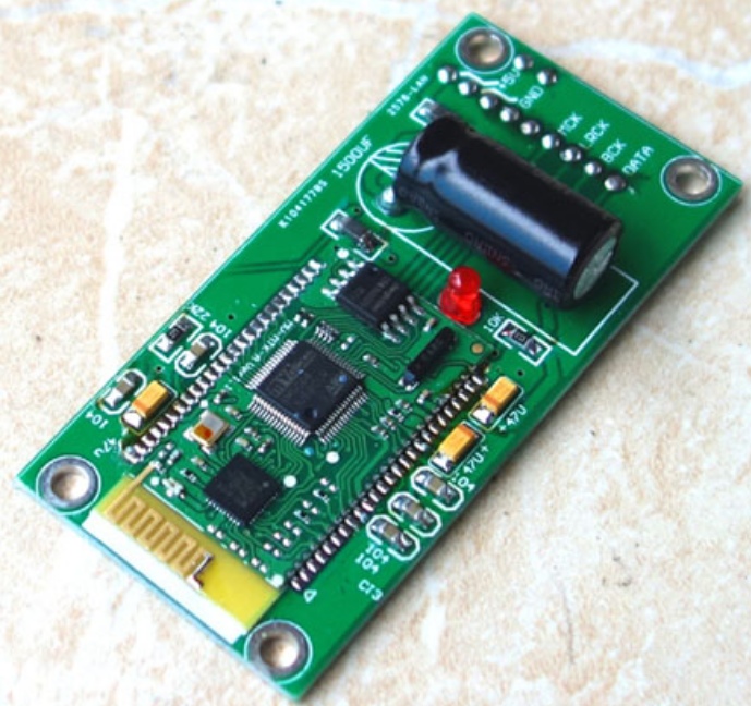

I have also found this summary on TaoBao, it confirms that CSR8645 modules do not have I2S enabled.
As mentioned above. there is a module on AliExpress with properly labeled I2S output (DATA, BCK, LRCK, MCK ). It is called C10 bluetooth with I2S.
It is not clear what is the bluetooth chip on this one, but it should work with AK4497, AK4495 and AK4490 dac boards that require MCK.
The link is :https://www.aliexpress.com/item/C10-Bluetooth-I2S-Daughter-Card-5V-DC-Assembled-DAC-Board/32725179070.html?spm=2114.30010308.3.1.ijDxpQ&ws_ab_test=searchweb0_0,searchweb201602_3_10065_10068_10000074_10000032_119_10000025_10000029_430_10000028_10060_10000067_10062_10056_10055_10000062_10054_10059_10099_10000022_10103_10102_10096_10000018_10000019_10000056_10000059_10052_10053_10107_10050_10106_10051_10000053_10000007_10000050_10084_10083_10000047_10080_10082_10081_10110_10111_10112_10113_10114_10115_10000041_10000044_10078_10079_10077_10000038_429_10073_10000035_10121,searchweb201603_3,afswitch_3_afChannel,single_sort_3_default&btsid=0fa07a8c-0a7b-426f-805f-31ceff2f0ee1
