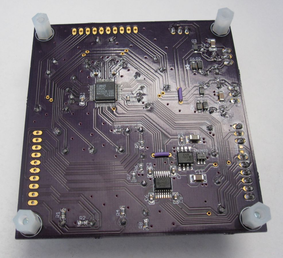

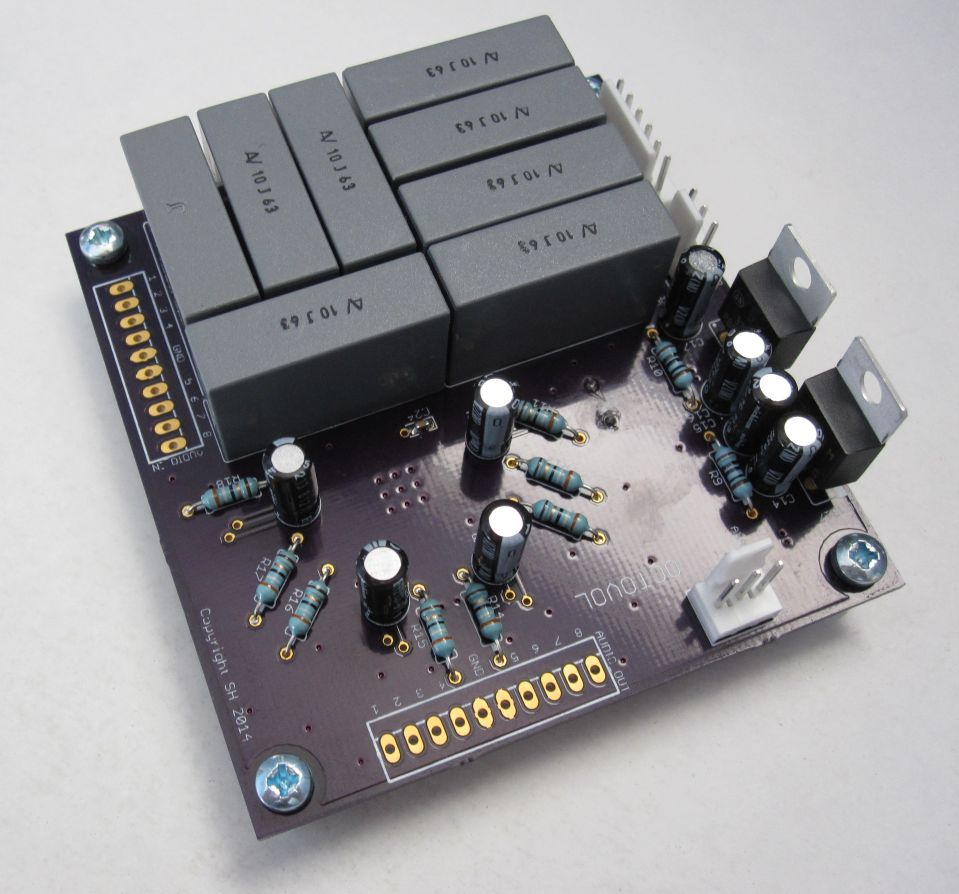

The boards arrived on Thursday, I've since had time to assemble mine
Board quality appears very good, I pushed the limit of the silkscreen at points but all the designators are legible. Nice gold finish on the pads, solderability was great all round, no thermal issues with this design either. Through hole plating seems consistent.
I assembled the board partly at a re-work bench but left the through hole parts to do at home. That was a mistake, I should have done all of the soldering at the re-work bench as my Antec iron is a bit too clumsy for these pads! It should work fine anyhow but I recommend using the best equipment you can. Soldering the CS3318 was no problem at all, the ground area beneath it doesn't draw heat away in any noticeable way, you won't have a problem if you have good magnification and a fine gauge solder.
I wish I had ordered 10-way Molex instead of 12-way, not sure how I managed that . I also forgot R19 but it isn't critical. I'll see about writing some basic software to drive this, just using a pot and the master channel volume register at first I think. Then the design can be validated

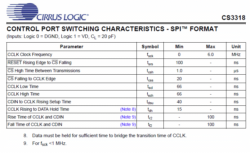

Well I can at least confirm the PCB works! I'm still having software issues but this code will get the Cirrus to pass a signal on all channels. Unity gain as it is supposed to be, no obvious crosstalk or noise, I'm currently only looking on the scope though.
Those delays really do need to be 2ms, even adjusting to 1ms the system stops working. I really don't know why that is, the Cirrus and isolator are much faster than this
That isn't the only issue though, I still haven't got the code to work using a pot as input. I have been using LEDs on the 3 SPI wires, trying the code in slow motion etc, it appears to send the data out correctly when you move the pot. The master register did accept a single adjustment to +10dB though, I simply programmed in that static change after 5 seconds of power up and saw the signal clearly raise up.
So, still some work to do, but no issues with the PCB it seems!

Mostly I think it is the delays which are a problem, and any possible cause which may affect data integrity like overshoot and ringing. Nowhere in the datasheets was the advice to add terminations and I never planned to run the control port much beyond 100kHz anyhow, if that, but it should be faster than it is running at now. The PIC is on breadboard too, though I've ran this same code from breadboard with 300uS or lower delays. I attach the timings from the datasheets and will see about getting the SPI clock on a loop so I can view it on my analogue scope.

Are you sure it's a timing issue? FWIW, I've never had any timing issues with SPI devices (but I'm using Arduino), my code is always something like this:
Also, have you read this?
