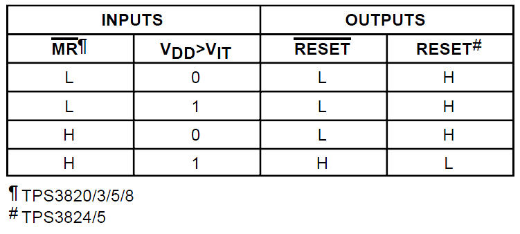

For the digital rail watchdog, a TPS3823 appears suitable. The Master Reset can be forwarded on to the control header, via the level shifter, to give conventional functionality. This just provides the guarantee that the device will enter reset when the digital rail is removed (drops below 2.93V).

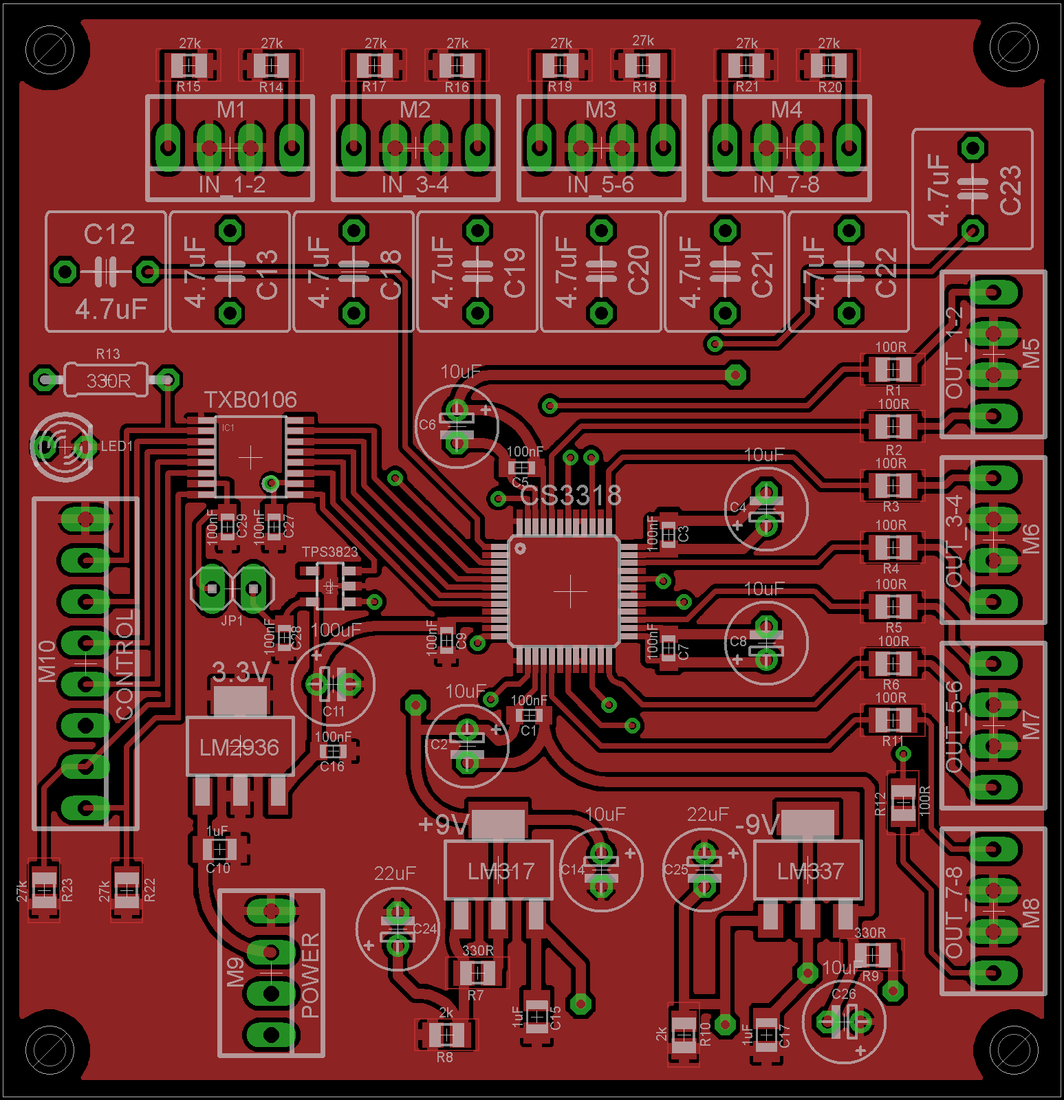

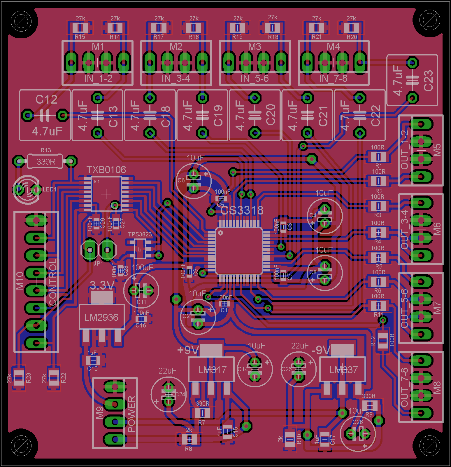

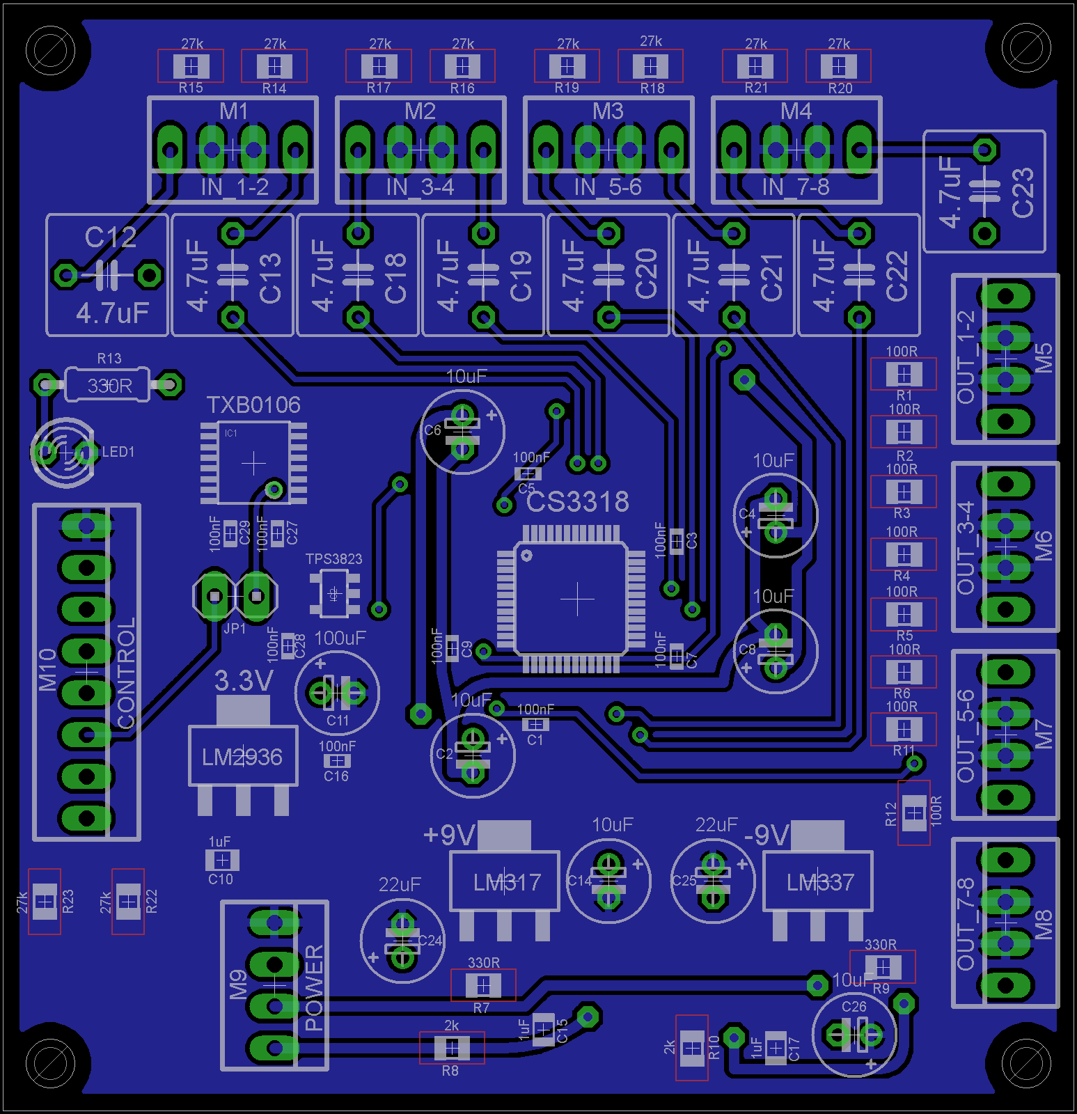

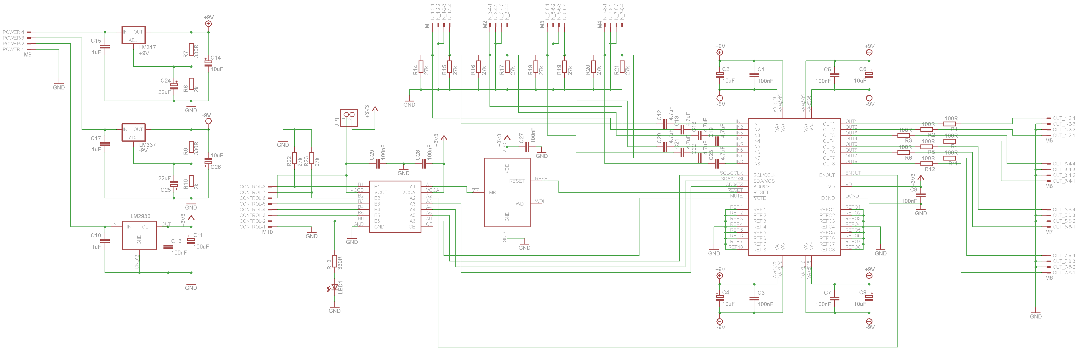

Hey all, here is revision 2! This now has:
The possible limitation is lack of I2C control, since the pull-up resistors can't be used with this level converter, unless it is acceptable to place them between the converter and the CS3318? I was certainly planning to use SPI myself, I can't imagine being too concerned with requiring an extra microcontroller I/O pin in DIY applications. I've only seen discrete MOSFET solutions to I2C level conversion and that makes for a whole lot of part placement+soldering when 6 channels of data are involved.
Any feedback appreciated!
- Molex 4-pin input and output headers (stereo with dual ground). A good combination of flexibility and sturdiness (the 2-pin type are a bit flimsy) I hope.
- Level conversion from 5V to 3.3V, or can be unused by placing the jumper (for direct 3.3V control). Additionally, the ENout pin now forwards to the header at whatever interface voltage is being used. An LED also shows when the chip is out of reset condition.
- A watchdog IC ensures the device is held in reset if the digital supply falls below 3V. Observe the truth table; the 3.3V power must be present and stable and !MR must be high for the device to come out of reset:
- Discharge resistors on the inputs to eliminate connection/disconnect pops.
- Reset and Mute are connected with pull-down resistors at the control header, as advised the Mute should be else if it is not connected back at the microprocessor it can cause issues, and for Reset this ensures the default condition is to be in reset.
Haven't done a detailed check but in general I think it looks very good 🙂
Two questions: How big is the board and what sizes are the SMDs?
/U.
/U.
Thanks! It's actually very tiny, 67x65mm! The packages are:
CS3318 is 48 pin LQFP, 0.5mm pin spacing
TXB0106 is 16 pin TSSOP, 0.65mm pin spacing
Watchdog is SOT23-5
Voltage regs all SOT223
0805 SMD Resistors
0605 and 0805 SMD Capacitors
Watchdog is SOT23-5
0805 SMD Resistors
