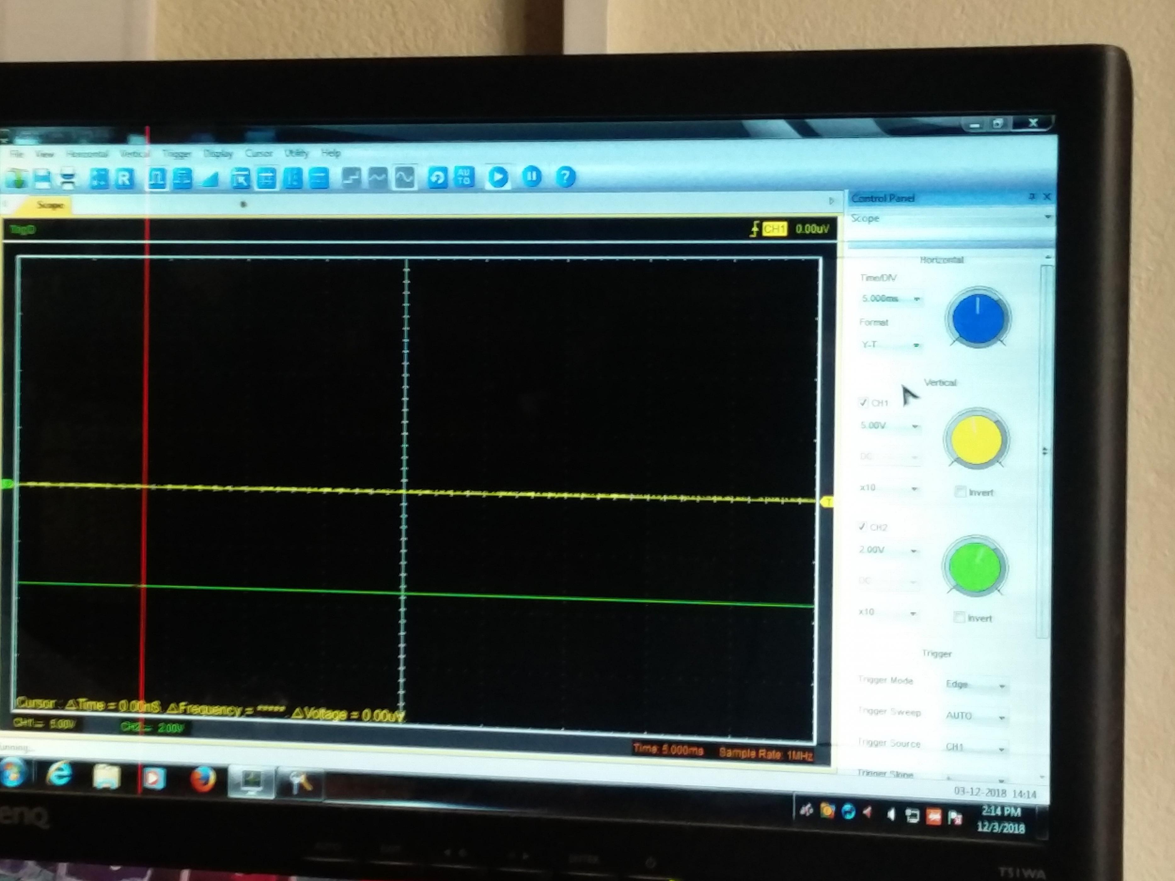

No audio output, no square wave on Pin7 of the LM211(defaced IC). I am posting a pic of the scope screen of Pin7 output with a 1khz signal input. Setting is 50.0ms/10v.div

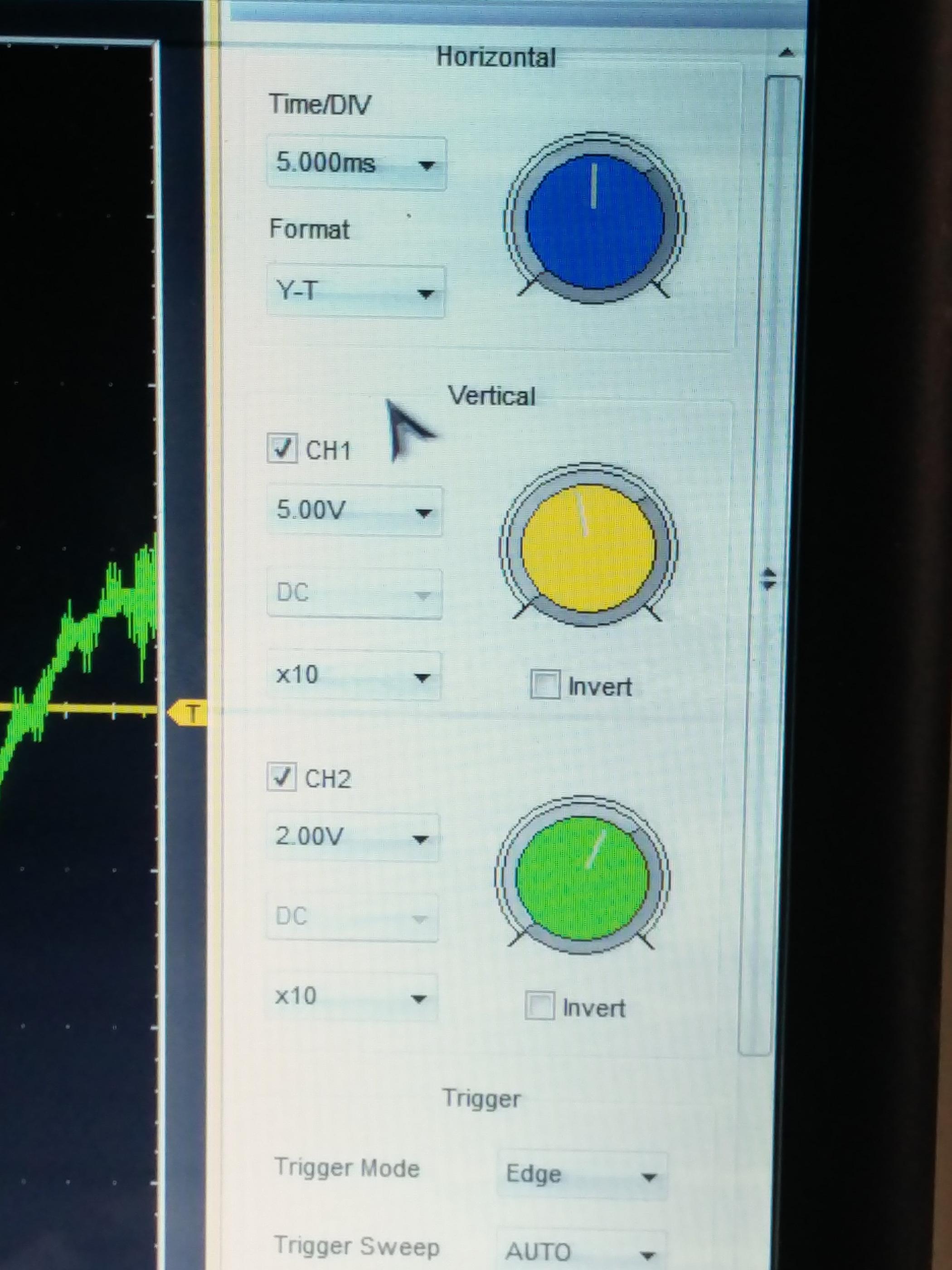

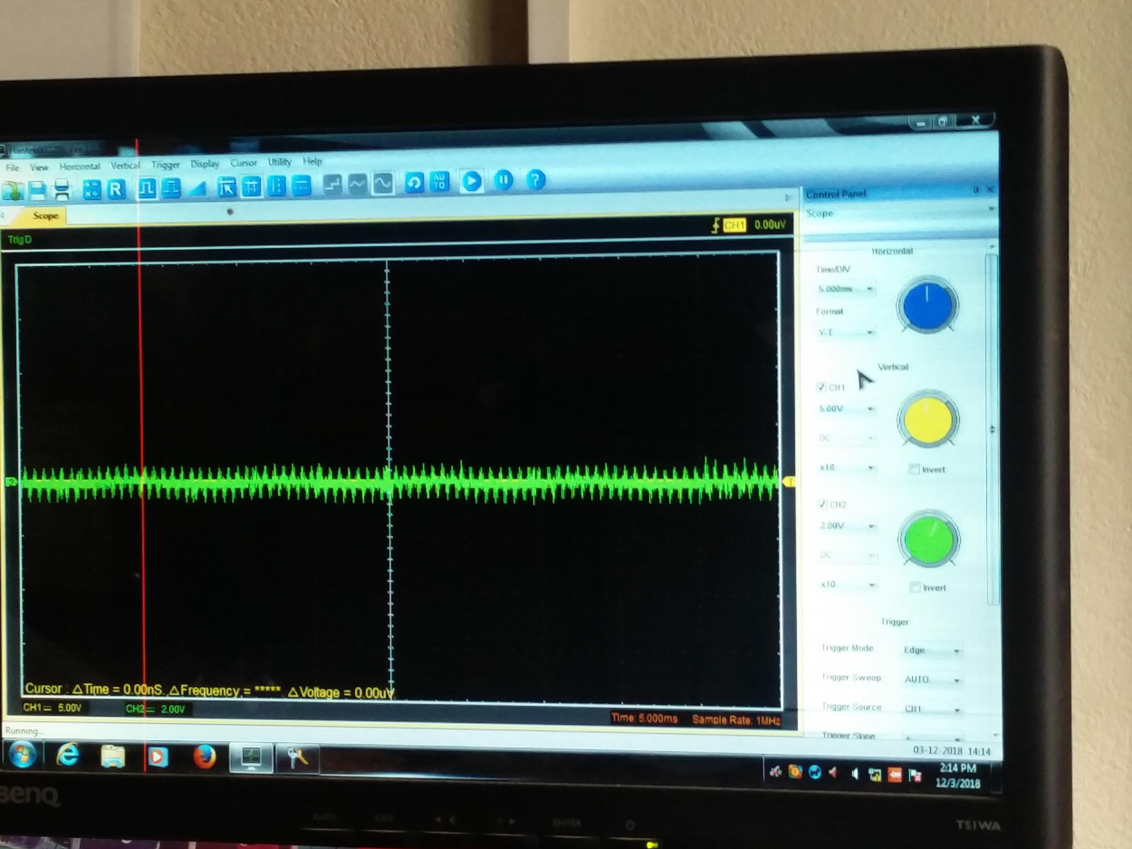

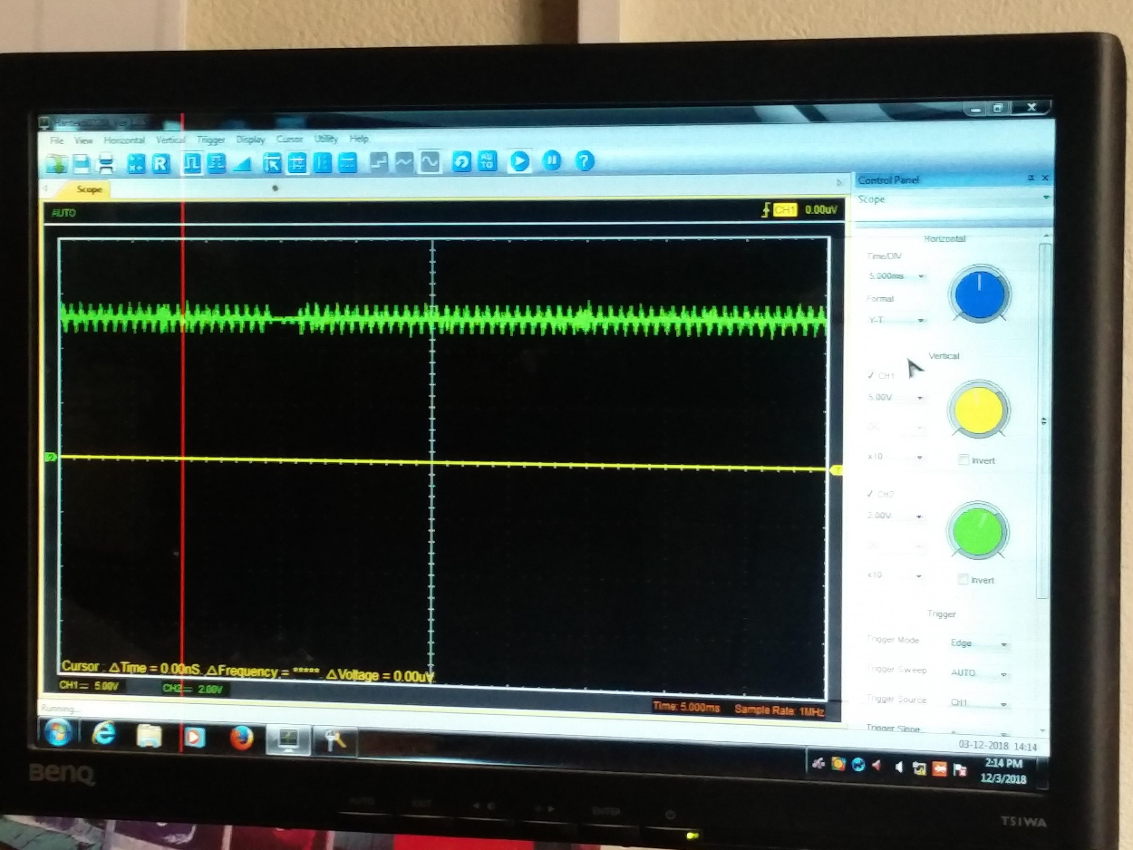

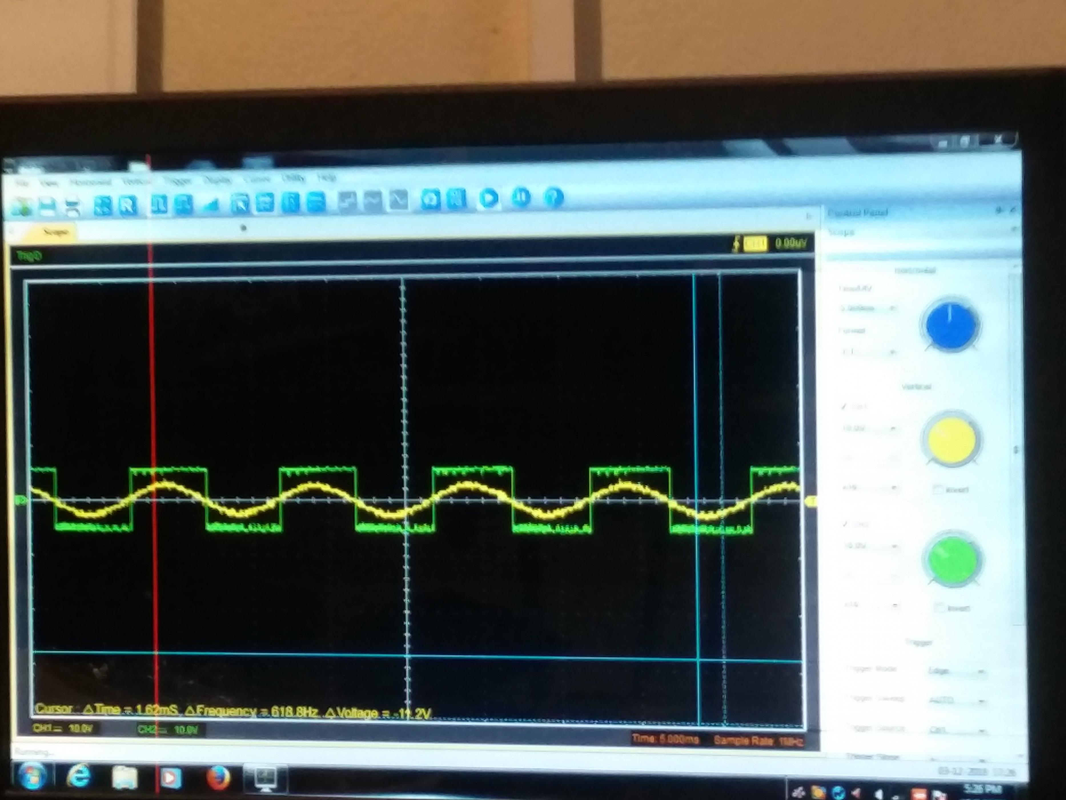

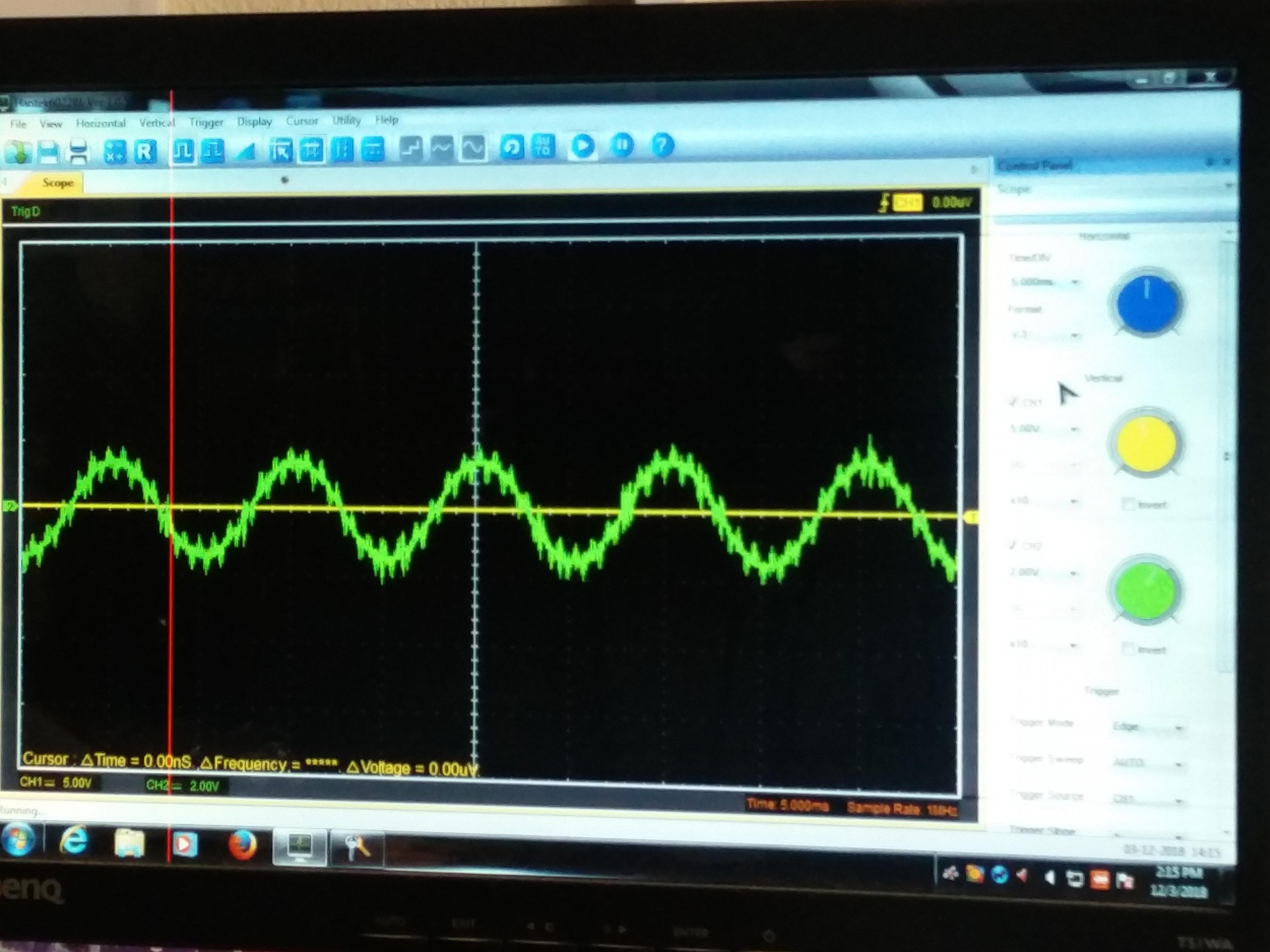

The following screen shots are with pin2 jumped to pin3 of the IR21844, with a 10k resistor soldered from Pin1 to Pin2 of the TL072, and a 100hz sine wave input into the amp. The setting for all of these was 5.0ms / 2.0v.
Pic 1 is scope settings
Pic 2 is 100hz input at rca connector
Pic 3 is pin1 of TL072 (or is pin7 the output to check?)
Pic 4 is pin7 of LM211(U3)
Pic 5 is Pin1 of IR21844

There is a missing image. With no corresponding file name to pis#, I don't know which is missing.

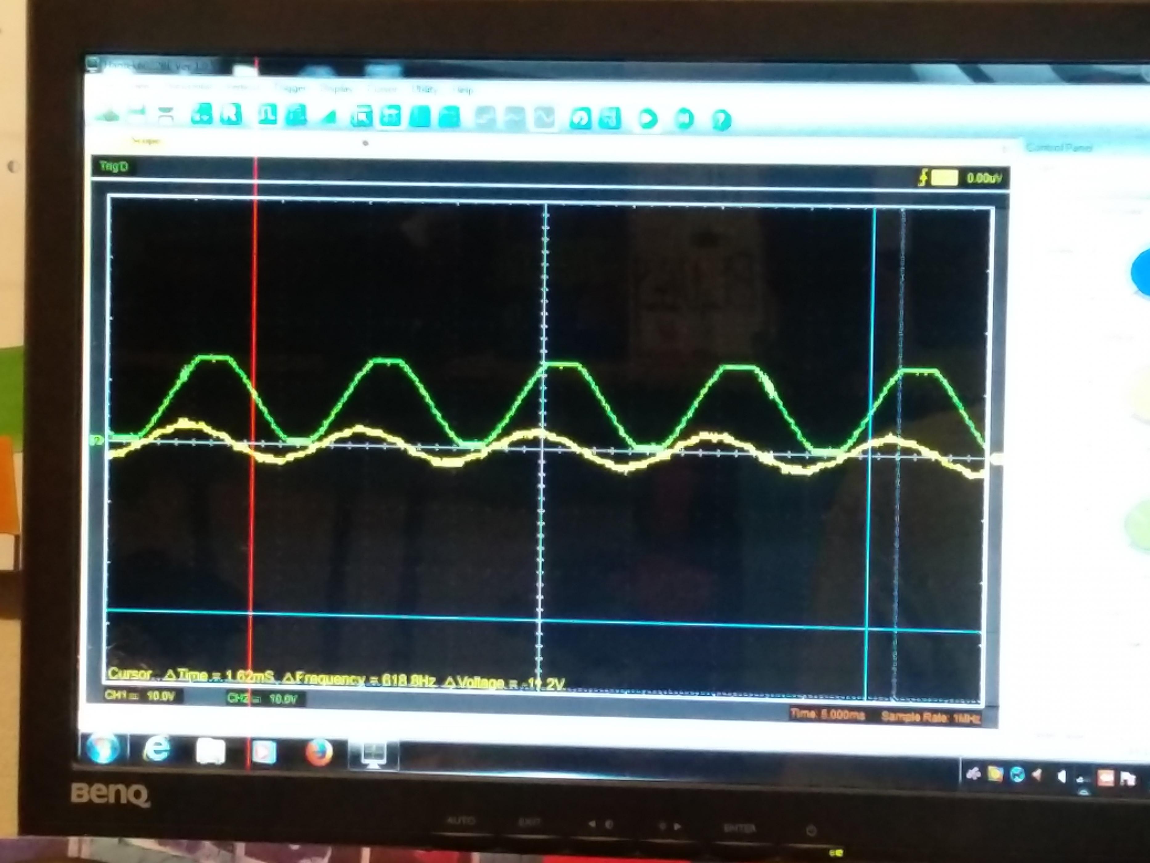

Drive a stronger signal into the amp so that the output of the TL072 is just before it's clipping.
Input is clipping. Had deck volume maxed out trying to get the TL072 close to clipping. Yes, have square wave from LM211 now.
Do you now have a square wave of about 10v, (referenced to the negative rail) on pin of the 21844?
Setting the gain higher, the crossover higher or the subsonic filter lower may have helped you to get a stronger signal at the TL072. For future reference.
