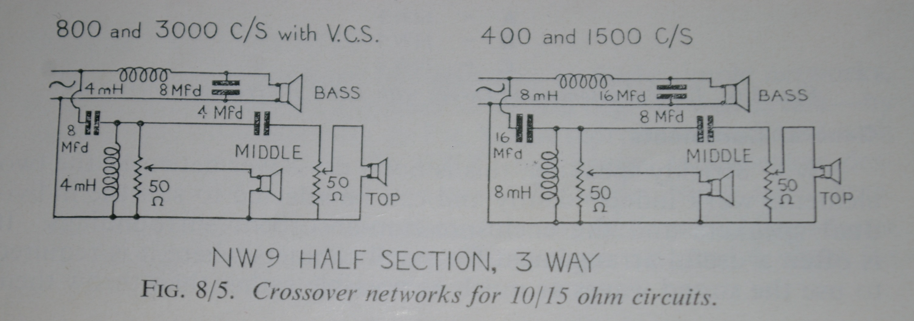

--- 1. Question - What I don't understand is why that crossover would work for the Wharfedale 8 inch Midrange, don't crossovers have to be specific to a driver ?? and Also what other drivers are in that crossover , and doesn't each crossover have to match the frequencys that the other drivers are crossing over at???
- Hi topping , this is very confusing you never did answer my # 1. Question above --
I dont have the schematic for the crossover that was installed in a w70 that i had 12years ago, even if i did that is not how id construct one now.

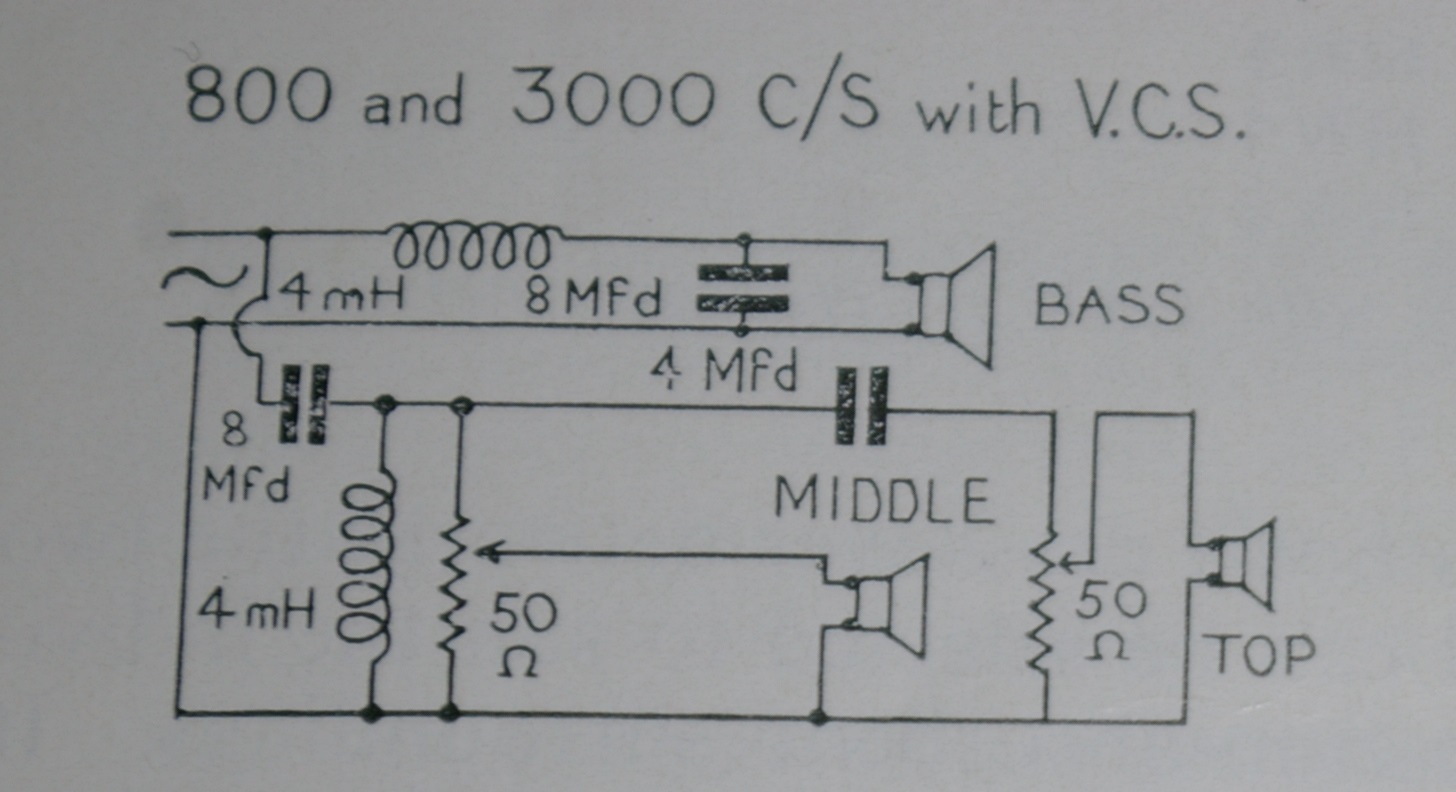

Note how the tweeter circuit is taken off the midrange filter circuit, and not taken directly off the input.
- Hi Galu , Yes that is helpful! - It's also intresting to see what the designers there at wharfedale were thinking. Do you know what year this was? --- or which speaker they used them in ?
- Each of the xovers has an extra cap and an extra coil compared to mine - so maybe they are just a few years further along from mine . . .
- as Wharfedale learned or understood more then of coarse they implimented those ideas in the newer versions. It's easy to forget they didn't have many of the tools we use today to measure and design with.
--- My W70's had a 4 mfd/uF , and an 18 mfd/uF , a single coil and of coarse the two 50 ohm L-Pads , I will try to draw mine out later today just like they did it here. They are Strange looking xovers..... at least to me - 😀

These are generic crossovers and the images are taken from G.A. Briggs' book 'More About Loudspeakers', first published in 1963.Do you know what year this was? --- or which speaker they used them in ?

However, the same basic circuit appeared in the 5th edition of his earlier book entitled 'Loudspeakers' which was published in 1958.

At their heart they are just 2-Way Second Order crossovers as per the attachment.They are Strange looking xovers..... at least to me - 😀
The Wharfedale mid driver occupies the tweeter position of the attached diagram, while the Wharfedale tweeter is simply connected in parallel with the mid driver's inductor via a 4μF capacitor.
- Thanks, that drawing makes a little more sense ........ so just talking out loud the tweeter is just seeing the cap and the inductor right, same as the midrange is... but the mid driver has the parts in opposite places than the tweeter. so is one a high pass and one a low pass?

The original crossovers in your W70s were 1st Order (6dB/octave)! If you want them to remain 1st order, then all you have to do is upgrade the 4μF and 18μF capacitors that were originally on your drivers! The single coil you mentioned should not require to be upgraded.Someone that has a little experience with Wharfedale speakers said that they think that the drivers in my speaker would work better with a First order crossover
It would appear that you need to bone up on crossovers, Dean! 😉
The generic crossover I attached is 2nd Order (12dB/octave) so permits less overlap between the drivers. The original 1st Order (6dB/octave) crossover allows greater overlap between the drivers.
The choice of a 1st Order crossover in the W70 was made either to save money (fewer components) or to 'splash' the sound around more!
The generic crossover is low pass on the woofer and high pass on the mid. The tweeter operates off the high pass section, but is further filtered by the 4μF capacitor.so is one a high pass and one a low pass?

Assuming 15Ω impedance, I've calculated that the generic 2nd order crossover shown in the attachment would be a direct replacement for the original 1st order crossover of the W70.Are the drivers all 15Ω impedance?
These are the two options I suggest you consider:
- Simply upgrade the capacitors in the original 1st order crossover.
- Upgrade to the 2nd order crossover shown the attachment.
P.S. The original coils on your W70s should be 4mH. So, if you proceed with option 2, you already have two coils to start with and would only need to buy two more having the same type of construction as the originals.
