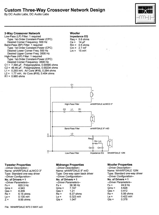

Crossovers and which Inductor is right?
- Anyone have an opinion on which which crossover is the one they would try?
Let's look at the two crossover suggestions side by side. Nope, looks like six and half a dozen to me!
However, you already know my opinion - go minimalist, as Wharfedale did! ;)

DIY is like this. The answers to some of your questions may already be known. Your crossover suggestions are coming without knowing why they will make a difference.
For example, consider a woofer that performs best under a certain frequency. What frequencies can and can't be used, how far should the top be cut, how should it be done to keep the overall result smooth.
--------------------- Hi Allen , yes I do kinda understand that , but I hoped to get lucky and either find someone who had experience with the Speaker/crossover , or find a speaker Guru that could give some of the answers I was looking for ... I know that some of the question are, try it and see. But I did get some of my main questions about the crossover parts answered - and that will Help a Lot!
It's not for want of trying, it's very difficult to guess. This is also a complex baffle arrangement.
Four options..
Someone who has a set and has learned the driver acoustics and found a good cross.
Someone who knows an old thread where this happened.
Get a microphone and equalise what you see until you like it sufficiently *
Measure and cross to your own level of satisfaction.
* In addition to this, you can post your equaliser result here and driver impedance curves and we can back-convert it to passive.

You may want to get an LCR meter and measure the value of each component of the original crossover, that way you can pretty much reproduce it with new components (while you're at it measure the new values too). Older components had tolerances of +/- 10 or 20% (unless they happened to have been selected or matched between speaker pairs) and in addition those values may have changed over time, so two "identical" speakers could sound slightly different, not even counting variations in drivers.
- Hi Galu, I have been thinking for awhile about the aspect that you mentioned about keeping the Wharfedale W70's as close to stock as possible for their historical value and for resale . . . . For the crossover it would be easy to make two crossover boards one that uses the original component values but new parts, and then the second board with the new modern style crossover. To simplify things a little both would have their own wiring harness too , that way the customer/buyer could have the option of which crossover he would like to use and it would be just a few solder connections and your choice is up and running, after I find out the buyers preference I would solder it in... I could also include both in the sale -- :) --
