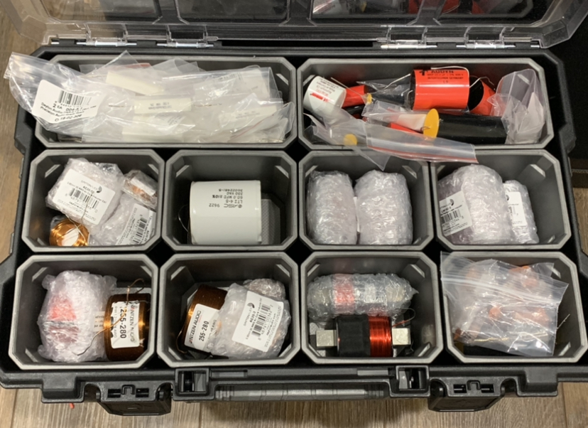

You can eliminate the expensive L-pads for purposes of testing. Get an assortment of the Dayton Audio grade 10w white cement resistors. They are about $0.7ea and sound fine for 98% of speaker duties. Get several (4) of each value like 0.51R, 1R, 2R, 3.3R, 4.7R, 6.8R, 10R, 20R. You should be able to make any value you want to adjust the padding. It will sound better than an Lpad too. Use something like Wago quick connectors to make and swap connections.
For $200, I made myself essentially a complete XO development kit from inductors, caps, and resistors from PE’s inventory. My inductors range from 10mH (iron core) to 4mH air core down to 0.1mH all air core in nice increments and multiple ones of certain values to build any value I could reasonably need. Same with caps - I have film caps as large as 38uF, and down to 0.47uF. Multiple values of 1uF, lots of 2.2uF, 3.3uF, 4.7uF, lots of 5uF, 10uF, 22uF, 33uF, etc. a few 50uF BP’s , and big fat 60uF I got from Vunce as a gift. I also have a few 50uF motor run caps (not shown). And the R’s I already mentioned.
Now with this kit, I have been able to tackle 5 different custom crossover designs from scratch. That is, once I have the rough design in Xsim, I can immediately prototype the actual one from this $200 kit in minutes. No waiting for the parts to arrive, no wondering which part sounds better. I can hear it and measure right away. Make changes in real time and re-measure. It’s awesome.
Once I am happy, I order dedicated (possibly higher quality parts of needed) and return the items used for development back to their case for the next project.

Here is the XO Dev Kit:
attachment.php

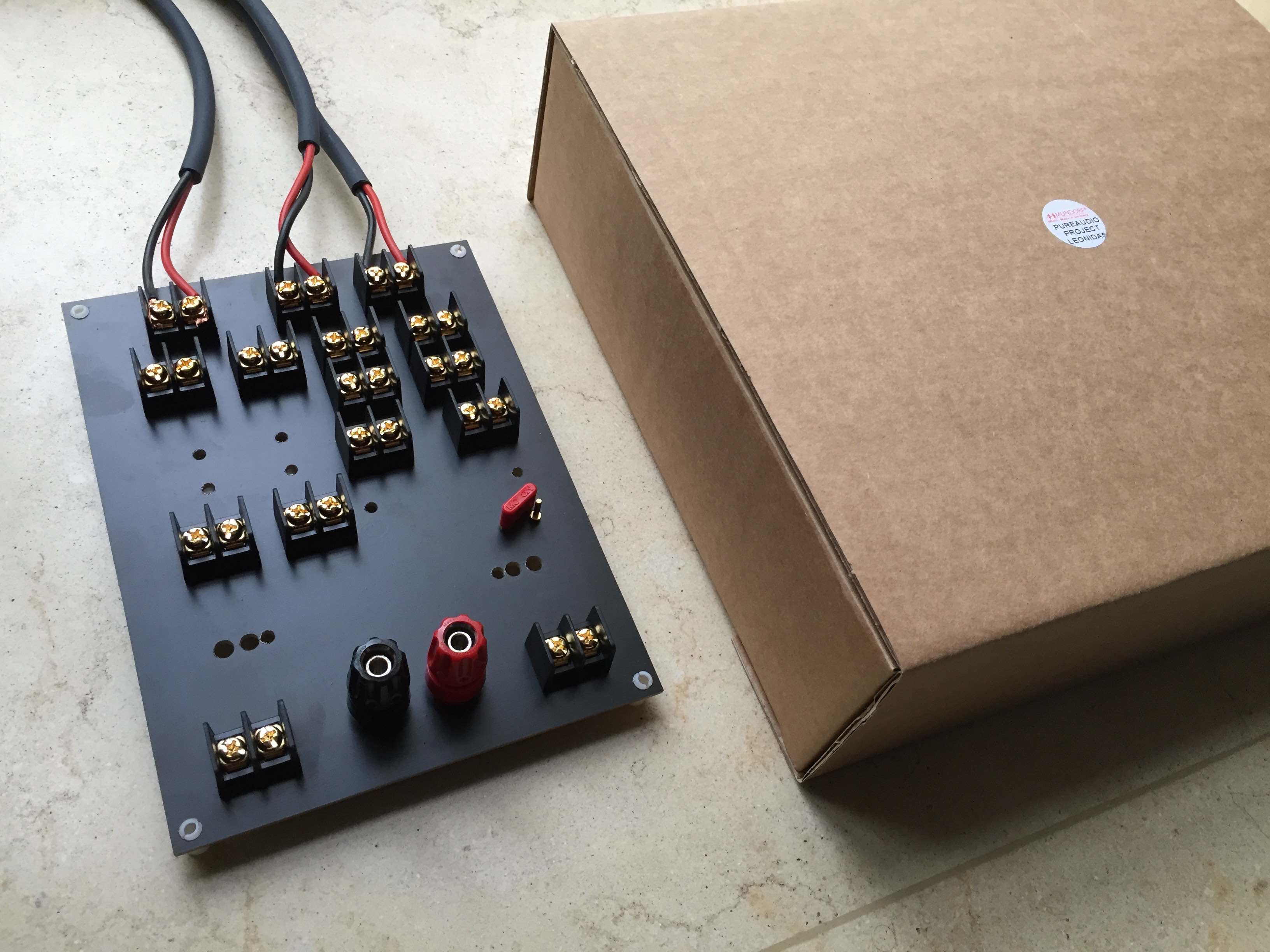

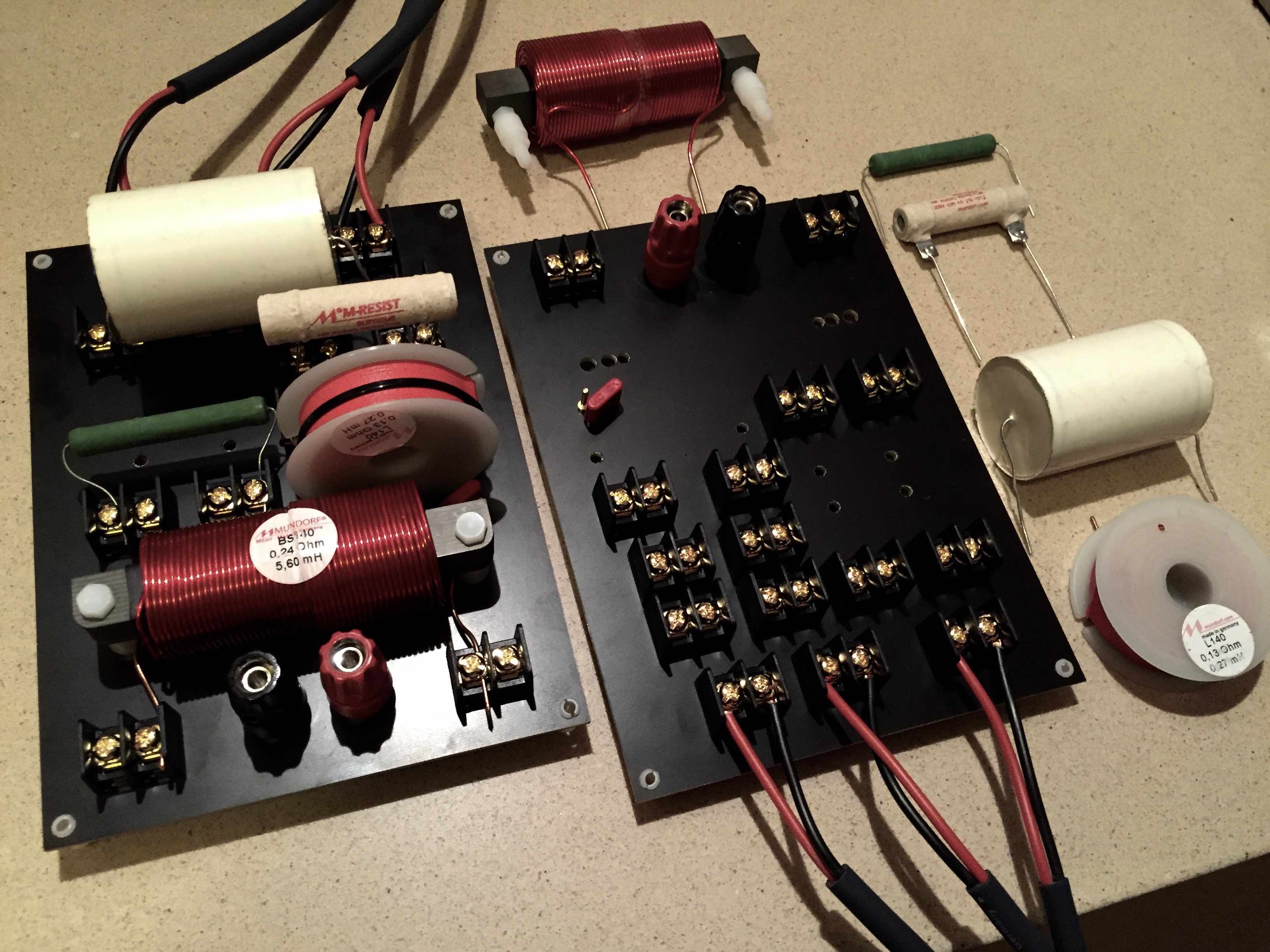

- You know what would be Really Nice and that would sound better - and make the crossover variable for the Resale is to set up the Midrange and Tweeter crossover with the same kind of simple Board design that Pure Audio Project is using , where they can just swap out components by using Screw terminals - - -
-- I'm not sure how to do the Layout for the Boards - Sure would be Nice though!!!
"We have then designed a unique Circuit Board with gold plated screw terminals that all components are mounted on. This audiophile-grade circuit board is made by Mundorf in Germany.
This tool-less swapping of components allows customers to carefully voice the crossover to the specific listening environment, the sonic signature of their equipment, and their personal sonic taste."

I guess I could make two crossover boards, one with the L-Pads , and one with the resister set up for me after I try and figure out which resisters to use ...
- or a switch to engage either the L-Pads or the Resisters ........
If you looked at my link L-PADS you will have observed that an L-Pad consists of two resistors. The fact that the two resistors are variable is a distinct advantage in your case - no calculations and no experimenting with fixed resistor values. I'm afraid that I do not see the logic in switching between fixed resistors and a good quality L-Pad in the context of your vintage W70 speakers..
