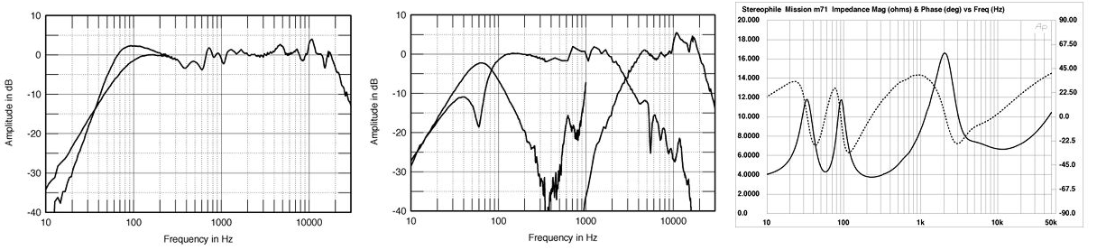

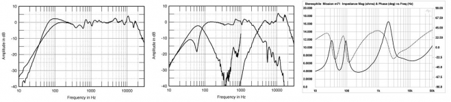

The speaker appears to be the Mission M71 model and this is stated to have an average sensitivity of 88db for one watt at one meter.If your mic measurement is accurate then there is a problem with the speakers which could be caused by incorrect xover wiring or a faulty component.An impedance curve is often useful in cases like this as it can show up failures such as shorted turns in a voice coil that a visual inspection could miss.
If it hold M71 is the model here link to "stereophile" review and measurement Mission m71 loudspeaker Measurements | Stereophile.com.
