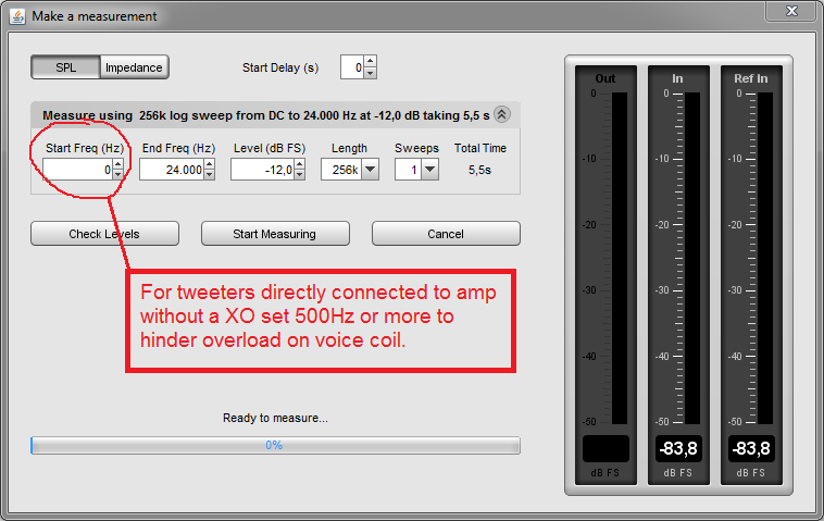

Think sounds weird how this happen. Forgive me if wrong but to end up a broken tweeter after a sweep with REW, it sounds as you probably connect tweeter directly to amp without a high pass XO (use example a 10uF cap as bwaslo suggest in post 61) and then run a impulse train sweep from DC to end frq , if one test tweeters without XO set sweep to a higher start frq than DC, see below.

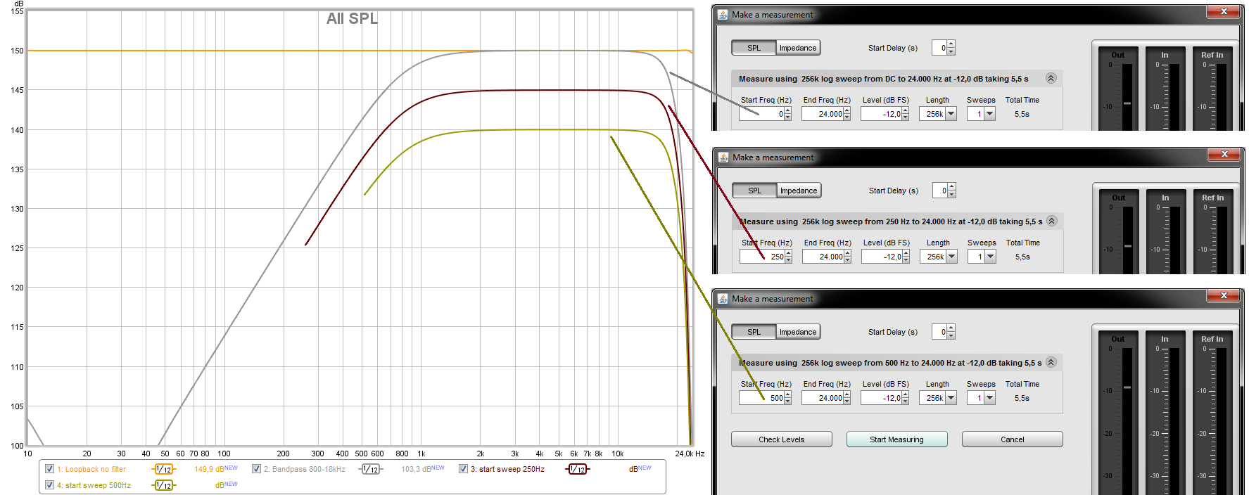

Its fine if you feel most safe using a capasitor for the test, but actual you can spare the money by setting start frq into REW before doing the sweep as shown below. The plot show my DSP engine set to a loop via my soundcard where REW listen in the chain, then a filter is set to replicate a typical plot for a tweeter bandpass 800-18kHz. Grey trace show "Make a measurement" dialog meny have set start frq sweep from down 0Hz and up and therfor in plot one can see the frq energy fade out down at -50dB around 46Hz, but look at brown and gold traced where start frq is set to respective 250Hz and 500Hz you see the sweep send no energy to the driver below that frq point and thereby you can spare your money for the capacitor. Actual its possible to play a music track to a tweeter without XO and without destroying tweeter but it needs to be at very low SPL. If you fear hurting tweeter then set REW start frq to 1000Hz before the sweep and you really safe.

The test is so short think if you have only eletrolytics laying around it doesn't matter nothing will explode in so short a time. Besides do you know you can wire a electrolytic back to back, example two 22uF in series (-/+ wire +/-) replicate a bipolar 11uF.
Hope and look forward see if tweeter can show a broader bandwidth than we seen when feeded from XO network.

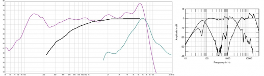

Just got my capacitors to test my mission tweeter and woofer separately. I test both the tweeter and woofer still mounted on the cabinet of the speaker. I hooked them up individually 1 at time for the test. Test was at 0.5 m on axis with tweeter. Amplifier volume kept the same for both woofer and tweeter. Position of mic did not shift for both woofer and tweeter test. These were my results. Mic not sensitive beyond 6Khz.
Woofer
Tweeter
Combined into one graph

The microphone is not defective. Its just not sensitive beyond 6Khz. For my use, I am just bothered about the huge dip in frequency response at the 2.8Khz. I don't know y there is such a huge dip of 10 to 12 dB at the crossover frequency. If u see post #48 where I measured both the tweeter and woofer individually with the crossover attached I had the dip in freq. But if I measured just the woofer here without the crossover there, is no dip in freq.
In the meantime I am still trying to get another mic for the higher frequencies. When I was running the freq sweep I can hear the tweeter. Its just much lower in loudness than the woofer.
Hi Buzzy it doesn't look good and points to what bwaslo described at post 61 that drivers are defect. A guess is tweeter should have looked ala below black trace up to 6kHz point where microphone falls off but it didn't, even if capasitor had too low a value it would have been a softer raising high pass slope and guess also you used a 10uF as bwaslo recommended.

I used 22uF capacitor. The woofer is still usable ?

Okay that is good for the test but sorry because tweeter is not alright then.
Have you had a party or so where they been running close at distortion level for longer times you can remember is the reason for it.
Hope it's possible to get the spare part somewhere new or used or even just get the voice coil so XO components don't need to be retuned.
If the voicecoil is stuck can it be repaired ?
Don't think so, had sometimes repaired tweeters that had got a shock from crazy high wattage overload input, they often burn copper wire outside the coil enroute to soldering terminal and is repairable with some patience when repairing. But in that case their error sign is they say nothing at all after the overload shock, where yours have probably cooked lacquer on copper wire where its coiled up and that boiled lacquer is now stuck in gap hindering voice coil free movement.
Nowadays you can probably get some very cheap very good tweeters from other brands that can do the job but you will then need microphone support that is okay to tweak XO component values for new different tweeter type.
If faceplate on tweeter is possible to remove you could do that and inspect voice coil health, maybe upload a picture of how it looks.
