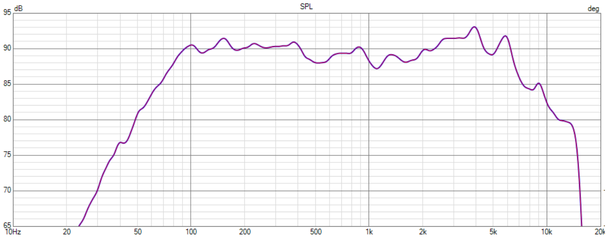

Here is the midranger curve and response
It's the only thing I have with this image quality. I apologize for that, please.

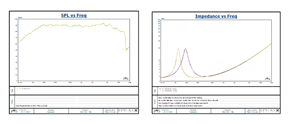

The Aiyima (full range) driver is available in both 4 ohm and 8 ohm versions. Please confirm that you have the 4 ohm version.
Unfortunately, the numerical scales on the SPL vs Freq graph below are indistinct.

I put those graphs into Word and blew them up to 200%; the SPL is 0 at the bottom, 100 at the top; impedance 'hump' is at about 20 ohms and 500Hz, assuming the green line is the 4 ohm version..
The impedance graph shows how "4 ohm" drivers aren't 4 ohms all the time.

Yes, it was even a challenge for frequency and I had to rely on the 1 2 5 10 spacing to work it out.
I'm confused by the "500Hz" because this so-called 'mid' driver is actually a full range driver with a quoted resonance frequency of 94 Hz.

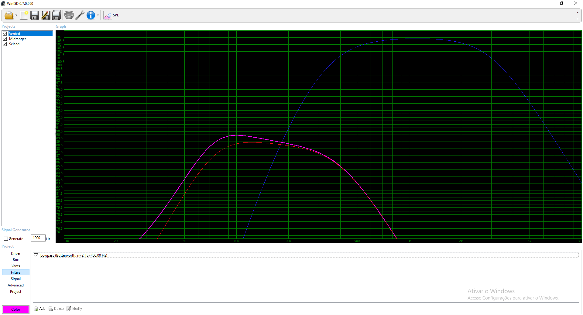

How did you get this graph? Very interesting.
the woofer box will be 30 liters and the midranger box will be 3 litersI put those graphs into Word and blew them up to 200%; the SPL is 0 at the bottom, 100 at the top; impedance 'hump' is at about 20 ohms and 500Hz, assuming the green line is the 4 ohm version..

I got a full range one because I couldn't find a softdome midranger anywhere.I'm confused by the "500Hz" because this so-called 'mid' driver is actually a full range driver with a quoted resonance frequency of 94 Hz.
The 'mid' driver has to operate between fL = 400 Hz and fH = 3200 Hz according to the presently intended crossover design.
I estimate from AllenB's graph that the 'mid' driver's SPL averages around 89 dB over that range.
I'm just going by the supplied graph and it's hard to read the numbers, so I could well be wrong; doesn't make sense to me eitherI'm confused by the "500Hz" because this so-called 'mid' driver is actually a full range driver with a quoted resonance frequency of 94 Hz.
