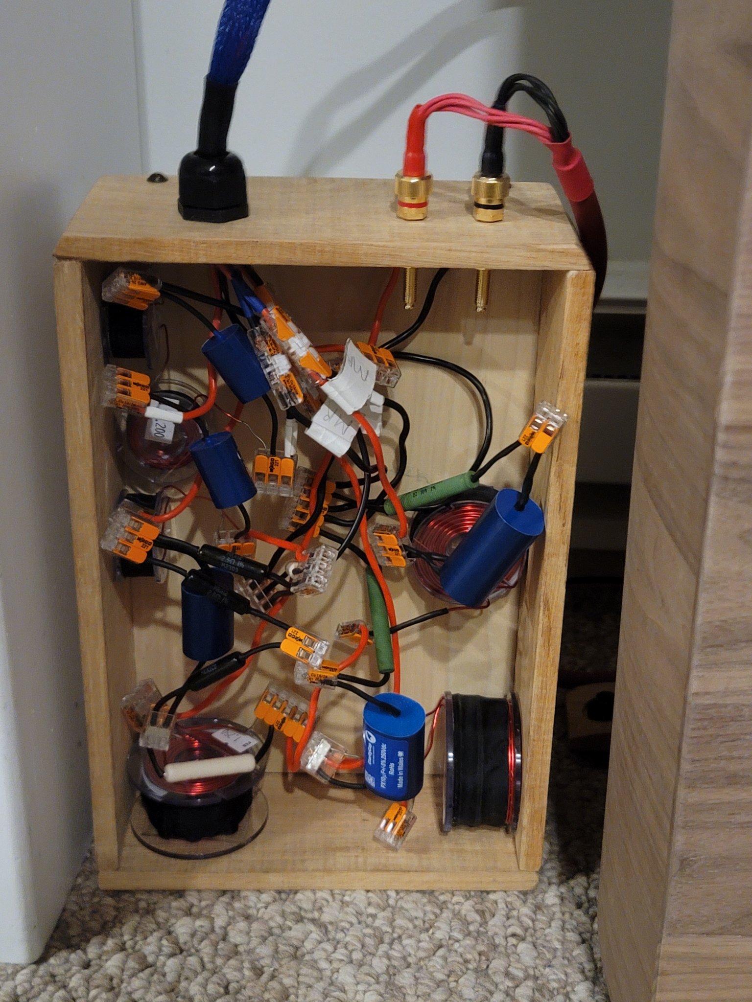

Your construction is good, but the inductors could usefully be further apart to prevent their magnetic fields interacting with each other.

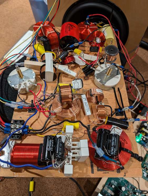

Here's a guide on orientating inductors in order to minimise their interaction:
In fact, it's working well, without many noise problems or anything like that.

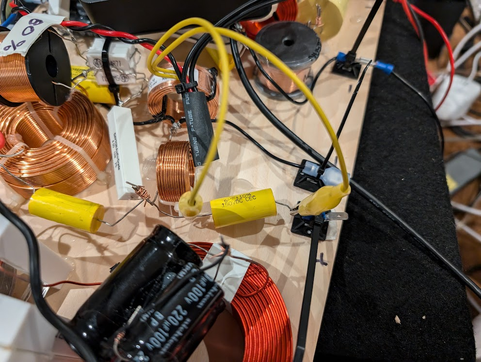

In post #76 it is clear that polarized caps (green-black) are wired in parallel and these are not forming a single non-polarized cap.
You should repair it asap.
