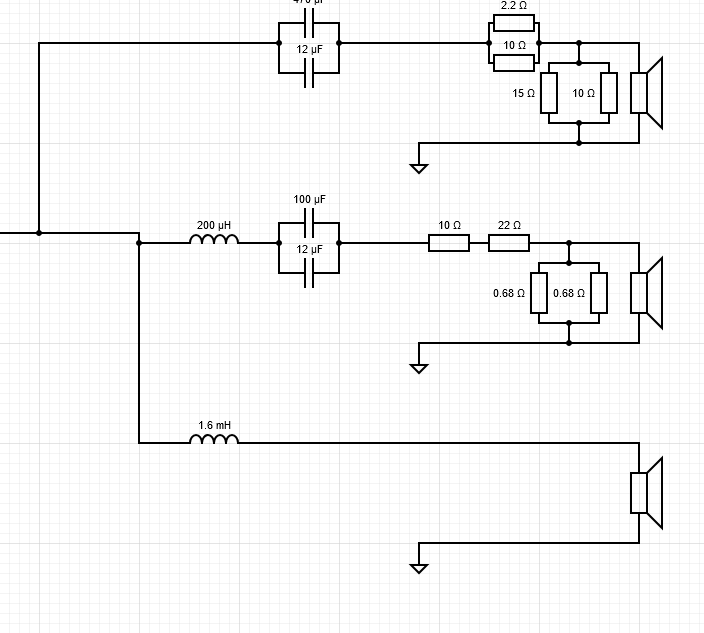

The frequencies have to be the same for each driver. Eg woofer to mid then mid to tweeter. Your tweeter should have 1.5 uF to 2.2 uF cap feeding it.
The embryonic crossover shown earlier assumes 4 ohm drivers with fL = 400 Hz and fH = 3200 Hz, using the fH = 8fL guidelines.
The Peerless DX25BG60-04 has a resonance frequency of 400 Hz.
3200 Hz is 3 octaves above 400 Hz. It was on that basis that a 12 uF capacitor was chosen.
Crude I know, but it was only intended to be a tutorial example and NOT a finalised crossover!

Let me assure you that by "noise" Geoff simply meant "sound".
Hopefully there will be no distortion.
I await your final assembly and test.
@GeoffMillar @Galu Thank you very much.About the resistors, can I really use those values? The ones I managed to make.
Hi, the tweeter and midrange are 4 ohm. They both have a L-pad with the serie / paralell resistors. The L-pad in the tweeter give you - 5.26db and the midrange L-pad live you -40.27db. So tweeter sensi @ 86.74db and mid sensi @ 47.73db.
The combinations of resistors on your 4 ohm tweeter L pad give Rs = 1.8 ohm and Rp = 6 ohm.
This will give around 4 dB of attenuation. (The standard resistors I would use for this would be 1.5 and 6.8 so you are not far off).
The mid driver may not require attenuation, so initially I suggest you do not put an L-pad on it.
@Sagen @Galu I turned on the midranger next to the woofer and it seems much louder (listening to them raw)
the woofer has a sensitivity of 87db
the midranger has a sensitivity of 88db
I need to review the sensitivity of the tweeter but I remember that it must be attenuated by 4.2db so that they all match the sensuality of the woofer.

Build the system. The enclosure will boost the bass. You can attenuate the mid afterwards if found necessary.
Changes are almost sure to be required, but you must have built your speaker system before you can judge which changes are necessary..
I believe your "mid" speaker is actually a full range driver. Above you give its specifications as:
Aiyima brand speaker
Impedance: 4 ohms/8 ohms ± 15%
Sensitivity: 88dB ± 3dB
Do you have a link to the full specifications of this driver?
