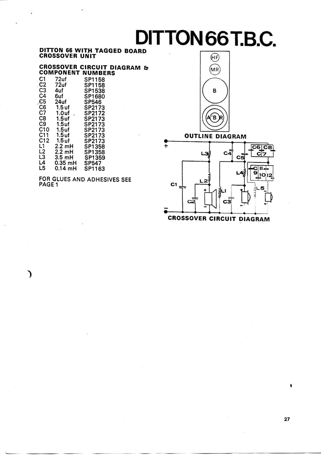

For the benefit of anyone who's interested, I've attached the schematic of the 44 crossover. I reverse-engineered this from a pair with cabinets date-stamped December 1976, all drivers with 'AK' date codes, corresponding with January 1977. I purchased these from the original owner, to the best of my knowledge they've never been apart (until I took them apart) and don't appear to have had any components replaced since manufacture.
A few notes...
Inductor DC resistance meaurements were taken with my 'Solartron 7150 plus' 6-digit bench DMM using the '4-wire' method to ensure accuracy and eliminate errors caused by test-lead resistance.
The inductors were measured by determining the resonant frequency of a parallel-resonant circuit consisting of the unknown inductor and a capacitor which measured 1.536 µF on my Beckman 'DM25L' DMM, then calculating the inductance. As I don't know how accurate this DMM is for capacitance measurements, I cannot guarantee absolute accuracy.
However, one (and only one) of the inductors; L5, Celestion part no. SP1163, is common to the 44 and 66 crossover. The 'Ditton 66 T.B.C.' schematic states that this is 0.14 mH. This broadly agrees with my measurements so it's (arguably) reasonable to assume the rest of the measurements aren't too far off.
The values on the diagram are 'best guess' based on measuring the components in both crossovers. The values weren't consistent, clearly there's some manufacturing tolerance (as well as possible measurement errors) but I'll list the calculated values for the inductors in each crossover, rounded to three digits.
I hope this is useful for someone; I've ended up working this out as I've never found a complete schematic for the 44 anywhere and thought I'd share my findings.
- L1: 2.10 mH and 2.08 mH
- L2: 2.09 mH and 2.10 mH
- L3, 3.28 mH and 3.16 mH
- L4, 0.653 mH and 0.661 mH
- L5, 0.139 mH and 0.140 mH
Regards, Kat
Kat, this is super helpful. Many thanks. I'm still getting over the shock of there being a woman on this forum, and more shocked that she's into electronics and hi-fi to a substantial extent! Lucas
So Alan,
I'd like to wind myself some inductors at some point. It would be nice to be able to reliably inform Ditton 44 users of a proven correct way to upgrade inductors to Ditton 66 levels.
I will need 4x 2.1mH for the midrange shunt inductors and for the bass series, and 2x 3.2mH for the bass series (Thanks to amazing Katherine for this).
The only question that remains is the thickness of the copper to be used and the dimensions of the spool to wind upon. For this, I think the best thing is to copy that of the 66s, which have similar but not identical values.
Could you, or indeed any Ditton 66 Mk1 owner let me know the copper thickness and spool size of the mid shunt and both bass inductors when you next delve into the crossover please...
Many thanks (and on behalf of all upgrading 44 owners in perpetuity!)
Lucas

Also, Alan...if copying 66s is not optimum, can you tell me about the best way to make my 2.1mH and 3.2mH inductors.
If buying a cheap inductance meter, hubs and wire is the same price as buying them off the shelf, I'll make them for sure.
