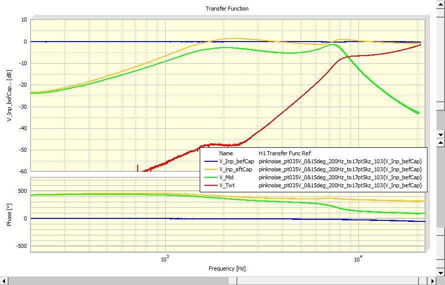

as stated earlier, the LR4 filter was added in front of the SL's first order filters. Main reason was that I had already soldered SL's cap and inductor and did not feel like vandalizing the setup to insert the LR4s after the cap. However the ripple below the Xover freq has been bugging me so I checked last weekend if moving the LR4 to after the cap would make for any significant difference.
This time I added another measurement point and measured both before and after the SL's cap and then after the LR4 outputs to the upper mid and the tweeter(s).
Here are the transfer functions referencing the input voltage before the SL's cap. The fundamental issue of phase drifting by 90deg up to the LR4 Xover and the joining ripple in mid freq gain stays unchanged. The bump right before the LR4 Xover got more pronounced and for this position the values would probably have to be tweaked a bit. (mind you these are dBs of Voltage attenuation and not sound).
The ripple is already there right after the SL's cap and before the LR4. I followed SL's recommendation to replicate the LR4 active filters, but I cannot help the feeling that for a passive solution an asymmetric filter would have performed better.

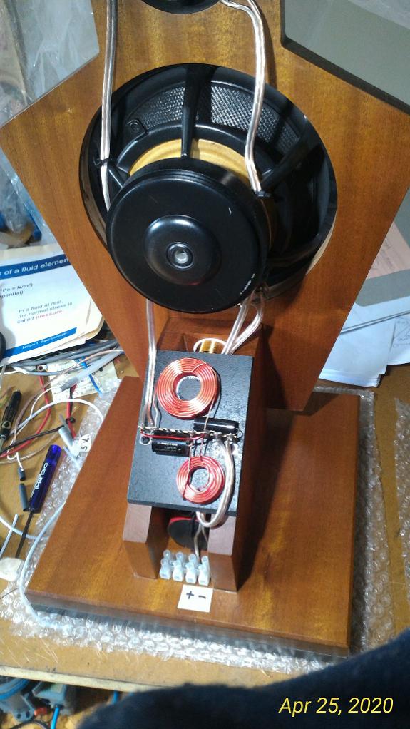

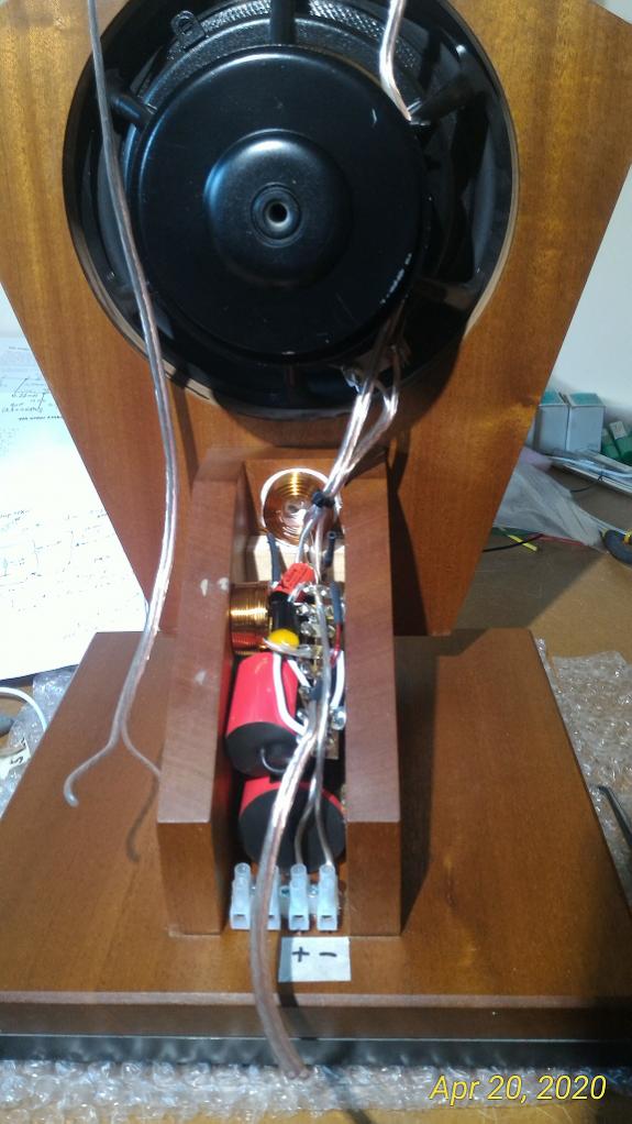

Finally put the passive XO together (values as posted before and the XO in front of SL's ind&cap). The upper mid LP packaged inside the base but the tweet HP had to come out on top of the cover 🙁.
Now I have to bring myself to take measurements again to make sure everything was soldered properly and then to EQ that ripple back to flat before adding SL's EQ (kind of a midbass boost?). Then follows the fun part :note: 🙂.

Great work - you’ve set yourself a challenge there working with those space constraints.

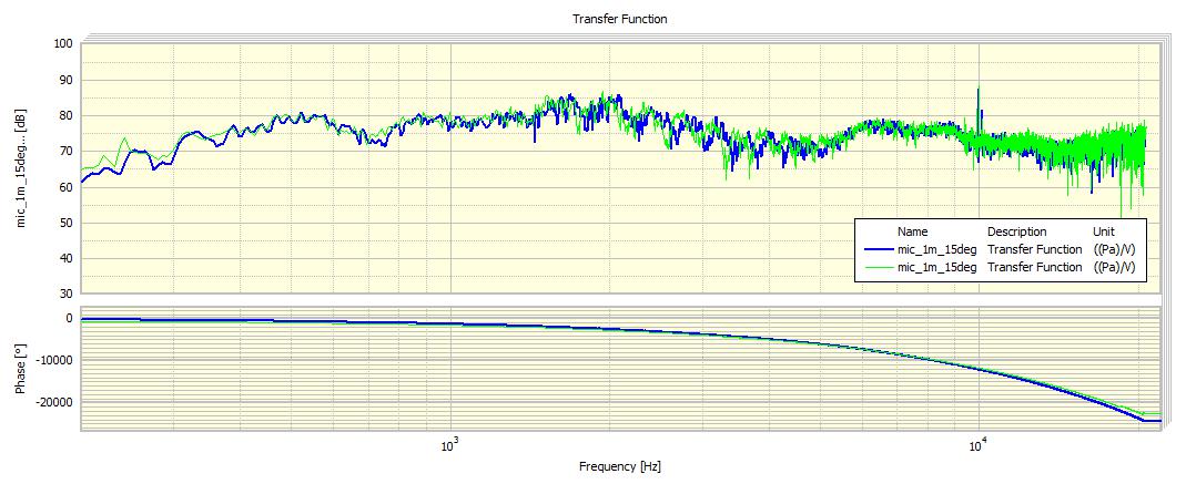

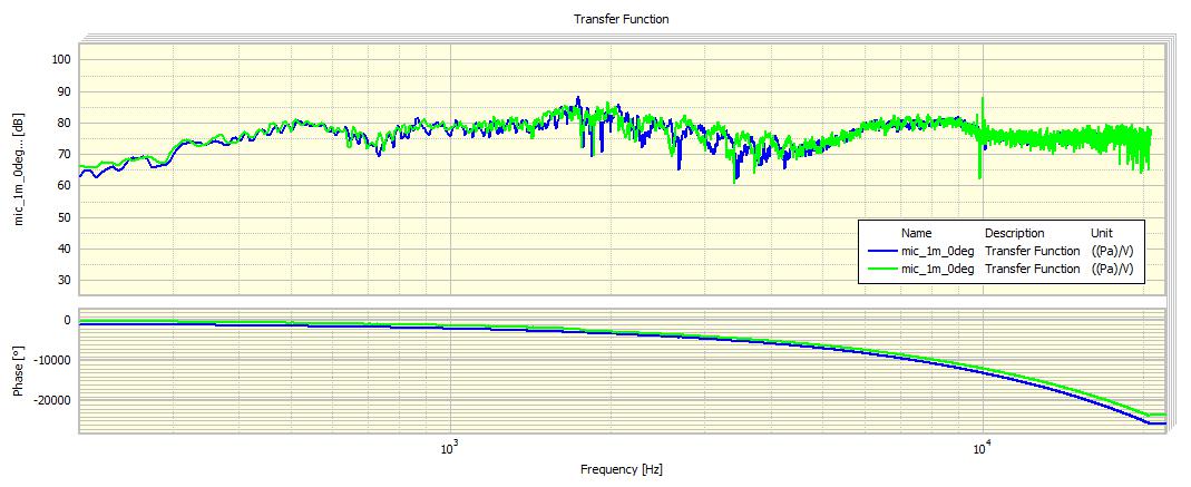

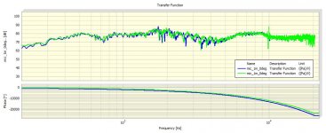

good I retook the measurements. One speaker gave me a fright since the tweeters did not work. It turned out it was a cold solder in the HP section pheeew. The upper mid-to-tweet crossing of frequencies is smooth; however there is a need for some EQ to get it to flat. Here is the overlaid measurement for the left and the right speaker at 0deg and 15deg. The shape of the acoustic response matches that of the voltage response measured earlier, however the change in amplitude is more than I expected so EQ here I come.

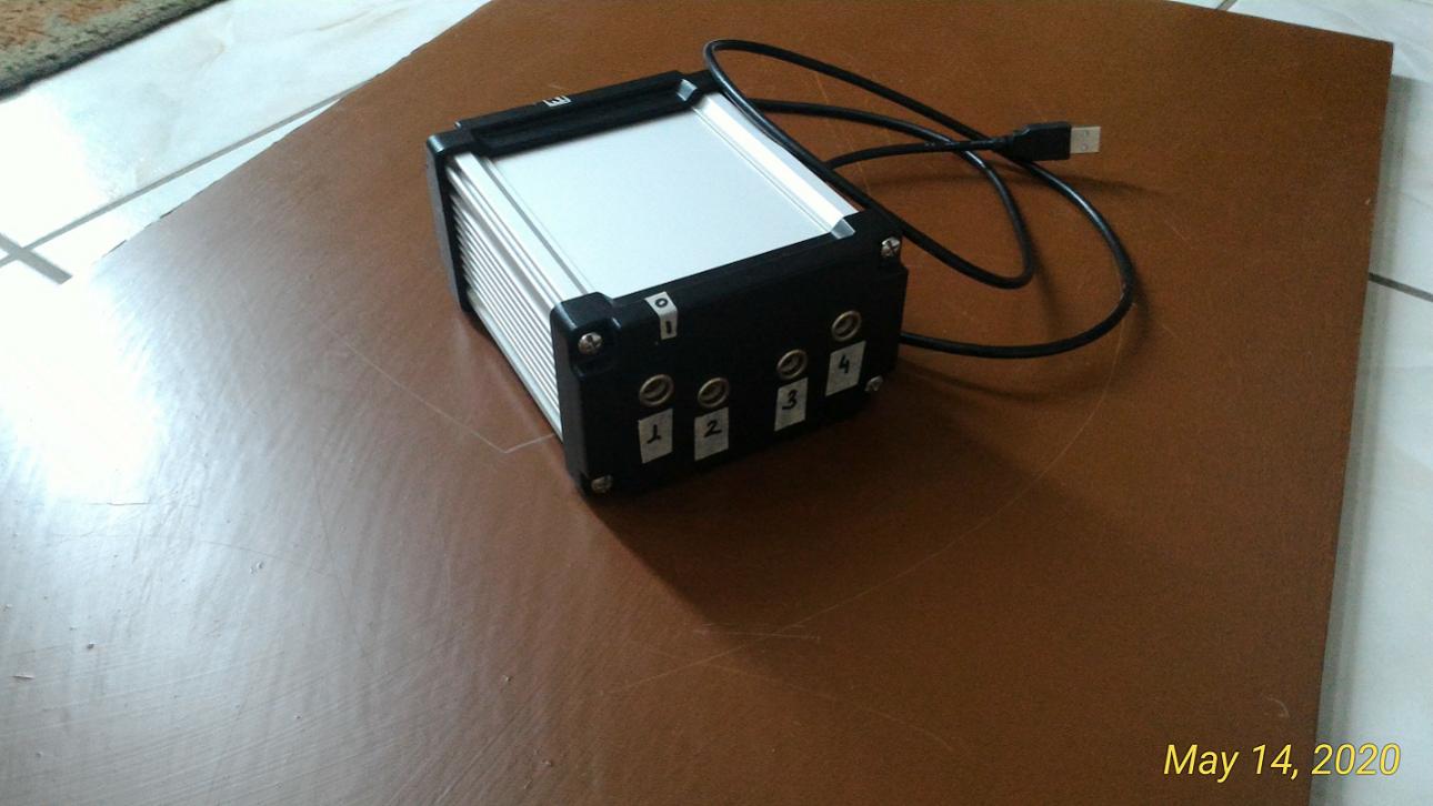

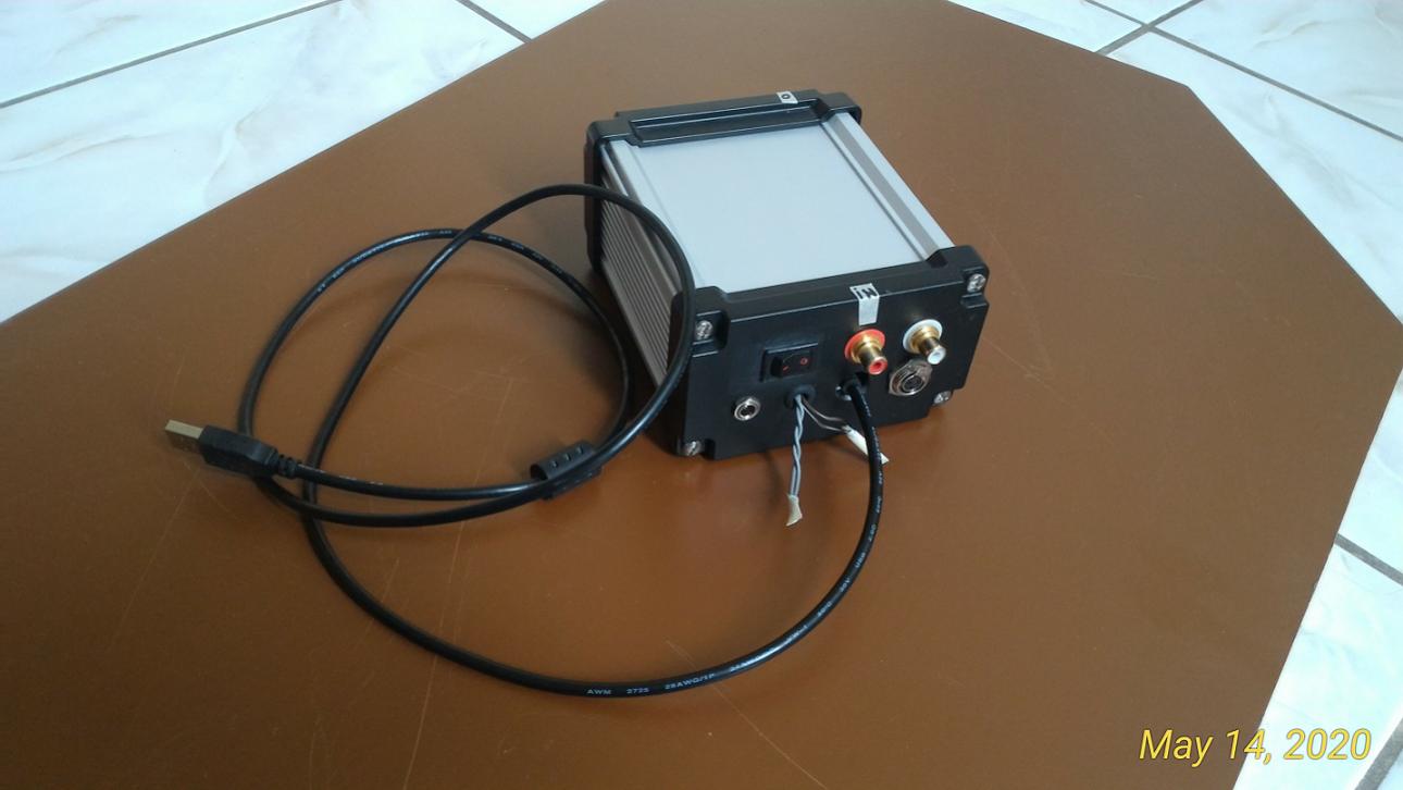

well I seem to have a problem with the kit version of 2x4 miniDSP balanced (plus miniDigi): the unit is noisy. If only one speaker outputs are used (say channels 1&3), the noise is so-so, but as soon as I plug in the output cable to the preamp on channel 2or4 the noise just goes up significantly. The noise is broadband in nature, kind of white noise in the upper mid driver and not the humming noise at PS 60Hz or 120Hz typical of ground loop issues. I am inclined to think that this is the board layout or component issue. I see quite a few folks complained about the same over years and no constructive feedback was received from miniDSP (who probably knows what the issue is but made the faulty boards and did not want to eat up the cost of a faulty design). My preamps and amps have been used with Oppo player balanced outputs and Elsinore speakers for years and are dead quiet.
Not sure where I will go from here. A big disappointment given that I have been waiting for LX521s to come together for a few years 😡.
apparently there have been A LOT of complaints about the balanced kit version of 2x4:

miniDSP team argued on all forums that with the proper gain structure the noise should be acceptable. I am not sure I understand this since I normally use Oppo 105 as a source with 4.2Vrms dBu on the balanced outputs and miniDSP should have 4Vrms at best. Anyways I will open Aleph P and use the dip switch at its input to get attenuation and turn it into a buffered volume control with no gain.
They also argued that the digital gain attenuation should not be used. So I will see that I eliminate it (I have a separate analog volume control on bass and high/mid channels since each has an Aleph P before the amp).
a few guys ended up using a 1:1 transformer but I do not see how that can help past the LP filtering due to a limited bandwidth of the transformer? plus the transformer would bring in its own flavour across the audio range.
I also have 4x10Hd in my other system with no issues running unbalanced. I would have to buy more XLR connectors to make cables and move the unit to try it. However that one will stay dedicated to my 3-way active OBs so it really would not solve my problem.
I have put this unit together years ago to use in such an application:
