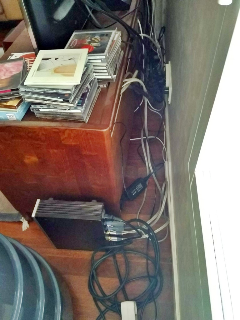

^Hard to tell. Keep cables far from other cables transformers. I once measured a friend's system and we had to lift the RCA cable from DAC to amp 10cm off from the floor to stop buzzing. The floor was concrete and obviously it's iron web made a circuit/antenna with the RCA cable. Balanced cables are not so sensitive and use higher voltage, better for long runs. My sources/pre-amp and main amps don't support balanced. Also a microphone cable with star-quad construction, terminated as RCA might help. Avoid this kind of "compact" mess that I have! AV-receiver, TV, Blueray, dtv-recorder, CD-player, minidsp, DAC, two power-amps, with power cords, signal cables and antenna cables!

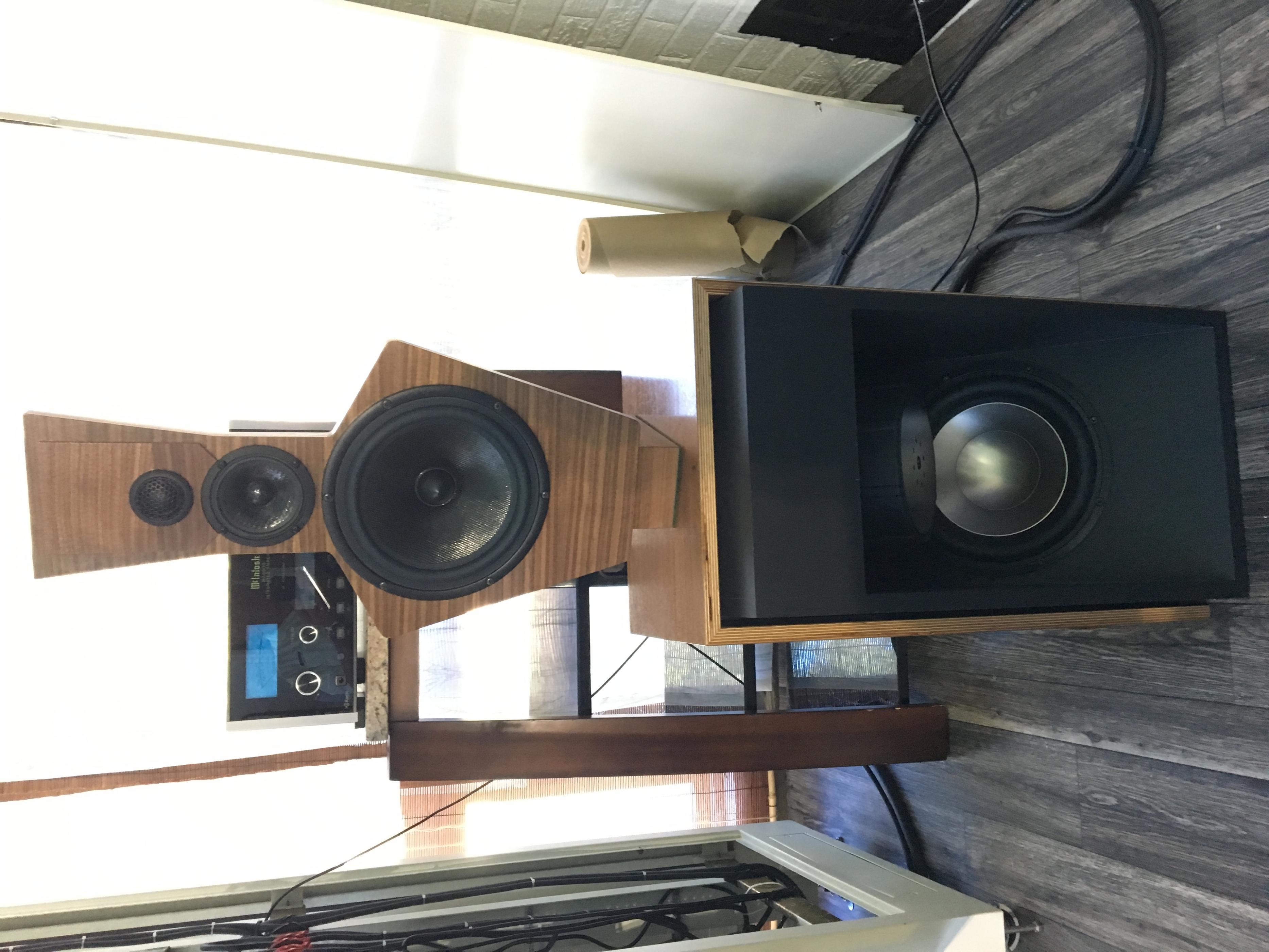

I have had the kit in boxes for a few years already. When I asked SL back then if he would engineer a passive Xover from mid to tweet for an LX521.2, he said that was perfect for DIY.

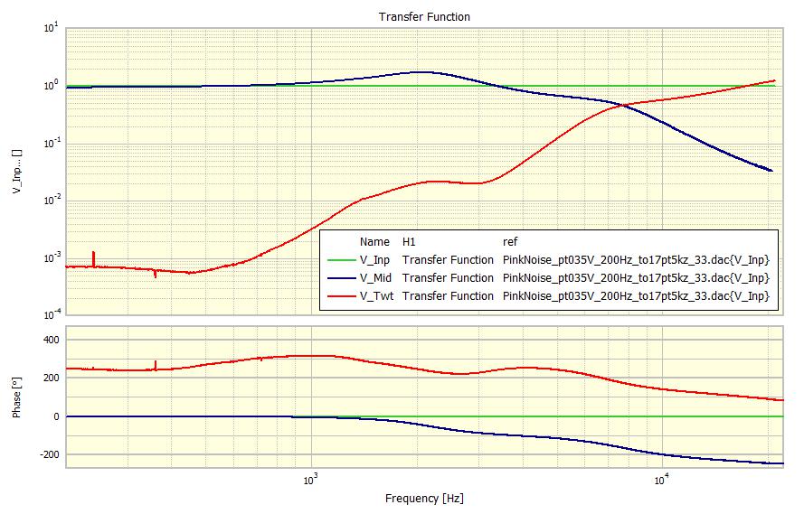

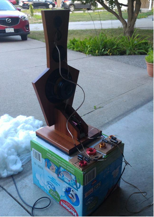

So I finally got to tackle it myself, an LR4 at ~7kHz (it turned out a bit higher after measurements). It looks good. The load acts up a bit at ~2kHz so on the LP the voltage transfer function comes up but apparently the current compensates for it since the SPL looks good.
LX521.2
next step is to take a few more measurements off axis and in the Fall work out the EQ. I will use SL's overall EQ target curve as a guideline.
I am not sure I understand it but I imagine he must have given the off axis effects a lot of attention and something drove him to it. Though he mentioned merging the low end with his woofers (and mine are different, down firing sealed with a 12inch driver). Some others mentioned a midbass bloom which they thought was intended by design.
Anyways I will first try the same EQ and then go from there depending on my room and taste. I will check the config file for what he used but I may not follow it to the letter since (my impression) SL sometimes tended to obsess over inaudible details.

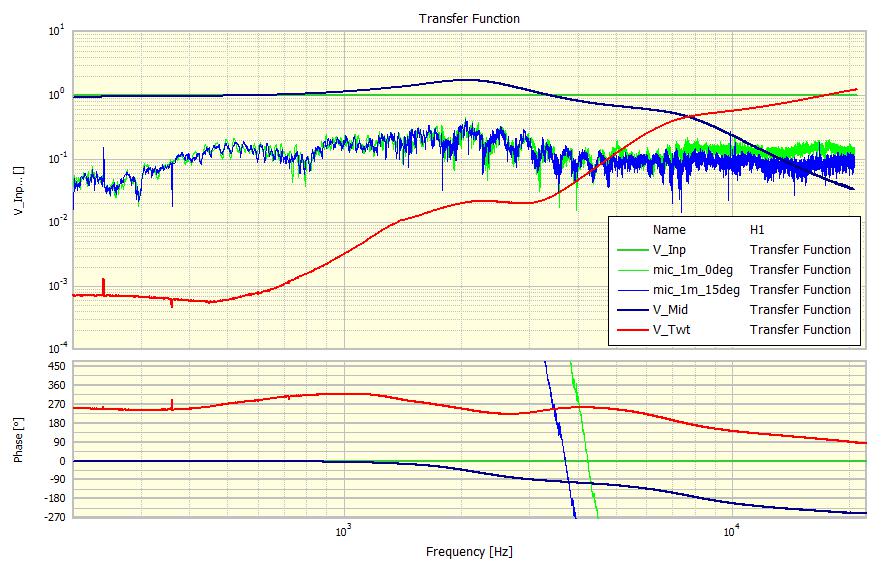

Shouldn't you eq out the tweeter's response below 3kHz, it doesn't follow slope and messes summation.

the blue, green and red curves are all Voltage (input to Xover, input to the combined mid and input to the tweeters respectively).

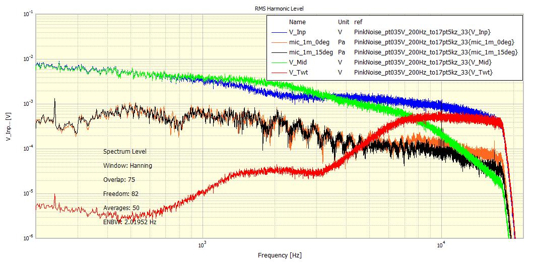

I only have one sound measurement for all playing together (as measured at 0deg and 15deg).
p.s. I initially took more measurements but had to discard them since my equipment contributed a 10kHz noise and now I am too busy to repeat everything.
I think the black curve (sound at 15deg) reasonably well follows the slope. Well 2kHz may be a bit of an issue as pointed out.
p.s. the mid is actually the lower mid plus the upper mid which SL already combined with a 1st order Xover. I treated that as a unit in the modeling software (Jeff Bagby's PCD). I suspect that any deviations down there are an interaction with SL's inductor-capacitor.
I am also trying to keep the piece count low because it is not possible to package the Xover behind the exposed baffle. I am considering mounting half the components on the baffle itself. I will consider though your suggestion to try EQ passively on the tweeter section only rather than try digital EQ on the input voltage to the combined drivers (as preferred for package).

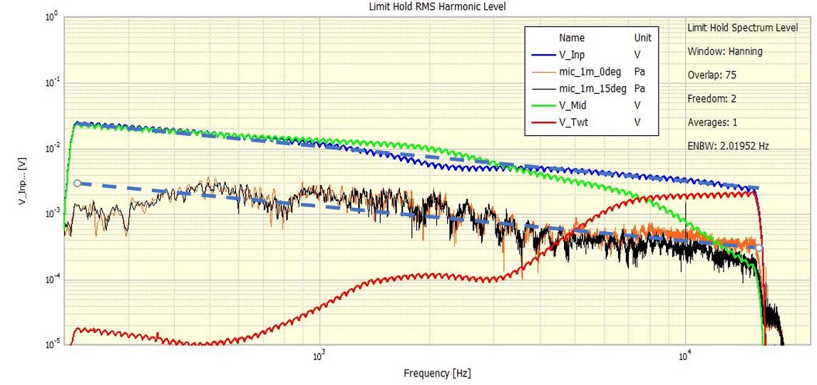

here is a trend line added for the voltage which the amp is trying to output and the parallel line on top of the mic measurements. This measurement was taken with a sine sweep unlike the previous one which was taken with pink noise.
admittedly a little better job could probably be done on the tweeter section.
