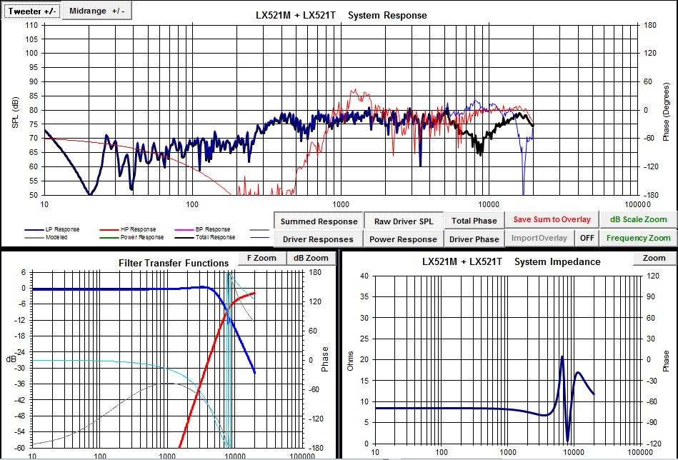

that is my issue too: I am used to designing active Xovers.
Thus I usually take a shortcut: instead of measuring impedance I import into PCD sftw SPL/Voltage transfer functions (instead of just SPL). Consequently I do not bother to specify any physical offsets between the drivers (since SPL for each is already phase referenced to the input voltage); and I also got away (so far) with just entering nominal impedance (since SPL amplitude has been normalized per unit voltage).

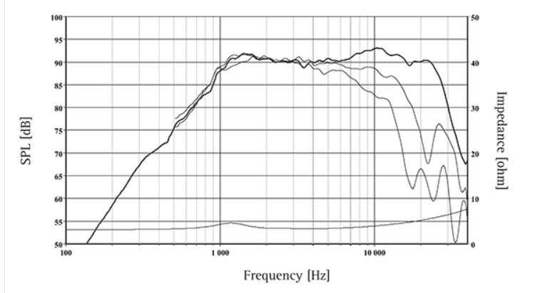

Since SL crossed these drivers so well within their on axis SPL capability, and the impedance in the manufacturer's spec appears uneventful, I thought this simple approach would work again; (I still see no reason why it should not).

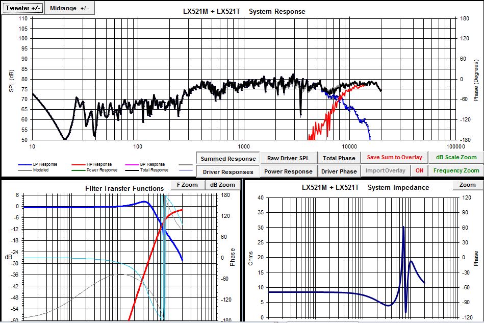

Here we have two 4 ohm tweeters in series and I entered 8 Ohms across the board. However, that electrical HP filter curve just breaks at some point (based on the measurement after the Xover) and that effect is completely missing in the sftw. So I am thinking the impedance measurement may be necessary this time. Else this is what I see in the sftw for the overall SPL summation with and without the tweeter inverted. Also attached is Seas spec for the 27TFFnc/g tweeter.

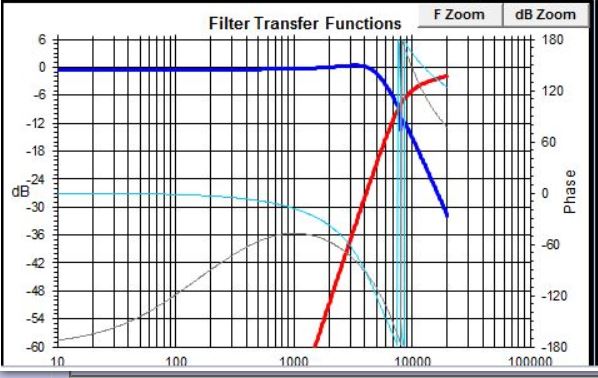

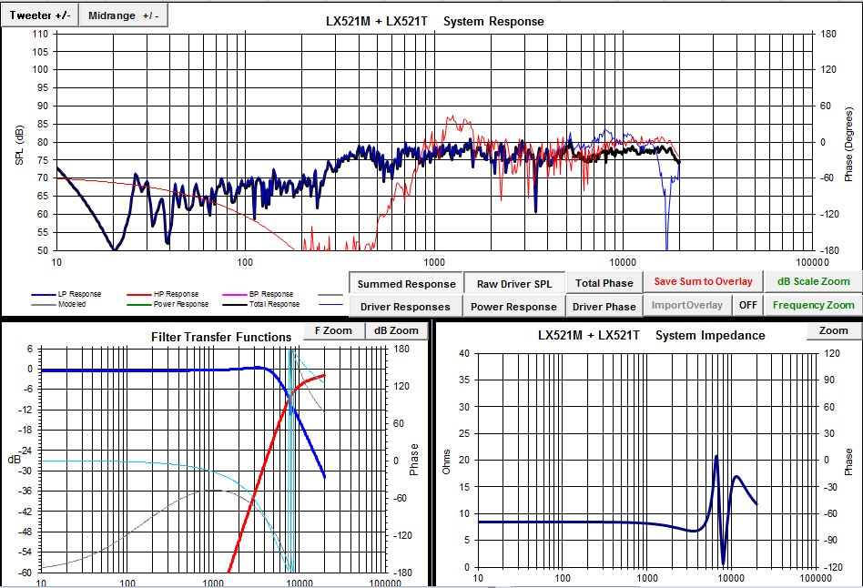

having thought about it some more, it looks to me that the likely cause is really the 2kHz resonance in the mid LP circuit rather than in the tweeter HP. it was harder to see in the previously posted plot but here on a linear scale it is a textbook 90deg phase shift under the peak.
So before throwing an additional notch filter at it i decided to try and optimize the filter circuit a little better to iron up the impedance up to the Xover freq.
After playing a little more with the component values in the PCD I arrived at this filter which now looks better. Now I have to order the parts and test the Xover circuit. (shipping cost is a killer when doing iterations on a passive Xover)

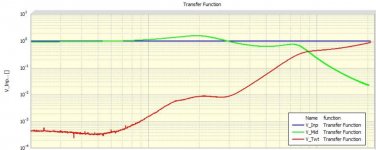

moded the Xover and retook the measurements. It confirmed that the phase tracking at the Xover frequency is now better. The mid response got a little bumped up on axis right before the Xover freq. Off axis all measurements look very good as a testament to SL having done an excellent work on the driver/baffle combination.
The only real issue is still that 1.9kHz resonance which causes the mid output to go over input and then under input at 5kHz. An additional 3 component wideband notch filter would probably sort that out. However, after I calculated the values for that filter, the cap came at 30uF which would be an electrolitic one.
I concluded that it does not make sense to iron out the curve in additional passive components when the filter characteristic to correct for is now a known (measured) curve and an active EQ is available and will be used, (since the low Xover to bass will be done with a 2x4 miniDSP). So I decided not to bother with a month worth of work to get an ideal characteristic passively but to EQ that out later on in the sftw.
the filter and the responses look like this. (in SPL disregard that 10kHz noise coming from my measurement equipment). I can post the values of the LR4 filter later on.

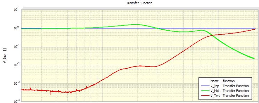

there is no significant resistance i.e. gain losses associated with this Xover since the coils are small. I have them in AWG18 wire and the Rs are on the order of 0.2 ohms or less. I will post the component values probably this weekend.

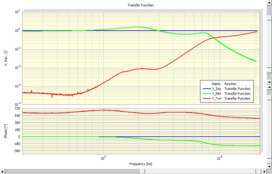

Crossing the upper mid to tweet has been realized with no issues. With the 2nd iteration I got a nice symmetrical notch with inverted tweeter measurements. So that part was textbook.
As already pointed out: the only issue is the wavy green line in Xover voltage measurements BELOW the Xover frequency. One would want a flat line close to ratio 1 (which is 10 to the power of 0 on that graph scale) i.e. input voltage at all frequencies below the Xover going through the circuit unaffected. So one would expect a flat line like the blue line in the modeled Xover in PCD software. I reattached the 2 graphs for you.
Due to some electrical interactions, adding the LR4 Xover in front of SL's 1st order (lower mid to upper mid) Xover, caused a clear resonance at 1.9kHz which produced this wavy gain characteristic which now has to be corrected for to get it back to flat.
Two choices here: (1) this could be done passively by adding another 3 components (LCR), or (2) the smarter approach (for me) is: since I am using miniDSP for bass-to-mid Xover I have EQ capability and will enter in miniDSP software a wave which is the inverse of the green wave so the sum result after the Xover will be a flat response. If I am not lazy I may even verify that by taking voltage transfer function measurements with miniDSP EQ added.
