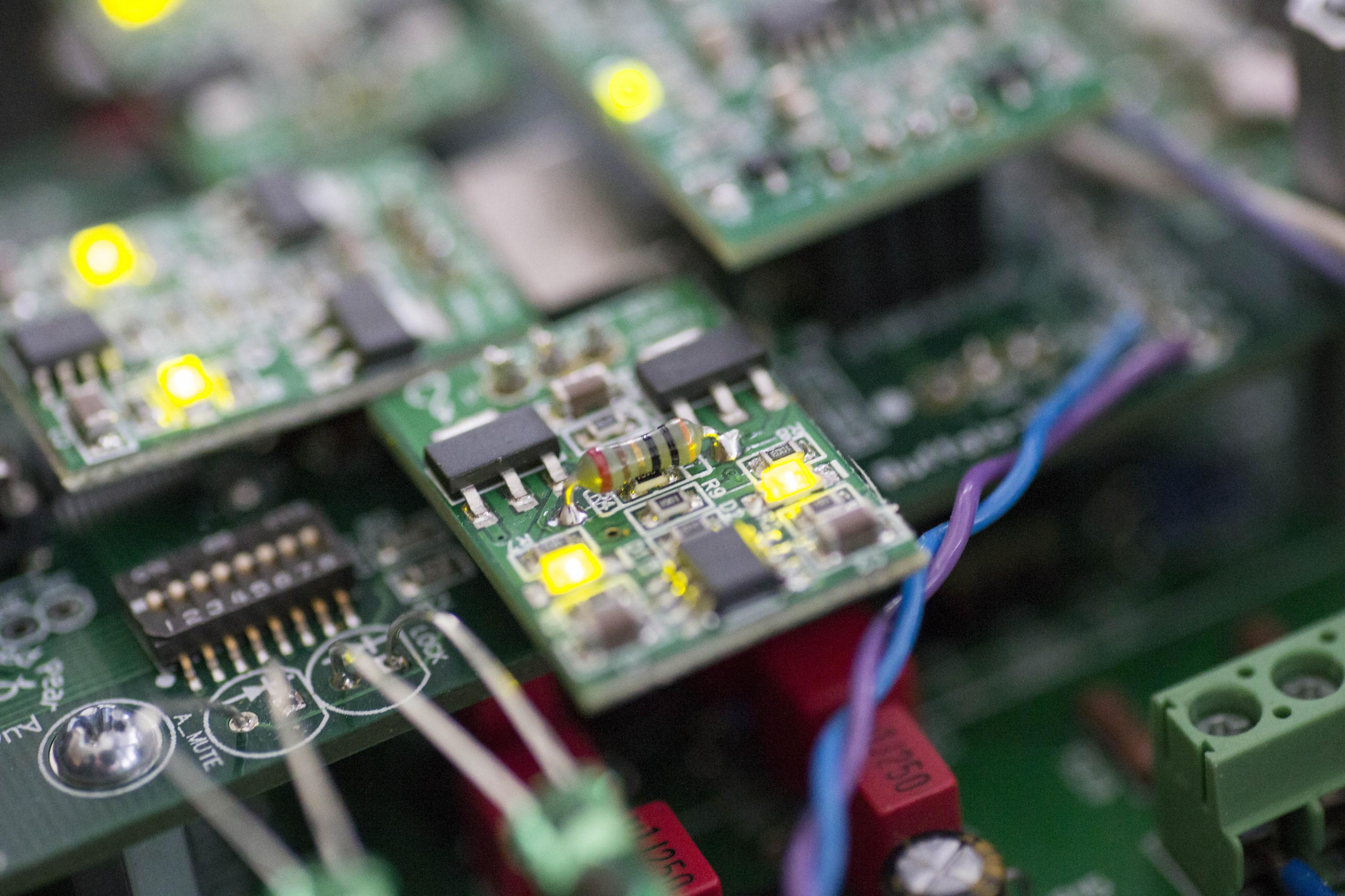

Hmm few observations:
1) The 1.7V reading at idle seems quite high - you may want to double check that. 1.7V is way too much for the chip to handle safely.
2) The 1.08V reading is definitely low (sign that the trident is starved for current) - You can add 27-35R at R4 on that trident to give it more current. (any 1/4W metal film type will work fine)
3) Also make sure the VD supply to the B3SE and the supply to the Cronus don't dip below 5V when 384khz music is playing.
A small step for mankind, a giant step for a man! A 30R resistor solved the problem! Thanks Russ!!! (And Grael and Brian)

Any chance of posting a photo of the resistor you have installed it may solve an issue I've had.
Sure... This solved -my- problem.
Good photo thanks
