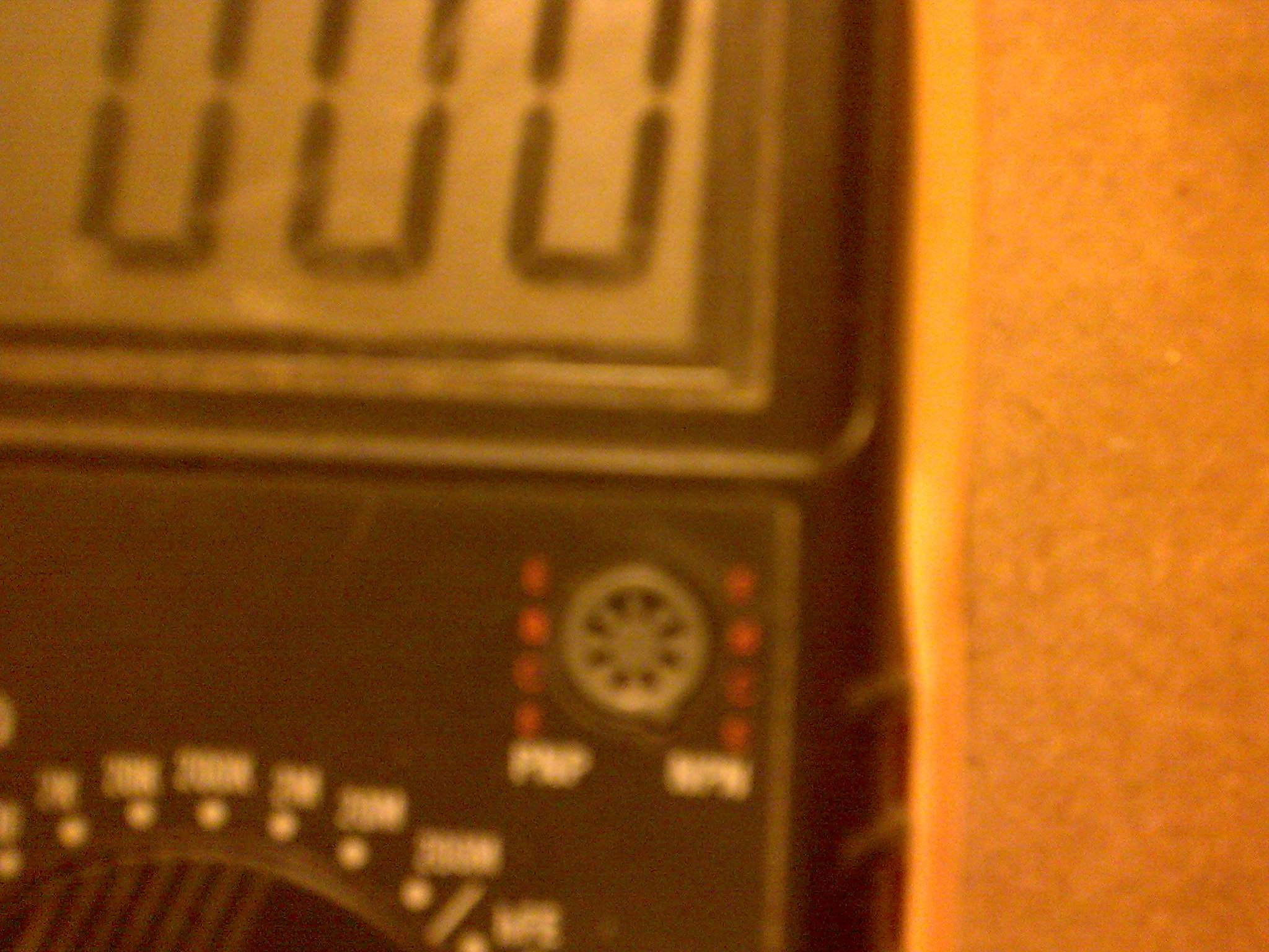

Well, out went T1-4, and i just used the multimeter to do a quick check on them just to see if this would reveal something obvious.
T1 = Vbe 0,943 Hfe 357
T2 = Vbe 0,939 Hfe 308
T3 = Vbe 0,998 Hfe 255
T4 = Vbe 0,993 Hfe 256
Now, as I mentioned earlier on, the Vbe values seem a bit high, but I'll put that down to the multimeter and assume that this is usable for relative comparison.
What is obvious is that there was quite a difference in Hfe between T1 and T2
T3 and T4 seemed to be a better match, but the difference in Hfe Between the T1/2 pair and the T3/4 pair seems quite big.
But the big question is, and I need help here, does this correlate with and fully explain the -0,175 V offset on the output?

You should simply first change the battery of your multimeter..
The readed value can be stuck at a high value whatever the real
vbe of the tested device...
Finding the solution using a faulty tester is just plain illogism,
moreover if the devices must be matched using this same apparatus.
