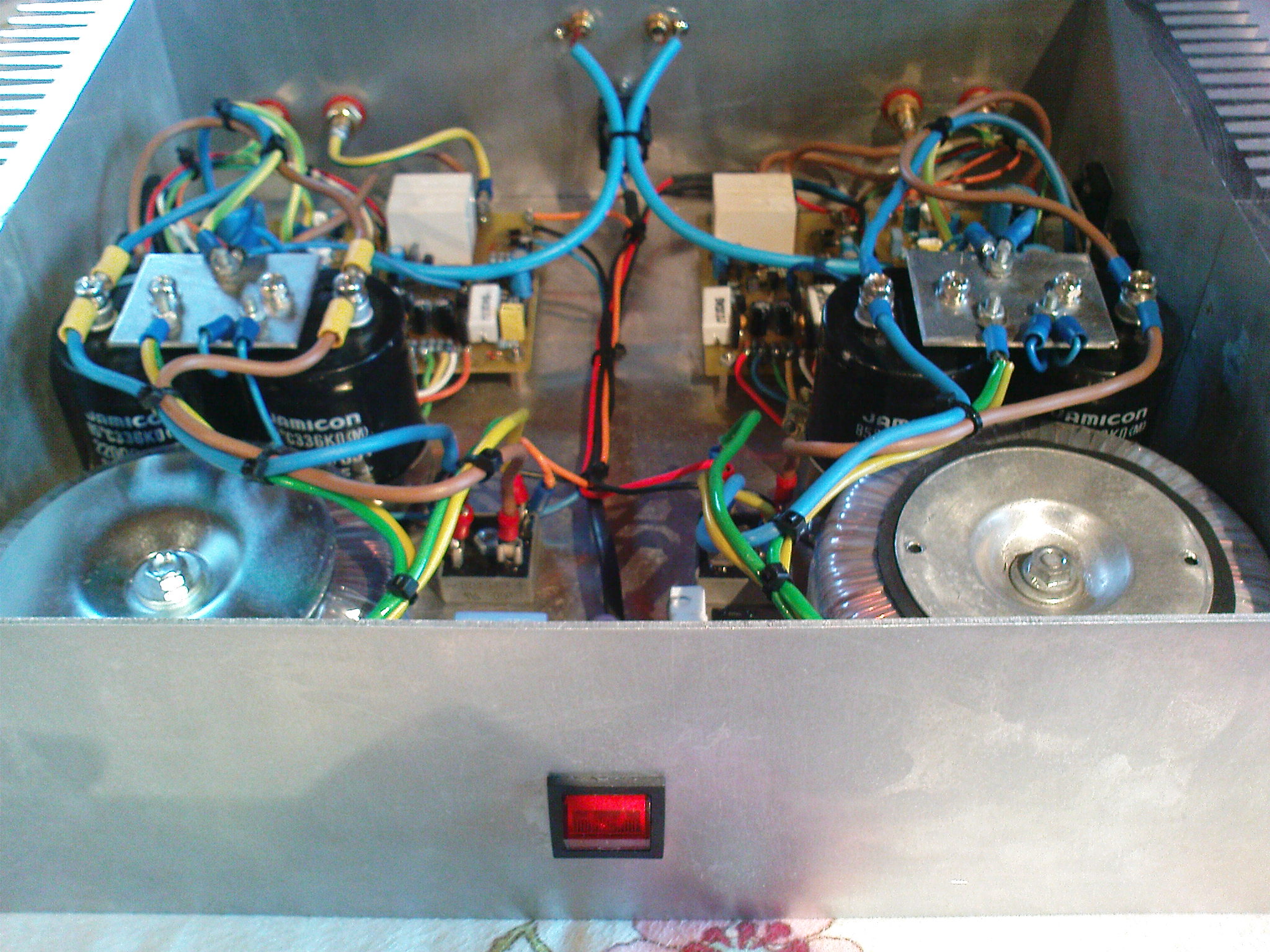

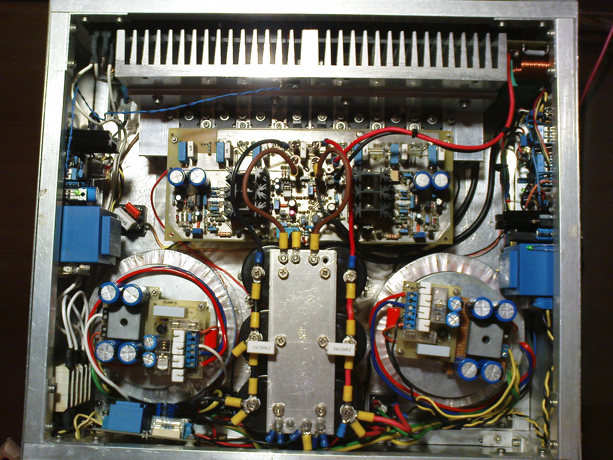

I made two times Crescendo Millennium and i dont have any problem .
dc offset without dc servo 1,7 volt with dc servo 3-5mv
I measure 35 pk -pk before clip with 45 mv idle current stable all ambient temperature 22-35 C
also i made two times TITAN 2000
best regards nikos

i know that .
i mean the dc servo can work start applying a correction voltage and cancel finally the output offset .
on TITAN 2000 i have 0-10mv dc offset without dc servo because i use matched transistor.
