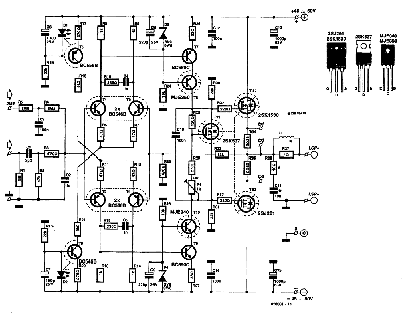

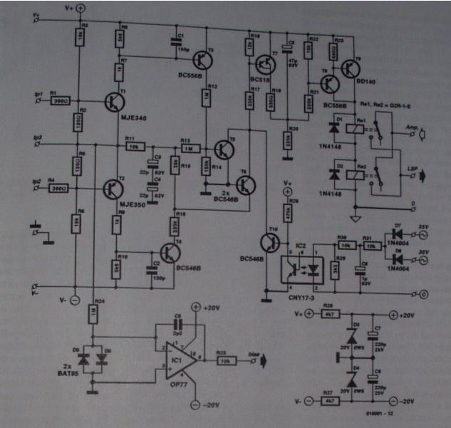

Anyway, found some images of the schematics for both the amplifier and the protection/ bias circuit!
Hopefully, someone better versed in Amplifier and Analogue circuitry than me can see what to look for..

To determine the reason for the offset, you must investigate the voltage amplifier and the push pull buffer separately.
Probably an error in the voltage amplifier is the reason. For checking this stage allone, remove tthe MOSFET T12 and T13. Make a short connection between drain and source of T11 (T11 = Vbe multiplier).
Disconnect the right side of NFB resistor 12 K (R23? - hard to read exactly) and connect it with the short connection between drain and source of T11.
If the offset is still present, the output power stage isn't definitely the reason.
Now you can perform DC measurement both in pos. and neg. half and compare.
What type of ref LED is D1 and D2 (either 1V6/red or 2V1/yellow) ??
1V6/2,1-0V65 = 0V95 : 270R = 3,5/5,3 mA through diff amp (voltage across R8/9/13/14 each 1,75/2,65V)
Idle current through predriver (VAS):
3V9 - 0V65 = 3V25 : 33/39R = 98/83 mA
If I can see your results, I can say more.

You should check wether it s the amp itself or the DC servo that
are the source of the misbehaving.
First is to test the amp alone as follow :
-- remove R4 to disconnect the DC servo.
-- replace R2 by a 12K.
-- connect a 220uF cap in serial with R22.
Power on and measure the output dc voltage.
It should be at very low value, since the amp
has now a DC gain of 1 in respect to the input
offset.
If it works this way, then it s the DC servo that
is misbehaving.
If not, then perhaps the amp is oscillating,
in wich case it can be corrected by adding
a compensation that is ABSENT in the original
schematic...

Wahab, the bias servo return is connected to the card with a contact, is it sufficient to disconnect this, or should I still unsolder R4 for some other reason?
Right, so let R4 in place and just disconnect the contact...
And don t forget to ground the input before output DC measurements..
Wahab, thank you!!
I followed your instructions, and when I switched on the power, I measured 0,17 V!
Admittedly, not the "below 0,1v" quoted as normal in the magazine article, but I think this proves that the culprit is somewhere in the DC-servo circuit on the protection card....
Now I need to find out what I've done wrong with the protection card.. seems like I've made a systematic error as I had exactly the same result with both cards I tested..
The only deviation I know of, is that I used an OP177G opamp in stead of the originally specified OP77.
To the best of my understanding the OP177 should be a direct replacement for the OP77.. could this be where I went wrong??

Thanks for the schematics! Looks like a good sounding amp to me, I built a similar one myself with the 2SJ201/2SK1530 as output devices, and it sounds great!
I would also check that the LEDs have the same voltage across them. Any difference here is bound to cause different currents through the input stages with DC offset as the result. The DC servo is probably the problem here as it seems, but the amp should actually perform very good even without the servo if only the current sources in the input stage are matched properly.

Not the greatest of image quality on those schematics, but it turned out that my new PC doesn't wan't to talk to my old scanner, so I had to grab something off the web..
This is too high in respect of the expected value,
and at first look, the voltage divider that consist of
(R5+R4+R3+R2)/R2 has too high ratio, so the servo
has a limited range of correction that cant deal
with such an offset..
You can extend the DC servo correction range
by deacreasing R5 and R4 to 470K each.
In this case, C3 must be increased to 680nF.
Of course, reset R2 to 47K, i.e, its original value.

Fortunately, I have an Osciloscope, so I'll use that to check the output offset for any non DC output.
And I'll check the voltage across the LED's.
Regarding resistors, I took care to measure all resistors I used to make sure I only used those closest to nominal value and that the resistors installed on each card had a minimum relative tolerance spread.
The 0,17V was with the servo disconnected and the circuitry temporarily modified as per Wahab's instructions.
I allso did a quick check to see if the OP177 opamp in the DC servo circuit received correct voltage, and this was OK.

BTW,
the opa177 is exceptional for a BJT input opamp for very good output offset and offset stability.
Normally FET input opamps are used for this duty, but the 177 spec looks perfect for servo duty.
First, with no servo attached the amplifier is set up to correct output and driver bias currents.
Second, the output offset is set when the amplifier is cold, say 1second after switch on.
Third, the DC servo is activated and the cold through warm to fully warmed up should stay at the cold output offset value.
Very few comments came back on this procedure, but one did agree that it made sense.
This procedure requires the amplifier to be initially set up without the DC servo working. Pull the IC out of it's socket.
BTW,
Andrew,
Thanks for looking in to the OP177 issue. I did scrutinize the datasheets for both OP77 and OP177, and could my self find no cause for concern, but nevertheless, a second oppinion was much welcommed and I guess I can now close this one out as a root cause.
I am working from the assumption that the elektor design I have used is sound and should be working as intended without modifications as published, and that my problems are due to some mistake/ fault, not the basic design as such.
But having said that, the procedure you refer to would be interresting as a background for aiding investigation and fault finding.
Do you have a reference to this??
Br,
Br,
