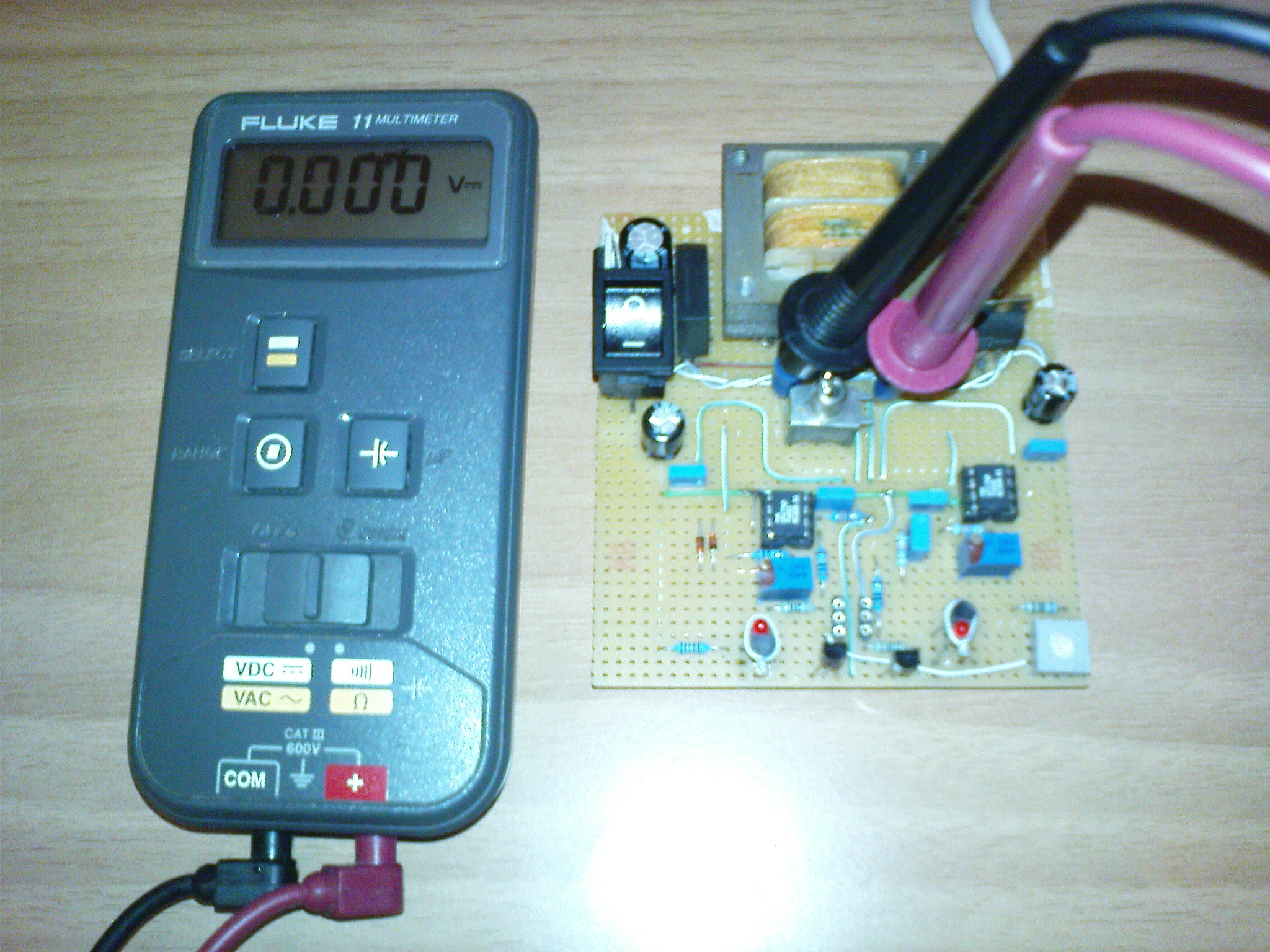

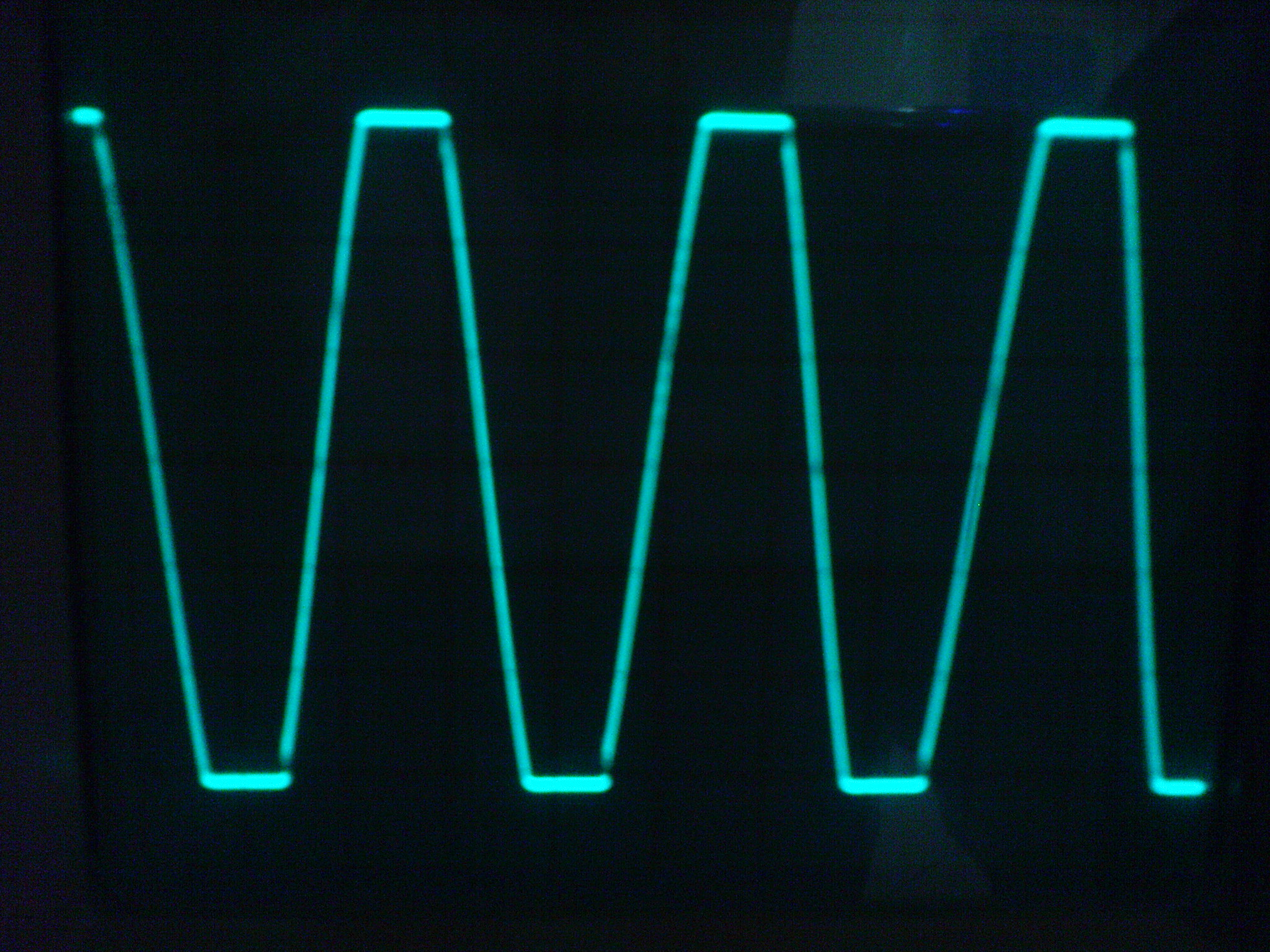

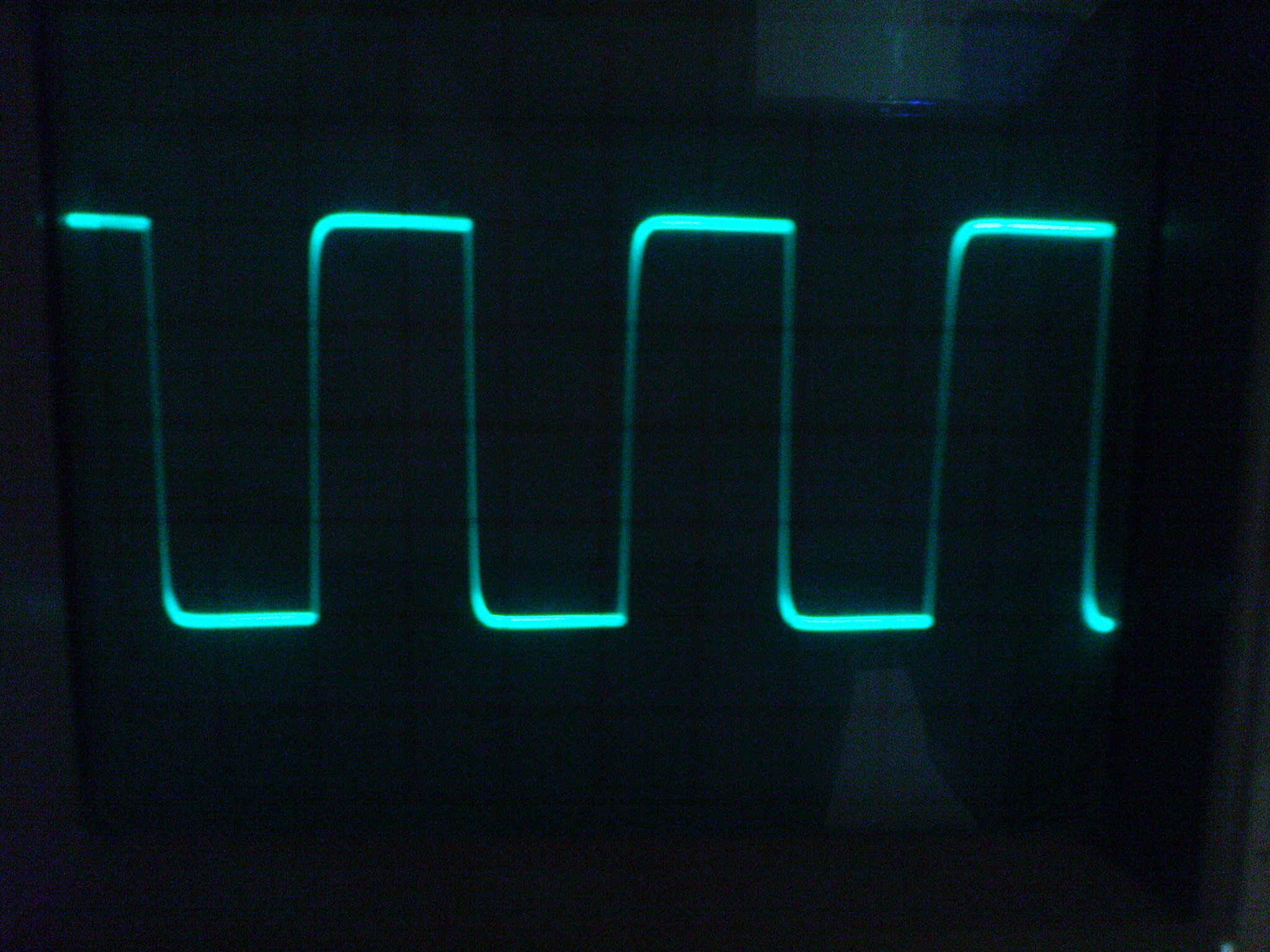

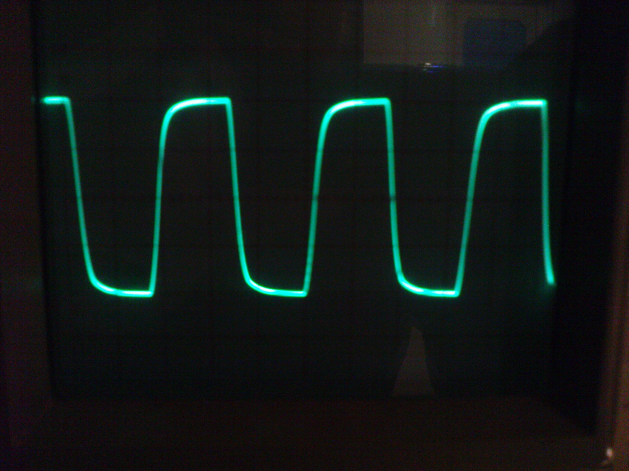

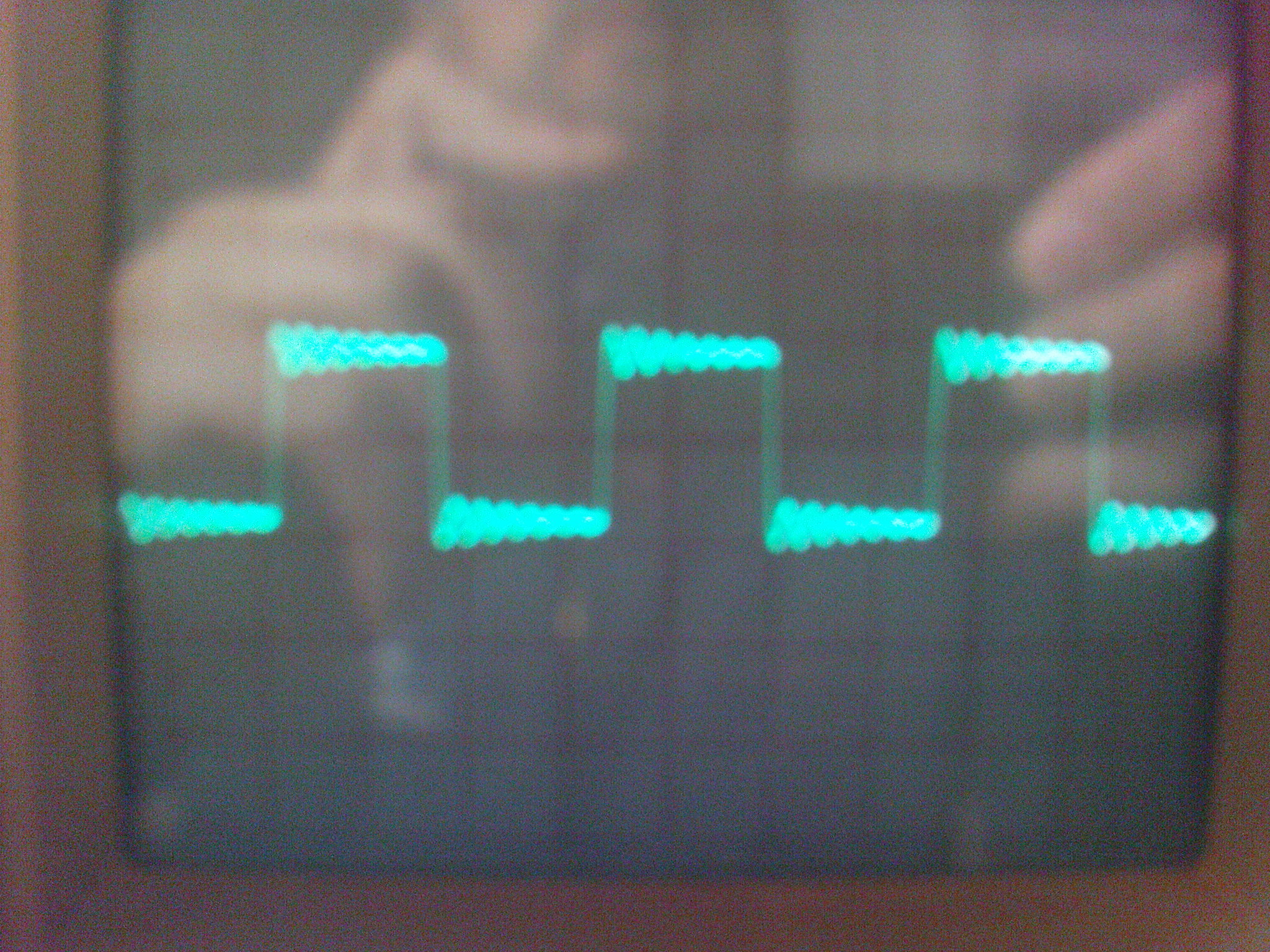

Hi Elbert and others members
Measurements in the archive is an asymmetry unbalance in the value volt over the resistors R8-R9, which gives us a measurement of 0.26V , 260mV The manufacturer accepted measurements below 100mV
Τhe two amplifiers that I have done so I have managed to under 100mV with perfect match T1T2T3T4 and zener d3,d4.
Also i have made a transistor matcher that works fine.
Now I have succeeded in exiting the transistors Τ2-Τ4 12mV
