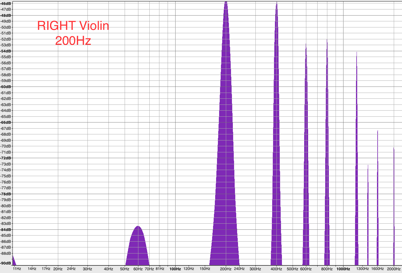

Yes very small. I frequently use the magnifying app on my smart phone to check for any shorting. I think it would be exhausting finding a better matched complementary bc856b/bc846b than hFE1/hFE2=99%, and Vbe1/Vbe2= 95%, which I put into the right channel. We discussed how wether or not better matched complementary LTPs can affect sound quality, and I've read reports that either matched or poorly-matched LTPs can reduce or increase 2nd or 3rd order harmonics in certain types of circuit designs. To test this theory on my particular input stage I ran a 200 Hz violin waveform (available at - https://meettechniek.info/additional/additive-synthesis.html) from my mac mini -> dac -> Destiny -> headphone output -> mac mini line in. I used Audacity to run the spectrum analysis. The results are exciting: Except for a louder 60 hz signal in the right channel which I can faintly hear when I put my ear to the speaker, I found L/R symmetry in the amplitudes of the harmonics!
1. The semis I replaced in the right channel did not affect the 2nd and 3rd order harmonics.
2. Creek Audio probably wasn't able to match the stock LTPs as closely as I did in the right channel.
3. Replacing the semis in the right channel had no affect on sound quality based this analysis.

That's an interesting spectral display comparison - might look at trying it and a few variations myself. Thanks for sharing the details.
