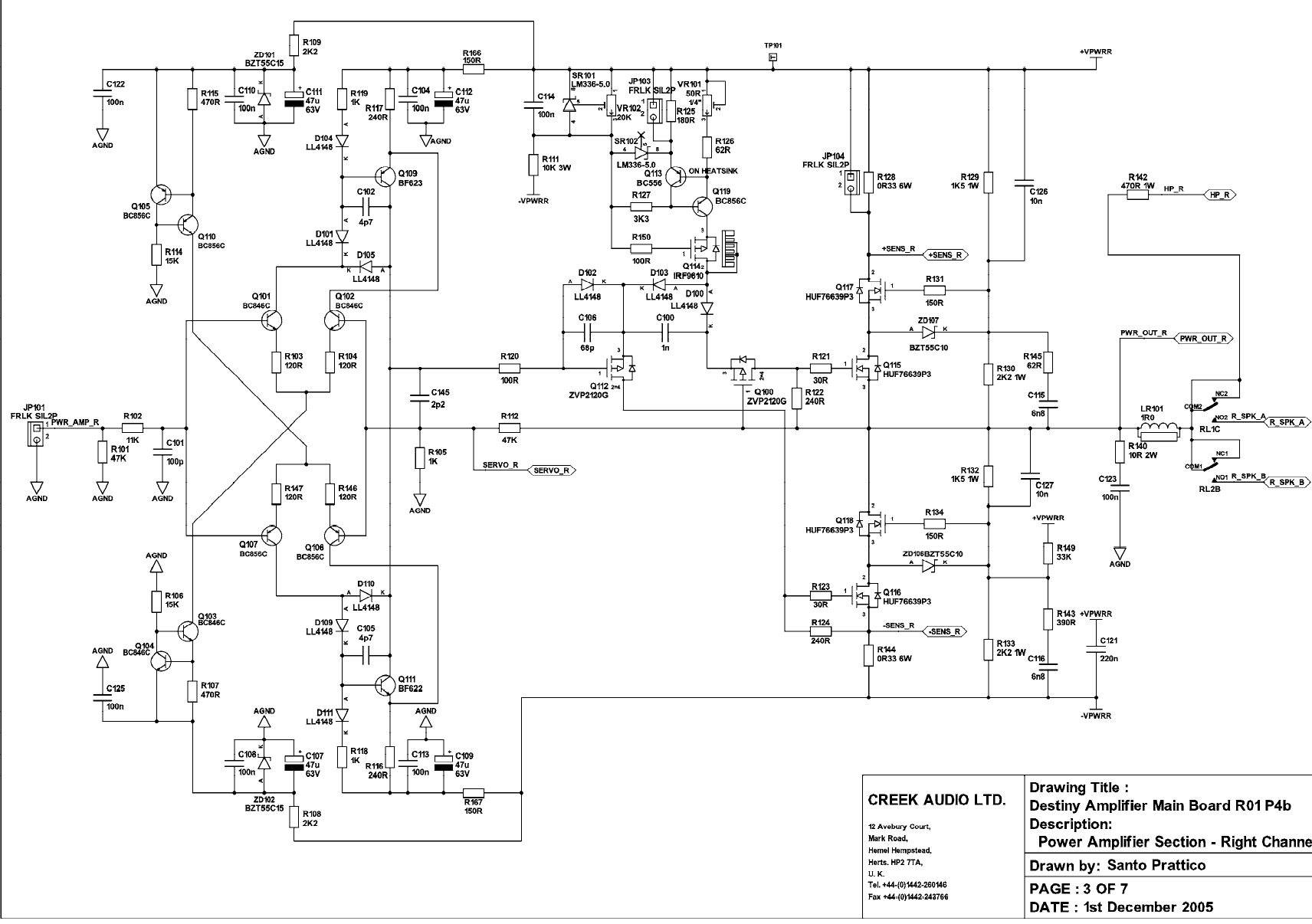

Regarding matching, you'll only see benefit from matching the LTP transistor pairs Q102/3 and Q107/8, already discussed. I'm guessing the other channel references are Q2/3 and Q7/8 which would be conventional numbering. These are described as galvanicly isolated pairs so there could be something in selecting particular pairs but I doubt you'll hear more than an illusory sonic benefit, as I found long ago, even with Natsemi's LM394 supermatched pairs. There just isn't much point selecting a particular pair from those that are already sufficiently well matched by the manufacturing process. Generally, it's is a waste of time where global feedback controls the overall gain and normal, close component tolerances take care of local differences which goes some way towards answering your remaining questions on feedback. Whilst this search for precise matching at audio frequencies goes on though, we also have to be concerned about DC balance or offset, too. That's yet another layer of priorities and often conflicting solutions.
Where multiple transistors are in parallel, such as the output transistors of a big amplifier, matching is often required there to ensure optimum stable performance and current sharing at maximum power level. It's an expensive but necessary way to maintain stable and reliable high power for PA, live music reinforcement and is usually a pro. audio application but there are monster home theatre systems out there too - a power trip that some people find compelling in itself.
I think you mean Q101/2 and Q106/7 make up the LTPs, correct? Your details help put matching LTP transistors in this circuit into perspective, thanks. I am in the dark here but can gather sound quality improvements are unlikely. It will take some time for me to piece things together. For instance, is the DC Servo part of the global feedback you mention? I understand it reduces dc offset and appears to do this recursively. Which brings up another potential reason to replace the LTPs: I believe I’m seeing a larger channel imbalance in the right channel. The DC Servo circuit at U101 pin 1 =80mV, vs. U1(1)=15mV in the left channel. Am I correct in my interpretation ? If so, can replacing the LTPs with better matched pairs improve the channel balance? Does that spill over as dc offset? Also, I’m seeing the dc servo output - U101 (8 and 9) = 80mV that slowly reduces to 20mV after warming up. While measuring at trh speaker posts is less than 1mV. Versus left channel U1 (8 and 9) is less than 1 mV. Sorry for the tangent.

Yes, correct. I took that 6 for an 8, when reading Q106. The little numbers are somewhat blurred on my screen.

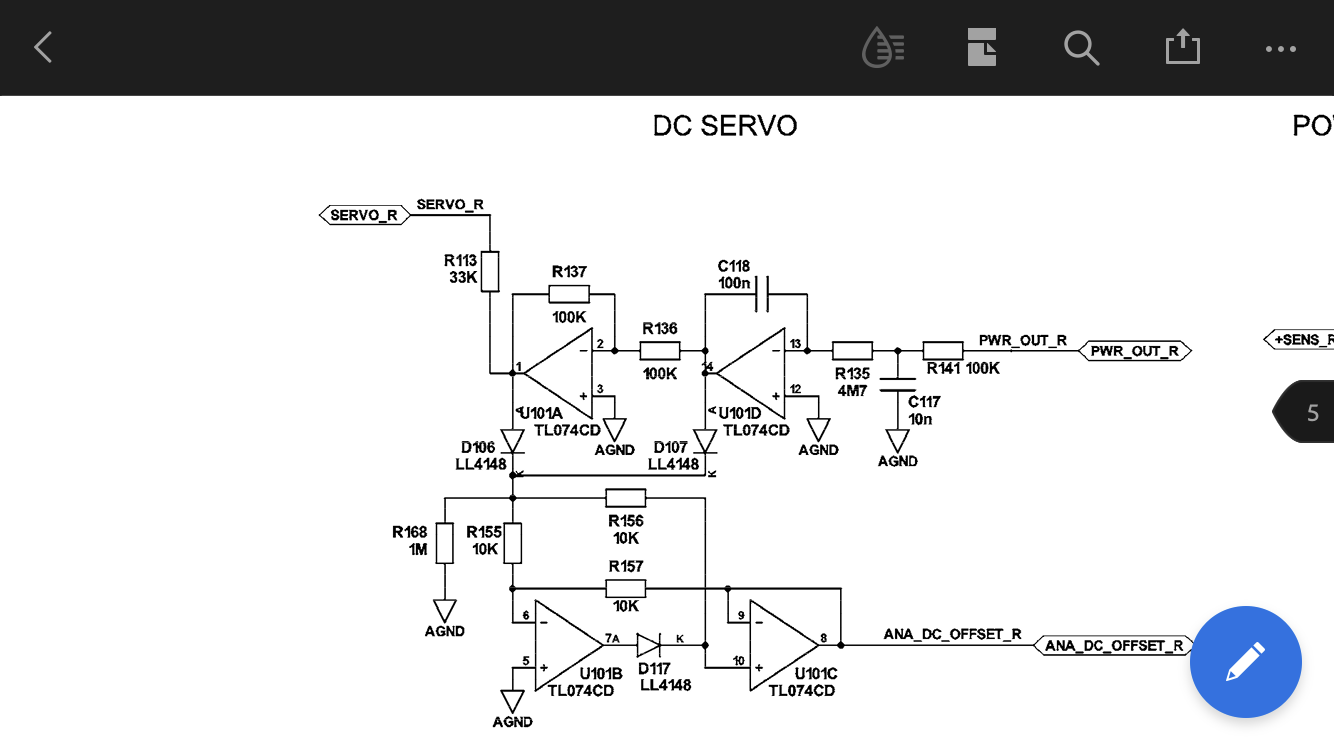

DC offset is treated more seriously with Mosfet amplifiers like this later, Creek design. The actual circuit for the DC servo must be on another schematic but we can see that the servo connects to the same node as the audio negative feedback loop, at the bases of Q102 and 106 of the input LTPs . The servo itself is usually a JFET type IC opamp or two in a circuit that filters out the audio signal in order to sample just the averaged DC potential or "offset" at the amplifier output, WRT signal ground. It then servos out that averaged error by adjusting the dc potential at the LTP accordingly. Again, there will be a scaling factor according to the amplifier's gain but this time its DC gain, not the same as its AC or audio signal gain.

Ah ok Im understanding more on how the input transistors are connected to the dc servo, and why there are diodes in the dc servo in the first place. BTW the dc servo circuit is located on pages 4 and 5 on the main board schematic I uploaded. Does the 80mV wrt ground at U101(1) represent the channel imbalance between the signals? ok an eraser sounds like an easier method, thanks.

Well I replaced the right channel LTPs.
I tested each transistor at least 3 times for consistency. Finding 2 matches was surprisingly easy out of 15 bc856b and 15 bc846b. Matched hFE gain values were within 2% ( the full hFE range of tested transistors was 275-330) And matched Vbe within 5% ( range 660-720). As it turns out U101(8 and 9) increased from 20mV to 200mV with the newly matched transistors. Is this 200mV something to be concerned about? However dc offset at the speaker terminals is still well below 10mV. What I don’t understand is why the dc offset output value increased with these well-matched pairs. Anyhow, I’ve learned my lesson don’t fix it unless it’s broken, and fortunately I’m still ahead - the amp still works and still sounds good to my ears.
Ok reading your post again regarding the dc servo. It looks like the dc servo is doing its job just fine. For anyone who decides to replace these ant-sized transistors in tight spaces I found the easiest removal method is add a small amount of solder to each lead and then use a fluxed desoldering braid back and forth until the transistor slides off. Clean up, then slide the new transistor onto a heated small puddle of solder for the collector lead. I added solder to the remaining leads with the nail polish method. Just a wee bit on the solder tip and then painting that on the leads. And just to follow up any changes to sound characteristics before and after swapping the input transistors are imperceptible. Thanks again for all the help!
I'm still curious about out why the dc servo is seeing 300mV (a 4x voltage gain compared with stock bc846b and bc856b) at U101 pin 1 WRT ground. Is the initial offset before the dc servo? Could it be caused by poorly matched LTPs? It turns out the the tester is inconsistent (within 10%) when reading bc846b hFE values: It switches from 284 to 301 hFE, while Vbe values are consistent. hFE values for the bc856bs are consistent (within 1%). Is it possible under-matched NPN/PNP LTPs (yet still within 10%) explain the increase in voltage at U101 pin 1? Or what might cause such an apparent big rise in voltage (80mV to 300mV) at U101 pin 1? Thanks for any help.

And I'm seeing very good dc offset voltages at the right speakerr terminals: 1-3mV. I'm not hearing any issues in the right speaker either.
But should I be concerned about the numbers I'm seeing in the Right DC Servo WRT the left? If so, what troubleshooting steps would you recommend to identify the issue(s)?
U101 pin 1: ~300mV (formerly 80mV) ; U1 pin 1: ~15mV
U101 pin 8 and 9: ~150mV (formerly 20mV); U1 pin 8 and 9: ~0.6 mV
The original semi were also BC856B and BC846B, I can't figure out why those numbers changed with perhaps better matched pairs.
