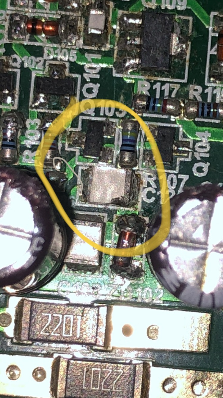

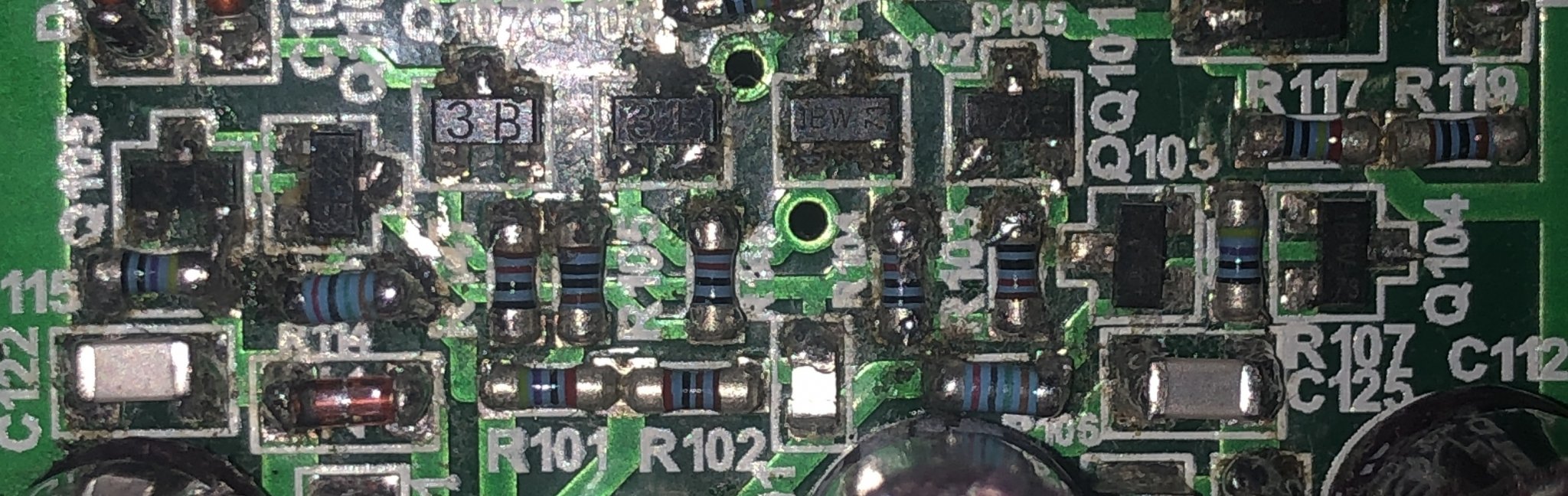

Hi All,
I'm trying to figure out if I should replace the paired transistors in my amp according to the schematic or stock. I noticed the transistors on my Destiny are printed with 3B and 1B, which are BC856B and BC846B. While the schematic lists BC856C and BC846C. The twist is I've also found a close up photo of another Destiny that has markings 8AC and 9AC (BC856C and BC846C) on those same transistors. The only difference between group C and B that I can determine is the hFE values. Are there any sonic differences I might encounter with one versus the other in this stage of the amp? Does the different hFE apply in the circuit? Do I follow the schematic? The BC856Cs and BC846Cs are difficult to find but available through Diotec, a marketplace seller on Digikey. Any help is appreciated.

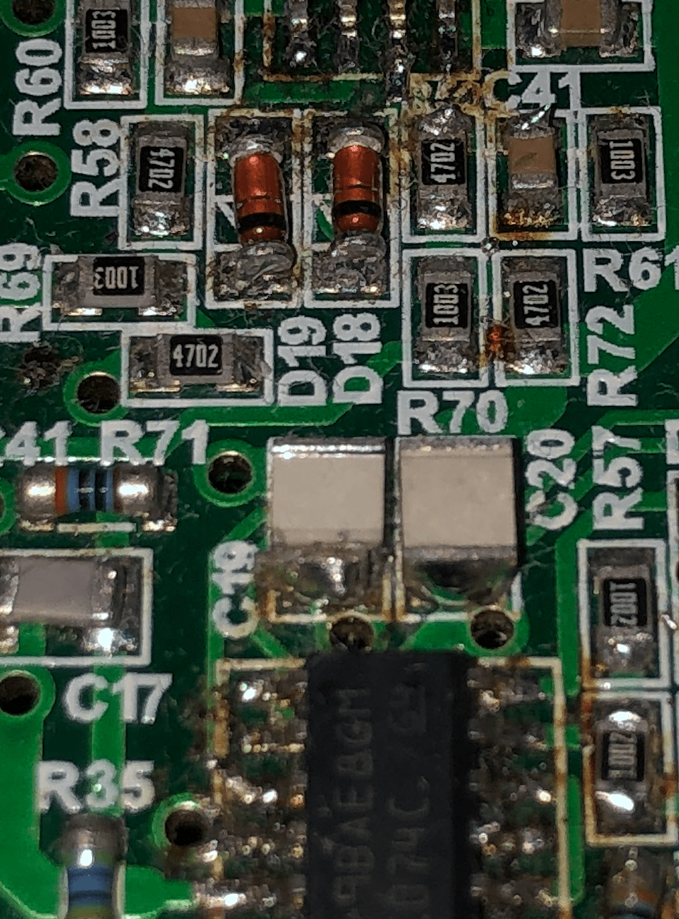

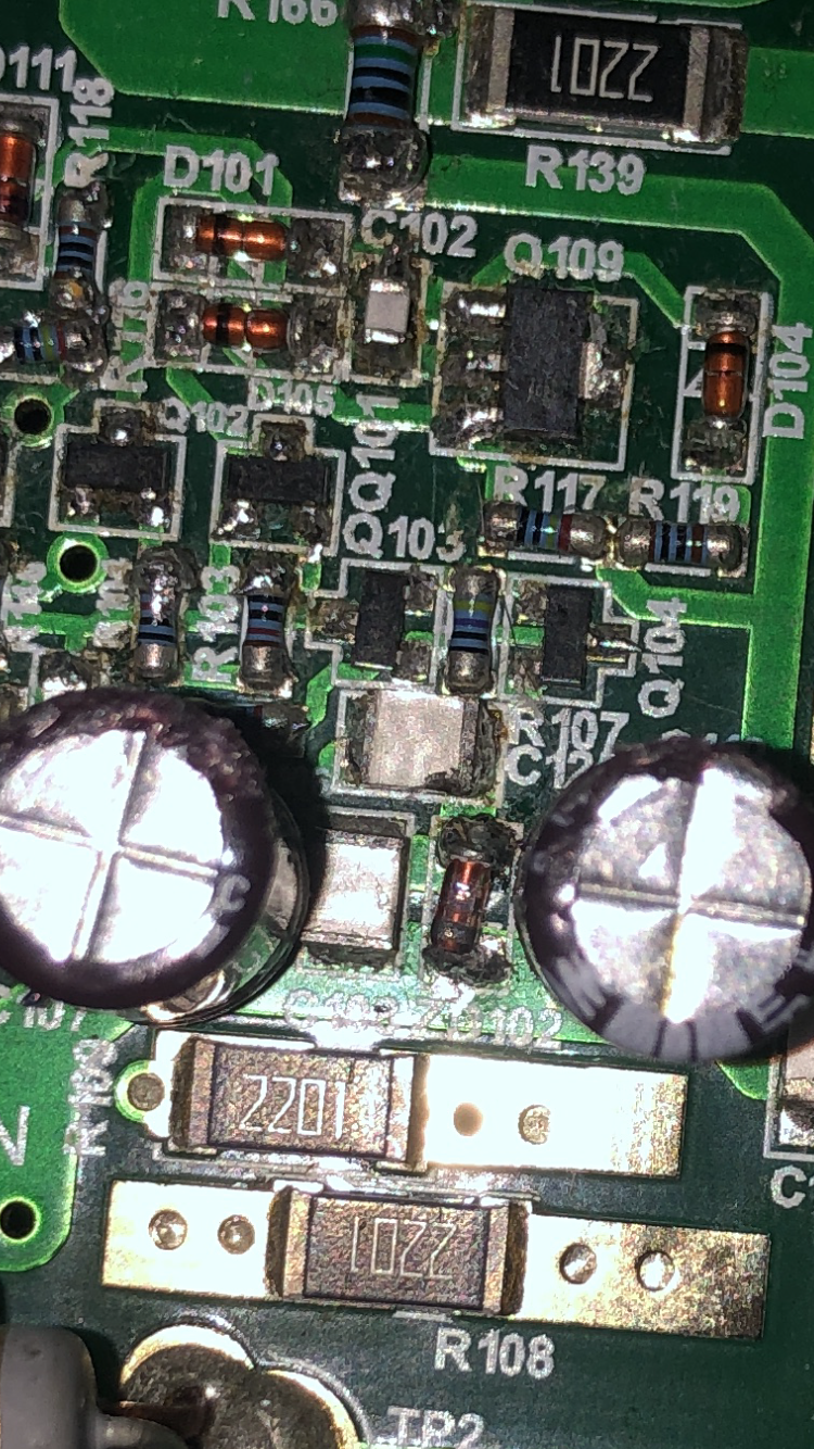

Don't know why you want to change input stage transistors. Are they burned up? Fail the double diode test? Make sizzling or popping noises? That left board has a bad case of burned flux, it appears to me. Alcohol & a good scrub come first, IMHO. If the board was burned through by some cataclism, no amount of cleaning will stop carbon from shorting out. New PCB required.
Low hanging fruit in a 20 year old amp is C107, C109, C111. Date on the drawing is 2005, not that long ago. Other high failure parts are zener diodes like the couple of ZD's you've got.
Yes, input transistors are selected for high gain & quietness. I found of a hundred On Semi TO-92's I bought for $9 in 2013 the gain was about 300 and the quietness put them right in the range of BC557C without the datasheet guarentee. Processes are more under control now than 1978. No hair or skin flakes in the fab area. No humans allowed except maintenance men in bunny suits. I haven't bought any modern oriental commodity parts. No knowledge if the clone fabs are as careful with such consistent product.
There are tons of surface mount transistors available. Digikey wasn't much help, the only single transistors that came up on the first chart were fet dies. However newark the selector table when set to bjt and 250mw to 800 mw and surface mount came up with hundreds of offerings. I tend to set Vceo >50 for audio products and avoid ones where the datasheet says switching transistor, but if the intended use is amplifier I wouldn't imagine an exact number match buys you anything. Gains over 100 should be economically available.

Total wasted effort. Transistor fail because of thermal cycles stressing the bond wires, and input stage transistors don't heat up. Some transistors are overstressed by too much leakage current from over-voltage. I don't see any sign of that here. Output transistors & drivers fail because too much current went out the speaker jack, likely a shorted 1/4 phone plug 1/4" out, or a shorted turn in a speakers coil, or an errant wire. Input parts fail in those circumstances because rail voltage blows out the base wires of the shorted outputs and drivers and blasts into territory where the voltage ratings are not that high. Filter caps and resistors go in the total meltdowns caused by shorted speaker terminals.
Higher gain input transistors lower the current required in the input jack from the source, a preamp, radio, mp3 player, whatever. I knew about the MPS8099 gain because I had to redesign an AX6 board to be compatible with a 1961 PAS2 preamp, that can source total of 2 ma from the plate of a 12AX7 vacuum tube. Most modern devices are 600 ohm drive, can source 25 ma. My most recent purchase, a QSC CX302, only has 6000 ohm input impedance in bridge mode. My modified AX6 board is ~100000 ohms.
Creek likely subjected the original input transistors to a incoming inspection of gain & noise. If you buy some from a distributor, you don't have the equipment to do that. If you buy some from some shady source, likely you'll get counterfeit, or at best pn2222 dressed up with a fancy number.
I use 1970 input VAS & driver transistors on a board in one of my amps. One side blew everything back to the input transistor, the other side everything but the output transistors was okay. No problems. In fact the 1970 drivers 2n5322 2n5320 had better sound than the TIP31c/32c I used as drivers on the blown side. Higher Ft. I had to go back and replace the TIP drivers with MJE15028/29 to equal the sound on top octave steinway piano and tinkly bells.

Edit, that brown crud all over the left PCB is a likely culprit for temporary mystery shorts. I replaced an organ that made rude noises about once an hour on humid days. 57 years of dust on those 300 v chassis, and I didn't want to spend 40 hours cleaning it. Moisture + dust = carbon tracks. If the brown is burnt into the PCB, call it a loss. Nothing dissolves carbon.

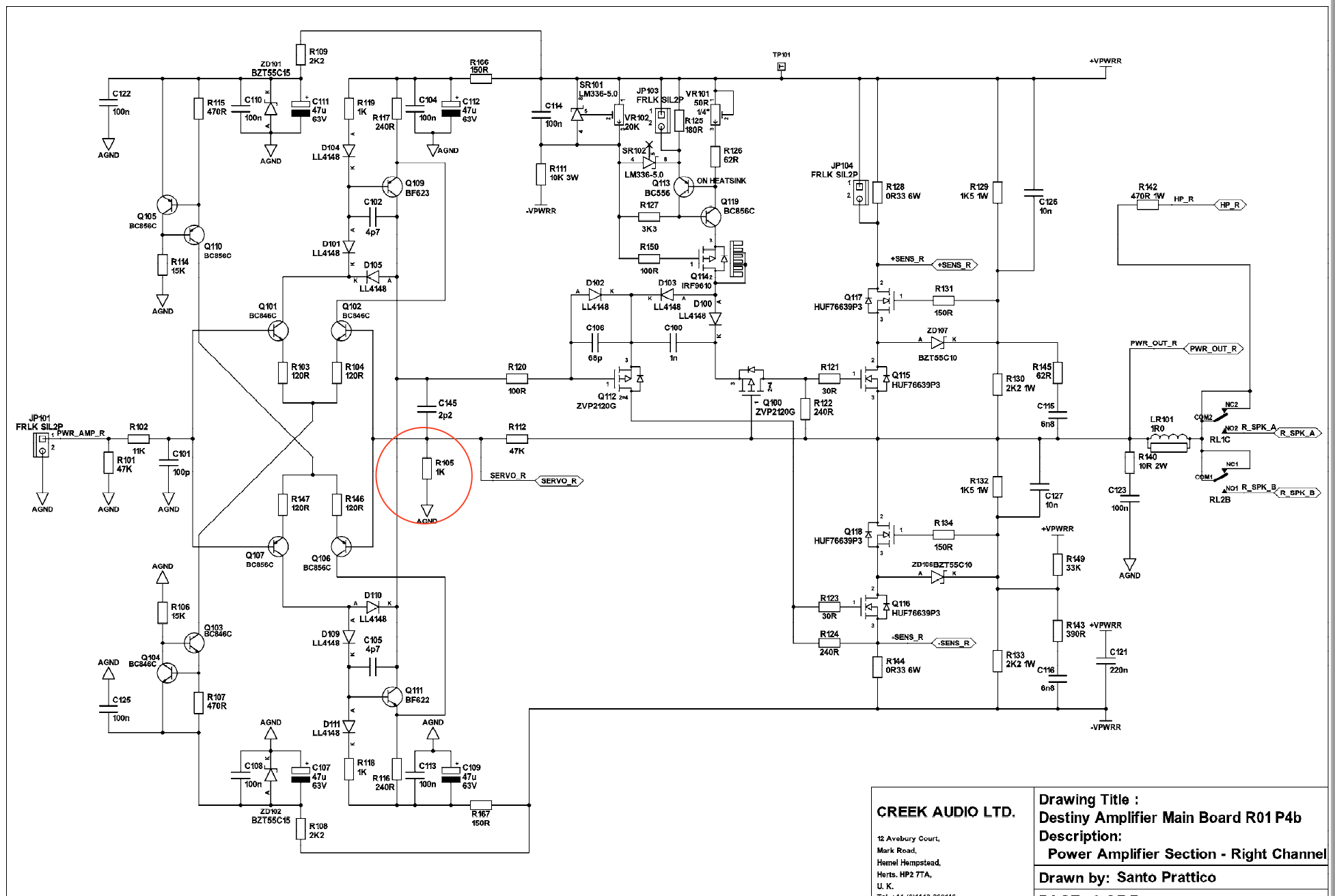

Is a fluctuating DC offset +/5 mV (within a few seconds) something to be concerned about?
Does voltage across R5 and R105 play a role in the DC offset for the respective channels? It looks like this voltage shows how well balanced each channel is.
As it turns out
R105 = 4-5mV
R5 = 1-2mV

I can't spot R105. If 5 mv pulse is getting out to the speaker jack:
I listen to soft music at about 1.5 vpp into 8 ohm speakers of sensitivity 101 db 1w1m. That is ~0.5 Vrms. db-=20log(v1/v2) so 20*(-2) =-40 db. 5 mv DC shift could be audible 40 db down from music. During silence between tracks the audibility would be worse.
R105 is in the red circle of the screenshot I uploaded. Thanks! 40 db down from soft music puts things into perspective! So its virtually inaudible. My concern is those fluctuations are from a failing component, or if they're expected with a dc servo.
