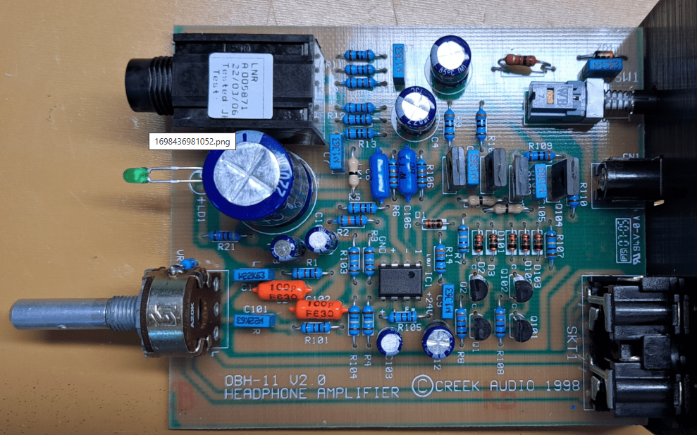

A great place to start would be to open it up and post a photo here, and determine what specific version it is.
Here are my internals. If anyone can help me put together a UK based shopping list i'd appreciate it. From reading this thread there are come caps and the op amp that seem to be must-do parts and other bits seem less important or more unnecessary depending on how the amp was specced in the first place.

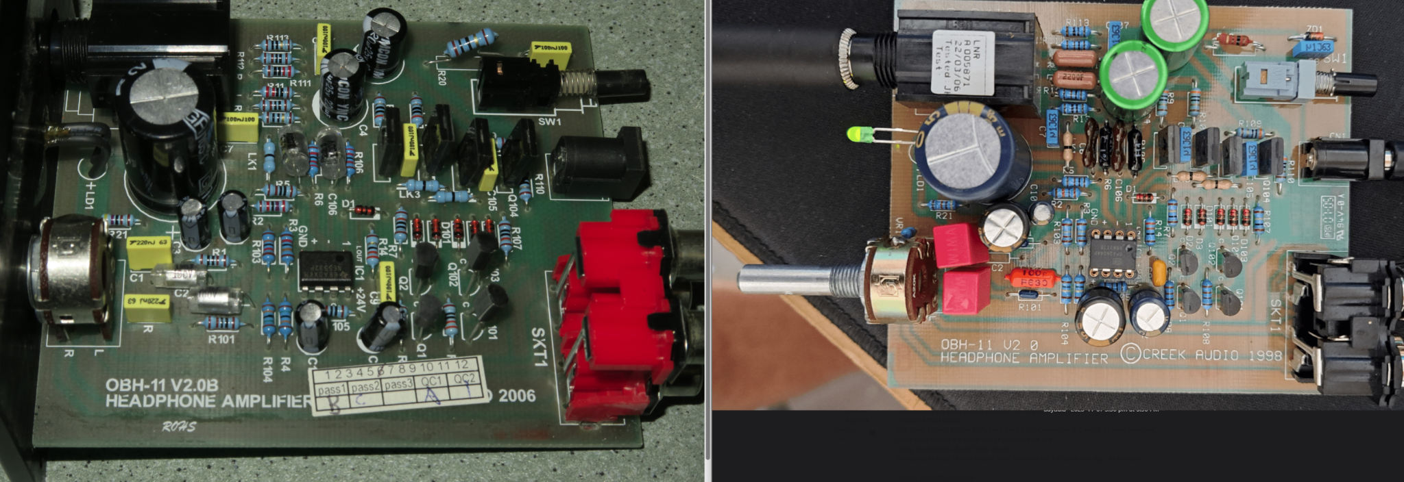

Its been awhile since I did this rebuild...but here is my board vs yours side by side.
It looks like all you electrolytics need to be replaced.
The op amp. This is not easy to find.
Several resistors and caps non electros need replacing.

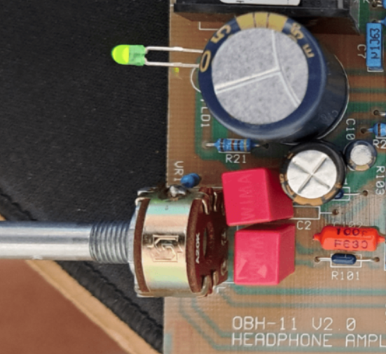

There is that small resistor from the outside of the vol pot as well on mine that was added.
I dont see one on your, take a look on the side not visable in the pix to see if its there or not.
Got the op amp from: Purchase a Burr-Brown OPA2604 from Michael Percy Audio.

You can look at my board before I did anything to it and compare to mind after the upgrades..
Use the stuff bigsky has posted etc...
And the schematic Alex has posted.

I certainly DO have the little resistor on the side of the volume pot, you can’t see it because of the angle of the image but it is there.
