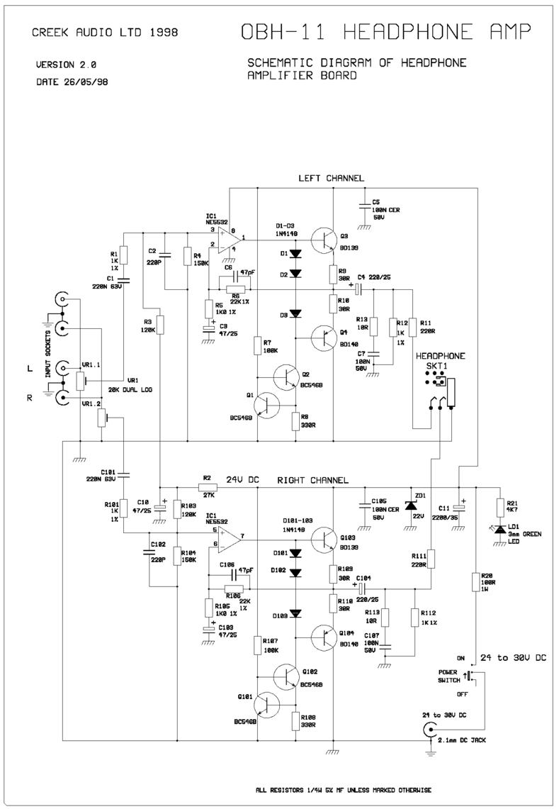

Anyone have a schematic for thie op amp version?
Thanks in advance.

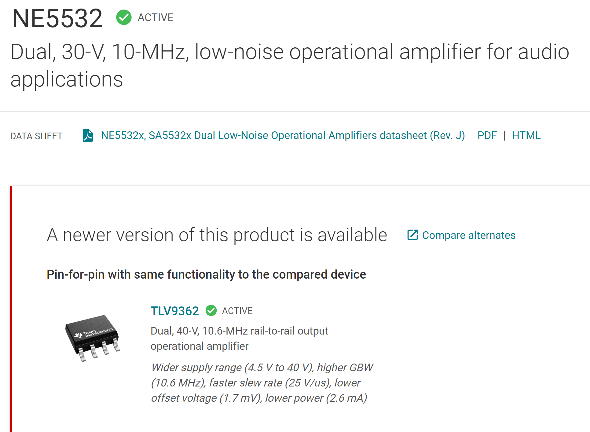

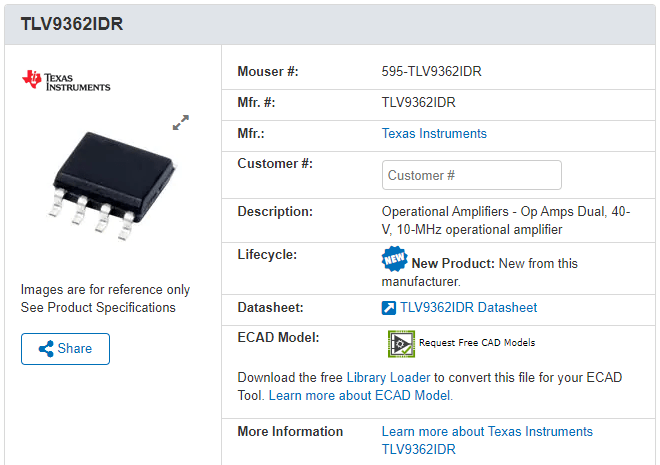

Here it is. And no, TLV9362 is not a replacement for NE5532.
Cheers
