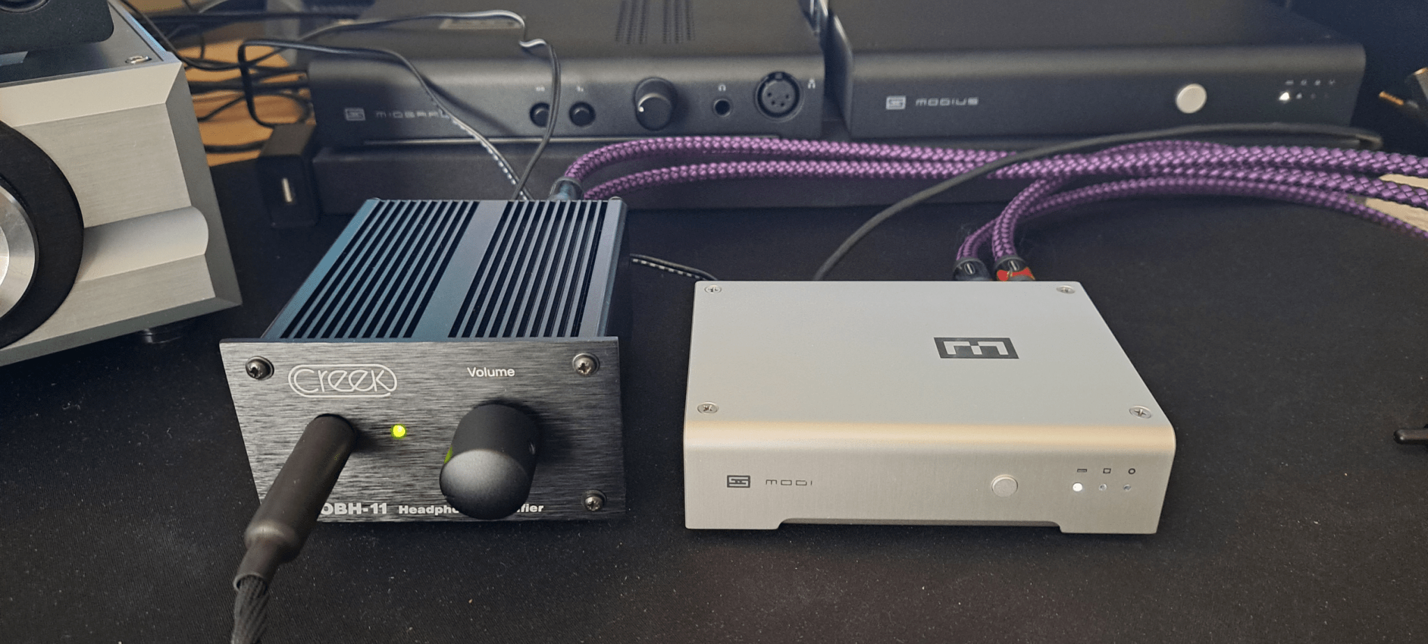

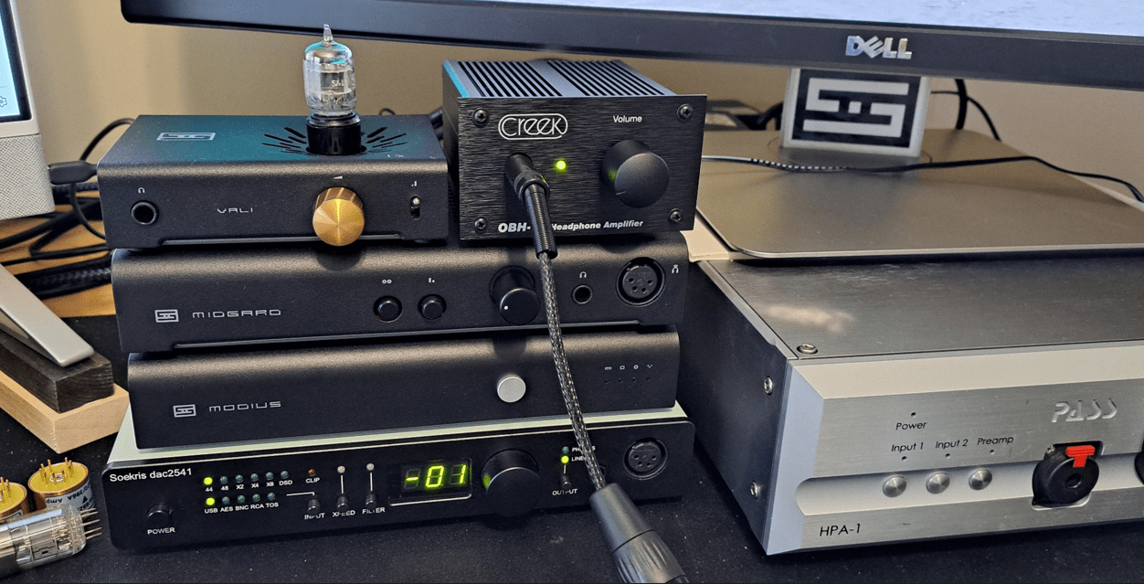

Over the past many years, MANY amps have come and gone....the OBH11, the first one, not the SE Class "A" one...I found on ebay...on a lark for somthing to do, I bought it, found Bigskyaudio and did all the upgrades.
To my surprise when listening side by side with amps costing MANY dollars more, with my D8000 Pros...the listening experience is just great...
Just to show you I indeed have the OBH 11 and do use it! Amazing how a relatively "cheap or low cost" amp fro years back still can provide listening pleasure.
Well worth the time and cost to upgrade the caps, resistors etc..
Alex
