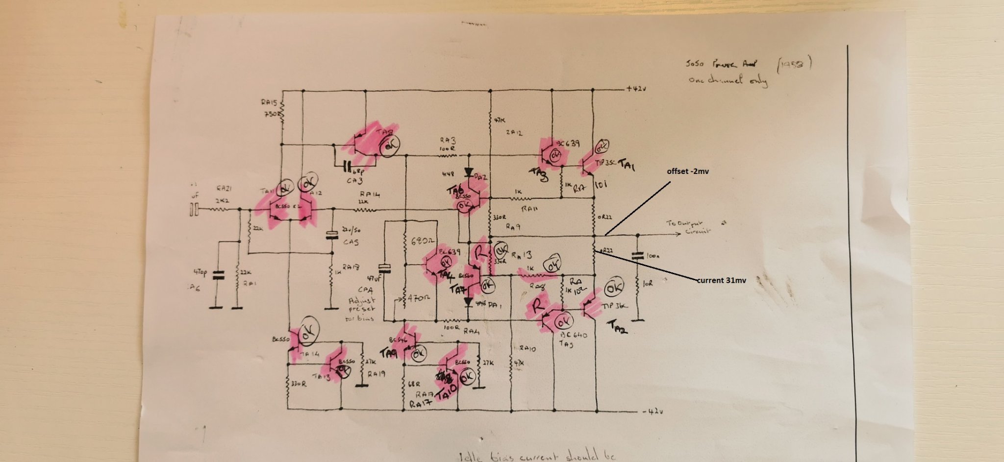

well those regulated rails are 25v, as i first suspected, the drawing is incorrect and if im right thats proberbly why it failed, the caps were only 25v.I uprated all caps to 35v
speaker terminals are at 0v
so just the bias, i assume it is done as attached
im realy not sure how to do this as i dont trust any of the drawings at all.references are nothing like whats on the board, some values missing, and components that are different
i have -14mv on one channel and +14mv on the other channel
ive not plugged any speakers in yet.

so all is not as good as it seems
found one of the drivers gone and stripped down the heatsink to see what was what and there is a flash point near the driver so i checked it and it was blown
now i have replaced it the speaker terminal has 68mv on one channel, so a bit more investigation required tomorrow
all of the output resistors are buried underneath the heatsink
biggest issue is i dont have an accurate drawing to work with and to work on it properly and safely you have to remove the transformer to turn it over

Check the supplies on the opamps as they will be lower than -/+25. The 25 volt is unregulated, the regulated voltage (on the opamps) will be something like -/+16 volt.

Offset is what it is but it should be low (again -/+100mv is a typical target value historically). It can be tweaked by transistor selection of the differential pair and trying different matched pairs.

I have one you did earlier, it's in the messages. Not getting any current readings across those 0.22ohm's.can I break the emmiter circuit and put a 1ohm in like I do on the other amps to do the current? I presume the principle is the same. I don't realy trust the drawings TBHOffset is what it is but it should be low (again -/+100mv is a typical target value historically). It can be tweaked by transistor selection of the differential pair and trying different matched pairs.
You'll probably find its not that horrendous to work on once you get into it and do a bit of dismantling.
Have you got a simulation for this one? Can't remember if you have or not 🙂
You can add a resistor but the 0.22 ohms are perfectly good enough. If you have no voltage across them then you have no current flowing. It doesn't really need proving by other means.
I would begin by looking at the voltage across TR4 (on the hand drawn image) and checking it increases as you alter the preset. You need around 2.5 volts across that transistor to begin to turn the outputs on.

The simple answer is that either 0.22 ohm in a given channel can be used as they are effectively in series. So whatever you read across one resistor should be similar (although it won't be exactly the same) as the other.

so ive set the bias on both to around 31mv, so thats not a probel.I did find another transistor gone, but i still have this -68mv on the right speaker terminals, the other is -14mv
would you be happy with such a difference?
would you be happy to plug in with these figures?

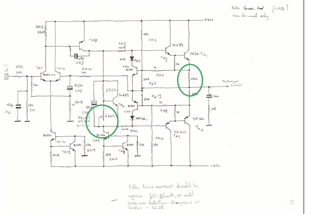

31mv across 0.22 ohm is 140 milliamps which is on the high side. An ideal current would be just over 100 milliamps but even then commercial constraints sometimes come into play and the recommended may lower still. I doubt you would hear any difference between 10 milliamps vs 100 milliamps.
So I would turn it don a little.
68 millivolt offset is perfectly fine. The current that causes to flow in an 8 ohm speaker is just 8.5 milliamps. If you swap the two transistors around in the differential pair you might find it makes it lower (or higher... you can't tell until you try).

It sounds to high and to hot to me. Is TR4 in thermal contact with the heatsink so it can sense temperature and reduce bias current?
I would begin with a low value, say 10 millivolts across the 0.22 ohm which is 45 milliamps and see if the amp holds that value. If it rises then keep bringing it back down to 10 millivolts by readjustment.
Once it is steady then switch off and let it cool.
When cool switch on and see what the cold voltage is across the same 0.22 ohm. As long as it is a couple of millivolts or more when cold then its fine.
You will have to re adjust in the same way when finally on full mains.
The switch issue shouldn't directly affect things but its hard to say without seeing it all. If you have speakers connected then any sudden transient may draw current and light the bulb. Without speakers and I can't see how it could do anything really. I suppose we could really do with knowing how the switch is wired and what it actually does electrically. Bridging mode usually inverts one channel but does so at the power amp input (usually).
If the bulb stays lit when you operate the switch then I would say not normal, if it gives a flash then it may be fine.

The first 5050 schematic that you posted did describe the bias as 30-35 mA so it was sensible to observe that but did you reset it cold or after warm-up? If the bias keeps rising, it suggests you may need to reset it later, after warming up, rather than when cold or below normal operating temp. range.

so i let it go cold, turn it on and the current was +40mv so i have lowered it to 11 for now, and will re adjust once fully warmed up, say 10 mins

You have to be confident the amp is all OK before going to full mains. 11 millivolts is 50 milliamps so see what what it rises to when fully warm. In many ways setting the bias toward the lower end of what is acceptable is often better on commercial amps like these. Remember that on full mains the current may be higher and so will need tweaking back down.
