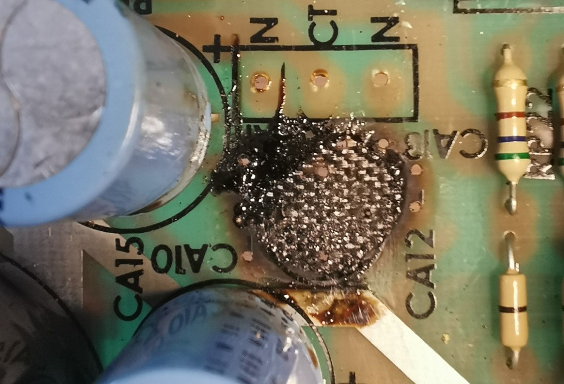

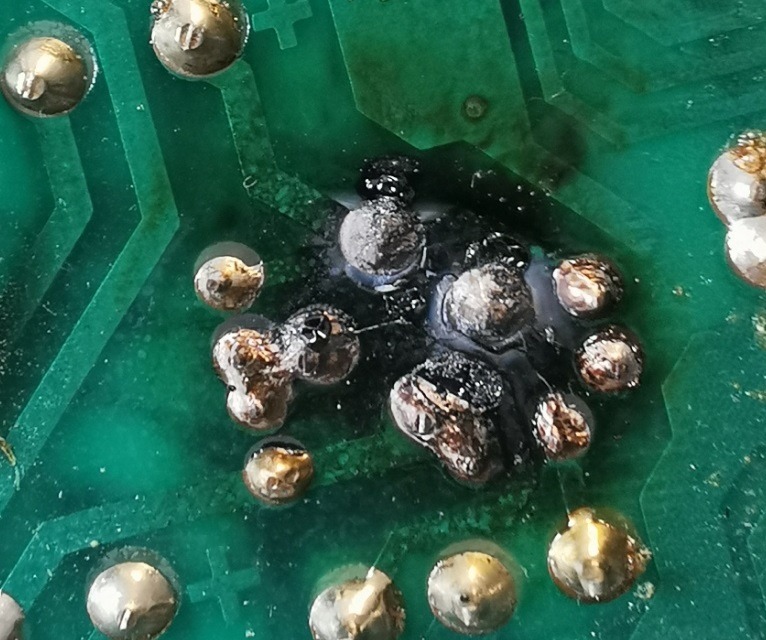

so im trying to investigate this 'lamp on' 'lamp off' senario
First thing is it only does it in intergrated mode(switch out) and with the mute switch out
If you oput it into 'split' mode and the mute switch (SW9) depressed the light never comes on, except for the usual few seconds of charging the filter caps
first problem is there is no drawing showing the pre amp/power amp split
the bridge mode switch is sticky though, but i cant see why that would be part of the issue, but without out the drawing its hard.
depress these switches in and out while the amp is on and the lamp stays off regardless of where the final positions are
one thing though i did monitor the idle with this all going on and the current is about 165mv with the lamp on, depress the switch in and out and it goes back to 11mv where i set it.

I can't begin to guess at that without knowing what the switches do and what configuration changes it makes to the amp.
This might help you figure it all out though.
1/ Bridge mode usually inverts one channel (180 degree phase shift) and the load is connected between the two outputs. So as one side goes 'up' in voltage the other goes 'down'.
2/ A parallel mode would place both outputs in parallel (usually with low value balancing resistors). Any difference in output between the two amps (such as different offset voltages) means they 'fight' each other with one side trying to pull or push current into the other. If both outputs are identical that can not happen.
So if the bias current alters in one mode then its possible the two channels are fighting each other but without details of what really happens it is all guesswork. We need to know what each switch actually does and what all valid combinations are.

not sure if this is relivent, but when the lamp is on its flickering quite violently, not just on and a stable light
the bit i dont get is when either switch is depressed, the lamp goes off and stays off.
You have the means to find out 🙂not sure if this is relivent, but when the lamp is on its flickering quite violently, not just on and a stable light
How many switches has it got in total. I see Mute and you mention 'Split and Integrated'. Is that one switch for split/integrated?

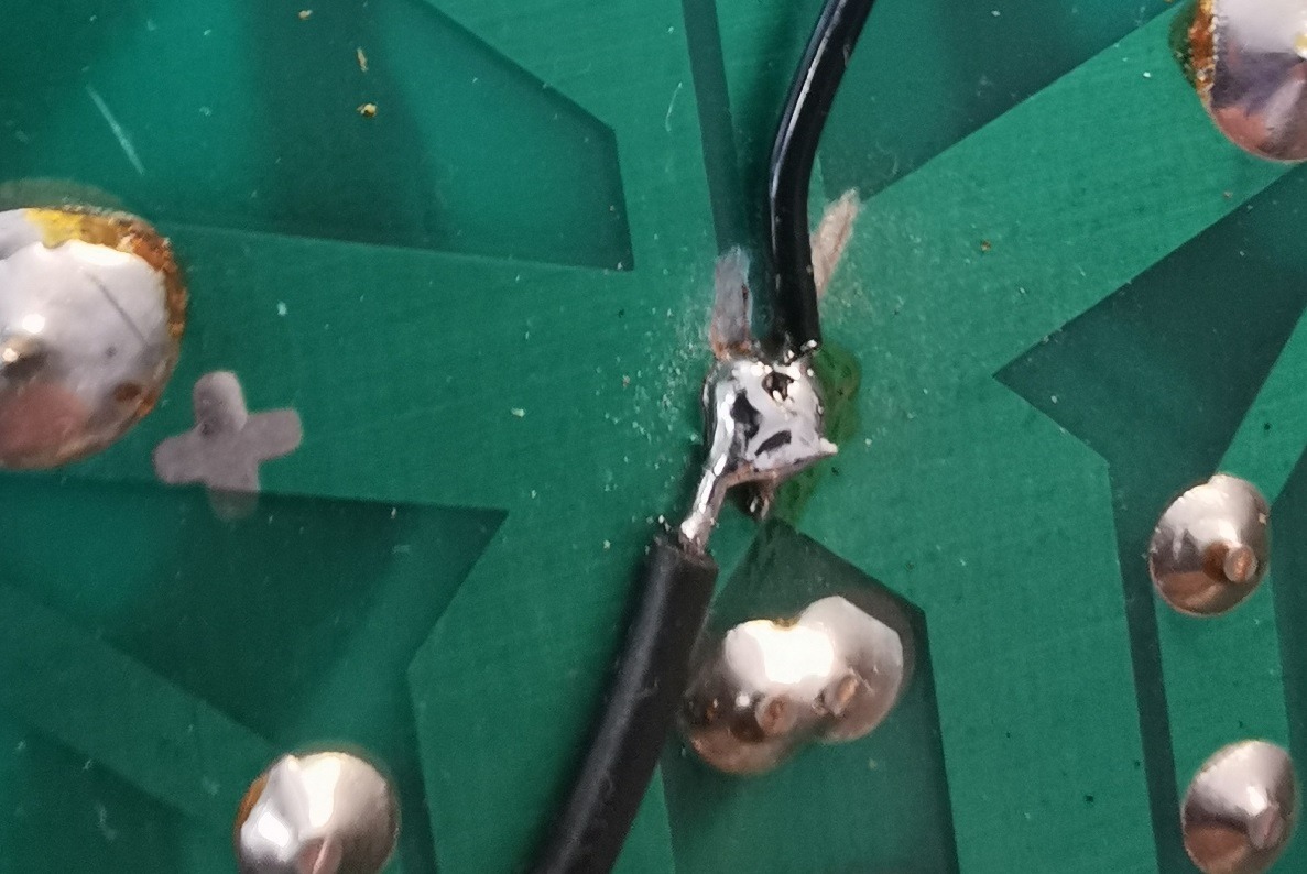

The lamp lights because the amp starts drawing current. So think why!
You could use the scope to look at the power amp inputs and see if they are getting something unwanted on them .
You could try adding a link here to short each channel input to ground. Do it before the coupling as shown here. Does that stop the bulb lighting?

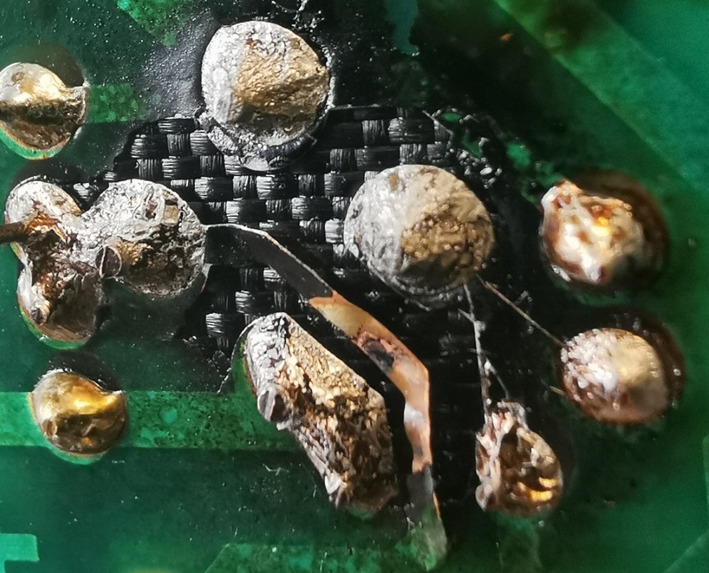

(could the switch be doing some weird like shorting a supply out and that is what zapped the resistor and bridge ? don't overlook anything. Get it with the lamp lit and then pull the mains plug out and see if you can measure any short on that resistor that burnt up)

You said this which doesn't sound normal at all tbh. A flick of light is one thing but pulsing needs investigating. It is possible it may all behave normally on full mains but I would want to be sure first and that means trying to find why it does what it does now. If you short the power amp inputs we can say for certain that its nothing from the preamp section doing this, or at least nothing upsetting the power amp inputs. That is the first thing to prove or disprove.
lets say just for a moment nothing is wrong, and the reason i say this is
with it plugged into the lamp tester and monitoring the idle current it goes to 160+mv untill i press the switches
if i touch nothing, unplug it, leave it for 1 min, then plug it into the mains, the current is 11mv, and no matter how many times i turn it on or off, or push switches in and out the load does not change, yet when i plug it back into the lamp we go back to where we were.
so if everything is ok, what could the lamp be doing to the amp?

It really is impossible to say without further tests...
Work with something 'real' that you can measure.
So the question is whether it is a short glitch that occurs when the switch is operated and the possibility that the amp in some way locks up in an invalid state because of that... meaning there is no real issue when on full mains.
You either have to find the reason why it does with the bulb (even if there is no actual fault as such) or just try it on full mains and see if it behaves.
The joys of fault-finding and the decisions to take 😉
160mv across 0.22 ohm is 0.72 amps. That is a lot and with the bulb lit it means the rails are going to be low.with it plugged into the lamp tester and monitoring the idle current it goes to 160+mv untill i press the switches
