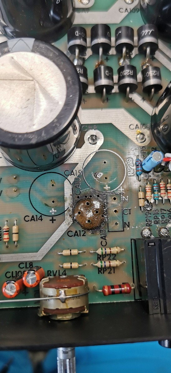

before I start the replacement procedure in such cases the question rises up, why was happen this.Just received this unit that isn't working.
Just says 'not working' on it
Anyway plugged it in and it started to smoke-rectifier melted and the left cap is very swollen.

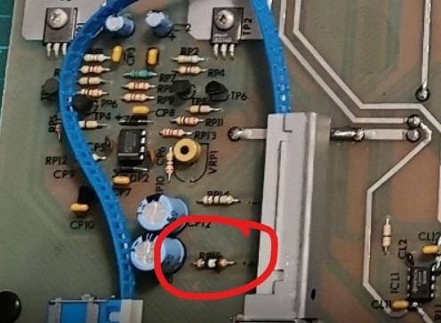

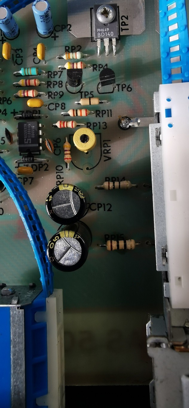

According the images from post #9 it is for me clear, why; because the choice fell on weak versions for rectifier and electrolytics.
If the failure had occurred suddenly without previous permanent thermal stress, PCB area around this parts would not have been burned black.
In this case had been preceded by long-term thermal stress - thus it is not desirable to preserve the original condition.
This small round bridge rectifier I would replace by 4x 1N5408 without shorting the leads. Additional important is to remove the terminal block CTB2202/2 and replace by solder legs.

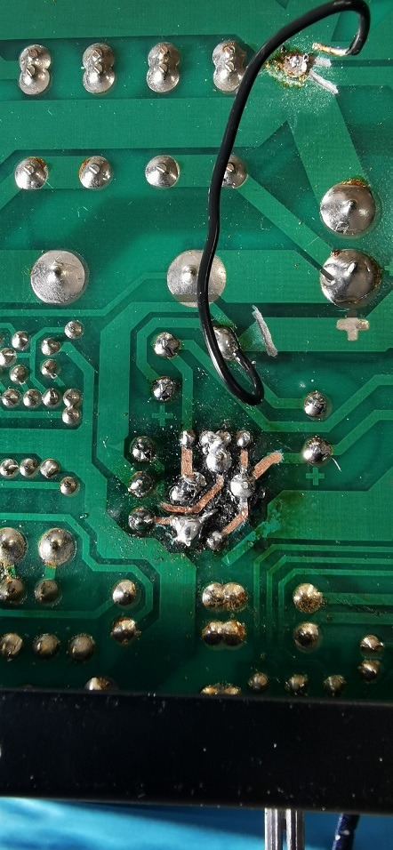

so here we go
i laid down an epoxy bed ontop and re drilled the holes for the new rectifier
i managed to re lay most of the old print, apart from one pice that was too far gone, but managed to connect the rectifier leg direct, and this gives it a bit of strength back.

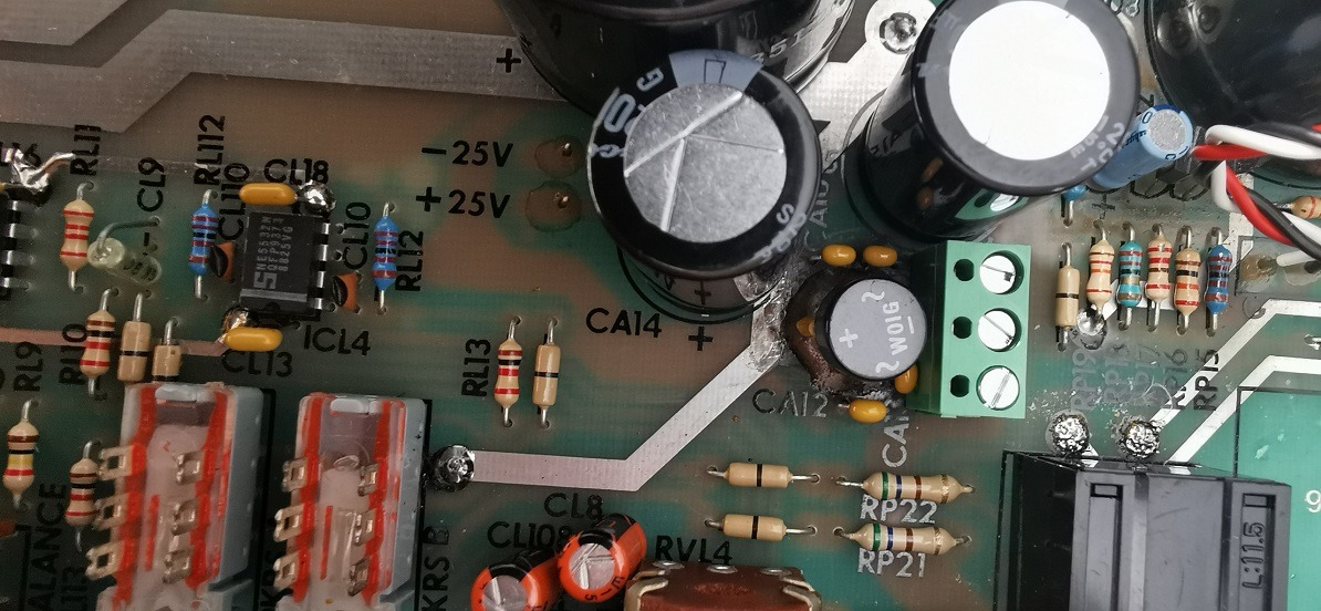

new filter caps uprated to 35v(not the main ones)
new ceramic caps uprated to 100v
new uprated rectifier uprated to 100v
new uprated caps and 10ohm resistor where it was burned
new connector block
looking into ways to fit the watchmen fuses but there isnt alot of room TBH

Well that sounds promising at this point and that looks an excellent repair of the PCB.
I would check that the supplies (particularly the regulated rails) are all correct now, check the opamp outputs are at zero volts DC and check the main amps offset is zero.
If all seems OK then give it a listen. I know you will check the bias current 😉
