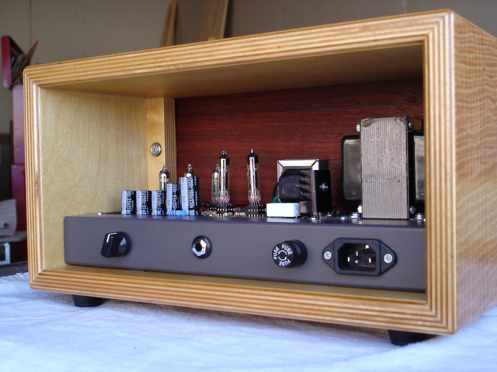

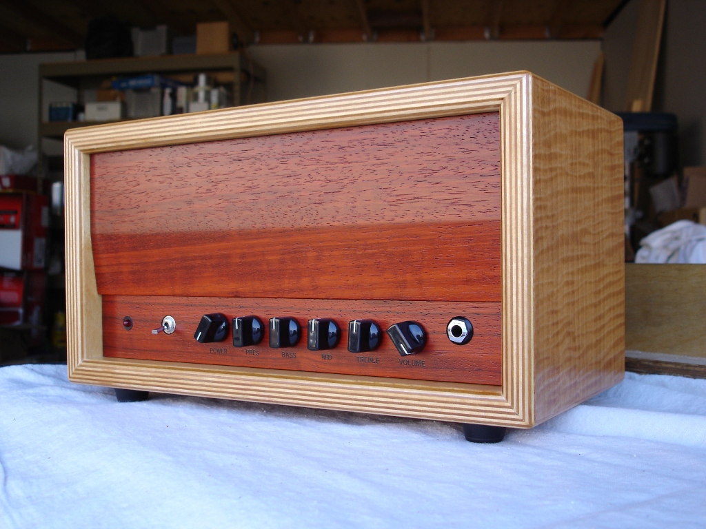

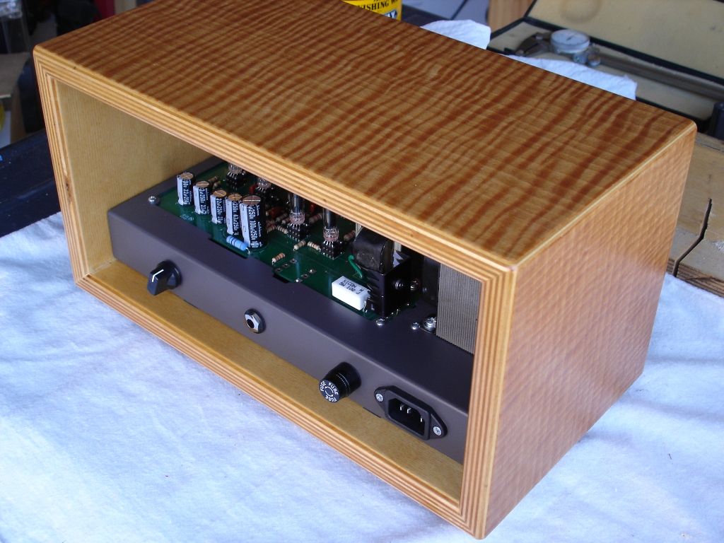

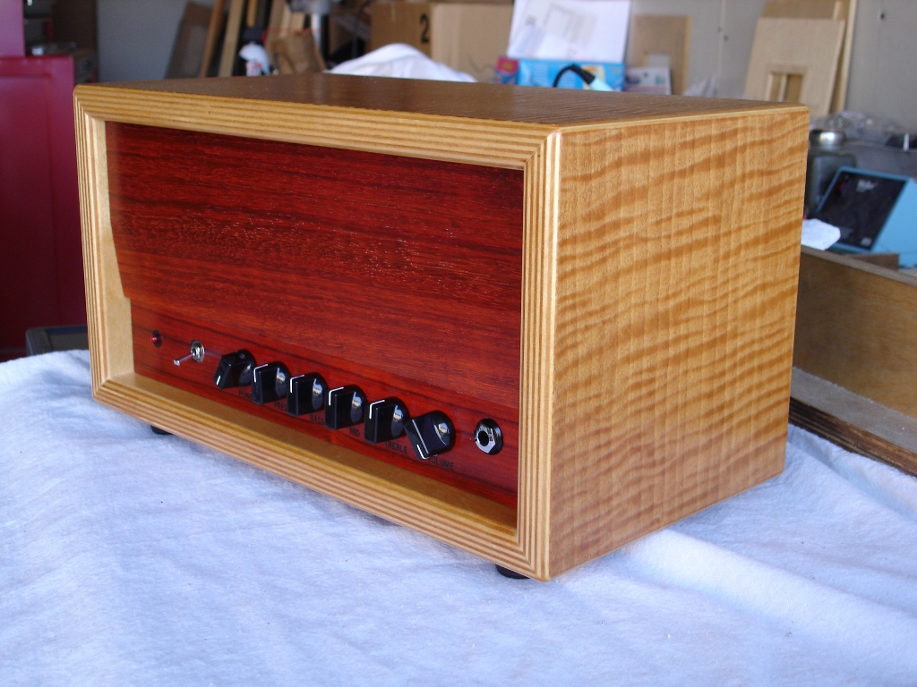

If you use baltic birch plywood, show it off. I did this on one of my guitar amps I built. The flat areas are anigre veneer. The finish is natural Watco danish oil with Minwax finishing wax after the oil has cured.
