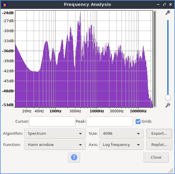

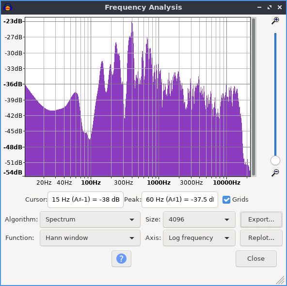

Here is how one of my SP2(2004) are performing on white noise in my music room. Microphone on axis 2 m from front with speaker 1 m off floor, zero and 25 cm from hard plaster wall. Response from 20-40 hz probably augmented by a diesel sewer pump 3 km away. Missing response above 15 khz is above limit of microphone. Non-gated sample ~1second long.
