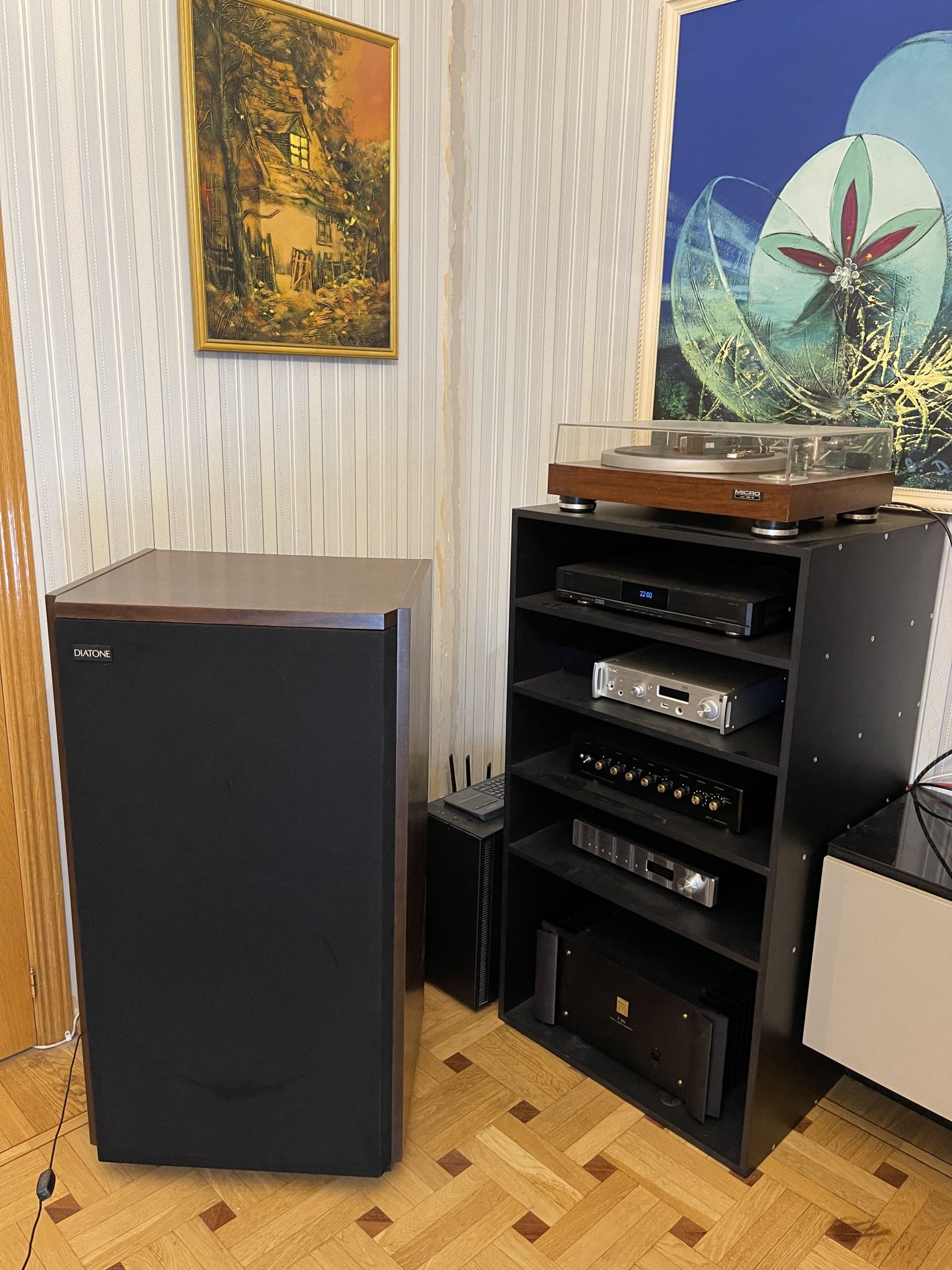

Believe it or not, my listening room is only 18 square meters. 🙂 And the amp I'm currently using is Threshold T200. Here is a photo of my system ():
I have no experience with such loudspeakers, but i would suggest looking at troels gravesen's projects with 15" drivers. If i remember correctly you want to use valve amp, so 4 ohm version in series (resulting in total 8 ohms) may be sensible.what speakers would you recommend to use?
