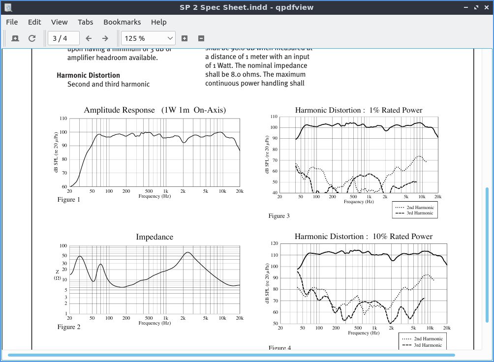

I bought the speaker that maximizes simulation of musical instruments in my market. I tested mine with piano CD track, comparing to sound of actual Steinway grands. I own a Steinway console in next room to the speakers. No Dunlavy speaker for sale here, obviously. The only other speaker here that sounds that good is a Meyersound at Brown theater. A speaker the size of a Fiat Urbana car.
See HD chart for my speaker @ 1% full power, or 5 watts. 2nd & 3rd harmonic <20 db of emitted sound. That is louder than I use them 99.9% of the time. My measured voltage at normal volume is 1 Vav or 1/8 watt. Again my home amp maxes out at 140 w both channels driven. I have a 800 w amp for performances in halls.
If I was going to spend $14000 on a speaker system, I would rather spend $18000 on an actual musical instrument. I/ve been eyeing a bassoon for $18000.I played one with skill ending with graduation in 1968. I have never owned one.
As for diy, my pair were stolen 9/20. They had pawn shop value. I bought drivers to replicate them in a case so ugly it would have no pawn shop value. Since after a 15 month search I found used ones at 2/3 what I paid originally, that project is waiting on replacement of the power saws, clamps, tools etc the burglar also stole.
