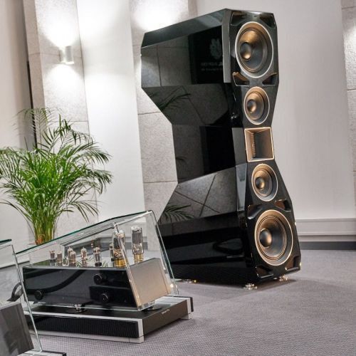

I need your help again! I currently have a Diatone DS-90C system. These are very large and heavy speakers.
Not long ago, I was talking to a friend of mine who builds his own speakers. And I love to do everything myself. And I got hooked on this idea.
I've studied various speaker layouts and settled on D'Appolito speaker placement, but I want to go a little farther. I want to have the same wide bass range as my existing speakers.
I want to make the following layout (bottom to top):
1. Subwoofer at the very bottom, with a diameter of 18 inches, and with a frequency range of 18-20 Hz (yes, I know that there are few such speakers, but my diatons have speakers from 20 Hz and I don’t want the new ones to be worse) - I can't decide on a brand
2. midrange and woofer - I can't decide on a brand.
3. midrange speaker - I can not decide on the brand.
4. tweeter - I will be using a Viawave GRT-145W-8.
5. midrange speaker - I can't decide on a brand.
6. midrange and woofer (I don't know how it will be in English and the mid-range and low-frequency speaker in one case 🙂) - I can't decide on the brand.
I really need your help in selecting speaker models. Can you please advise which speakers should I choose to make them sound better than my Diatone DS-90C? I know the project is crazy. Instead of a passive crossover, I will use an active crossover, I have not chosen it yet. I will design the case myself, taking into account the parameters of the selected speakers. I really need your help.

And at the expense of the subwoofer, I suggested: Subwoofer - mid and low frequency speaker - midrange speaker tweeter - midrange speaker - midrange and low frequency speaker. Now I'll draw a picture, my English is very bad, and perhaps I didn't describe my idea well in the first post.
Hi Vetusto,
That link does include the text: "Playback frequency band: 20Hz-20kHz", but that isn't really the most important info. That's because they haven't defined what they mean by that term, eg they haven't said "+/-3dB" which would be one of the more common tolerances for a loudspeaker frequency response. The more useful info is the graph of the frequency response, which shows that the level is about 20dB lower at 20Hz than in the main part of the response, and we don't normally consider -20dB as being the normal, useful part of the response.
Nevertheless, you have given us a useful point of reference, in that we now know the level of bass extension you're used to.
As to your proposed layout, I think something like these are what you mean? (apart from any sub you may decide to add)
https://heissmann-acoustics.de/en/dxt-wave-fusion/https://heissmann-acoustics.de/en/dxt-wave-xl-fusion/
These are generally well regarded designs, so if you don't know enough to design your own project from scratch, they'd be a good place to start.
Hope this helps,
David.
PS, don't worry about your English, it's far better than most native English speakers' efforts at other languages!

Thanks David! 🙂As to your proposed layout, I think something like these are what you mean? (apart from any sub you may decide to add)
You may call me a complete idiot, but I want to do what I have in mind. What is the right way to say this?... I have an idea to make a WOW speaker system, and I really want it to be exactly like this, with a huge woofer and according to the D'Appolito scheme. 🙂
I can not use a subwoofer, but take a woofer, midrange speaker, tweeter, midrange speaker, woofer.
But in any case, the woofer must be huge and then you need two of them. 🙂 I don't know how to put it. I just want it. Let me step on a lot of rakes, but if I choose the right woofers and midrange speakers, then if the first project does not work out, I will make a new one with these speakers. The case is easier to make and much cheaper than buying new speakers. Therefore, I ask for help, to choose the right midrange and bass speakers.

First do you have experience with loudspeaker design? If not i agree with David Morrison, Heissmann's loudspeaker garanty you'll have a listenable outcome.
But to answer your concern about bass here is my view:
Rather than the bandwidth extension i would focus on sd ( membrane surface): your Diatone use 18" as low way up to 350hz.
So i would be sure that you have at least the same sd ( in the vicinity of 1200cm2) up to 250hz.
This could be one 18" but 2 x 12" will give roughly the same sd too, so it could be the first woofer pair within your stack. It could better the behavior of your Diatone regarding directivity too as an 18" playing 350hz is a bit of a stretch in the upper end regarding directivity.
For the sub way i would go sealed and with 2x 18" in 'dual opposed configuration' to cancel vibration the driver generate. Might seems overkill but the lower you want to go in freq the more sd you need and if you want to lower the bandwith to 20hz/25hz you can trade spl ( max output level) for lowering the bandwith thanks to a Linkwitz Transform (but only sealed, a vented box ask different approach).
I would make the sub with it's own dedicated box and with a crossover frequency around 60hz as it'll allow you to locate them in room where they sound the better which isn't necessary the place where your loudspeakers are good for stereo and/or mid high.
If you are experienced and keen to experiment with new approach you could think about an 'Horbach-Keele' principle implementation but it'll require some specific gear and approach ( it ask for FIR filter, multiamplifier, multioutput dac or dsp...). But If this is your first build forget about this principle.

O! I can answer all these questions! 🙂
1. Yes, I want to move around, not sit in one place, which is why I chose the D'Appolito formation scheme.
2. At the expense of sound pressure: I have a Diatone DS-90, there are huge woofers, and they pump air even at a very low volume. It's like a built-in subwoofer. This is infra bass sound. This is exactly the sound pressure I want.
3. No, this is not a home theater, this is a stereo system for listening to music of any genre, from the Grand Symphony Orchestra and jazz, to the worst underground rap. But sometimes I watch films, and of course my acoustic system works wonders in films too.
4. Budget... This is a very difficult question. I have about 2700 dollars. And I plan to do this project for about one year, during this year I will be able to collect money and invest in this project. I can buy speakers not all at once, but in several stages? ... Right?

ok, that doesn't necessarily relate to d'appolito configuration as far as i know.Yes, I want to move around, not sit in one place, which is why I chose the D'Appolito formation scheme.
you will need a wide (horizontal) dispersion for the drivers in their respective pass-band.
ok, i was referring to a dB number. this will define what drivers and enclosure you need.This is exactly the sound pressure I want.
One usually picks the box size from the fs & vas of the bass driver. As the wavelength of 20 hz is 440' or 146 m there is not any point in having two 20-100 hz subs in any room narrower than that, the ear will not resolve the position. Besides most inexpensive electronic crossovers merge the two sub channels into one. (for example a nady cx-22sw crossover that I picked up for $50). Also the sub is heavy so building it into the same enclosure as mid-bass makes the system expensive to move.
To pick a sub driver you need to decide how loud you want for how many people in what volume room. That tells you how much wattage a driver you want. For example, in my 4.3 m w x 3.2 m h x 11 m long room I find 50 watts into a 98 db 1w1m speaker produces as much sound as I want to hear (without ear damage).
If you are driving a 33 m w x 10 m h x 100 m long room full of people, you may need a more like 500 or 1000 w driver. A driver listed as suitable for 20-100 hz I have data on is the eminence lab15 https://www.eminence.com/speakers/speaker-detail/?model=LAB_15 which has FS 28 hz Qt of 0.35 and Vas of 103.6 L . ThIs Qt indicates vented enclosure (below 0.4) . To get f3/fs (20/28) the f3 factor is 2, so the box has to have a volume of 2* Vas or 206 L. David B Weems suggested miinimum port size for 15" driver is 12 cm. His chart for 10 cm ports stops at 150 L and lowest f3 is shown at 25 hz for port length 15 cm. So there is a reason to put this driver in a separate enormous box.

If you are decided on this kind of layout i would go heissman. This is not going to be easy built: large loudspeakers have specific needs in term of realisation and i would hesitate to do it as a first approach.

You're right. Nearly. But I want not such terrible acoustic systems.. 🙂 I am a perfectionist. And the shape will be magical, I hope. I'm still experimenting with the form.Smaller? Hmm you are contemplating some huge speaker build!
Something in the same vein as Dunlavy SC VI. Not really earbud size.
Here is an almost standard design:
