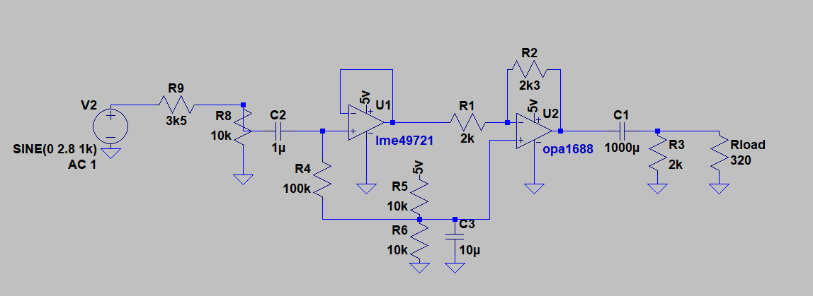

lme49721 non inverting amplifier any suggestions ? I tried to make my own design but it is making lots of noise.
By itself, the lme49721 is too weak to serve as amp, you need an output buffer.
Here is a suggestion for an usb powered headphones amp. It is tailored for a 2Vrms input and 4.5Vp-p output. If the input level is usually lower (like 1vrms), R9 can be reduced or deleted and R2 adjusted to provide the required gain.
R8 is a 10k log pot as volume control.
Obviously missing are decoupling caps, an input filter (a simple cap to gnd after R9 would do).

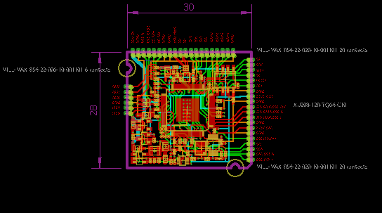

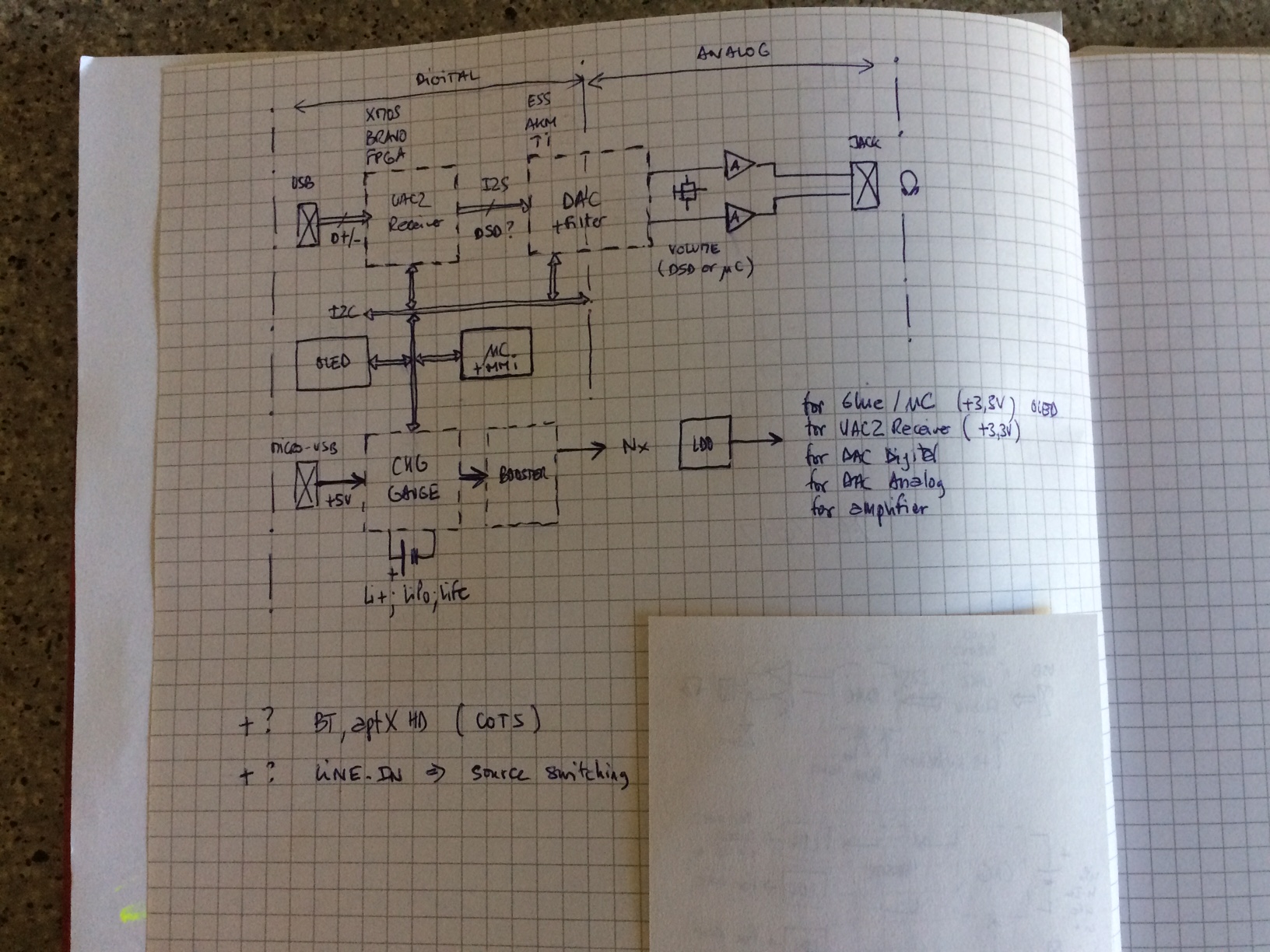

I´ve attached block diagram then I´m working on similar project:
- own stamp sized UAC2 receiver based on XMOS XU208 (under test)
- own stamp sized PCM/DSD DAC based on AKM AK4490 (in progress)
- COTS chinese aptX HD receiver (waiting for CSR8675 availability)
- Line levet input
- volume before Class A amplifier section
- microcontroller for UAC2 receiver, DAC configuration, Charger and gauge control, OLED visualization
- Lithium batterie with 5000mAh
- one booster and Nx LDO´s
- mostly SMD components
I´m using successfully EAGLE (evaluating today new version).
JP

Sorry for the OT but.. JP: do you plan to also provide for I2S to USB on your board or only USB to I2S ?
