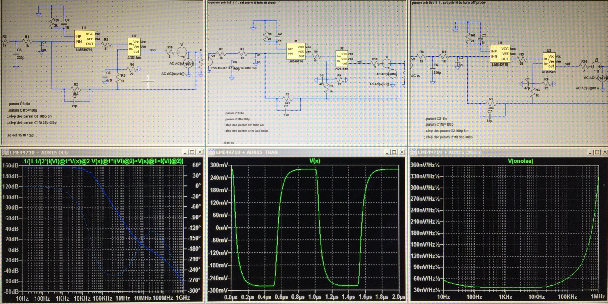

Yeah, inverting, gain ~0,1-0,2.
Still experiment with TPA going fun so help me to run it from usb .
AD815 works from just 5V total supply. Probably need to run it inverting though as the input common mode range won't permit a 3V swing.
If you don't like the look of AD815's largeish package, there's always AD8017 which also is quite happy at 5V.

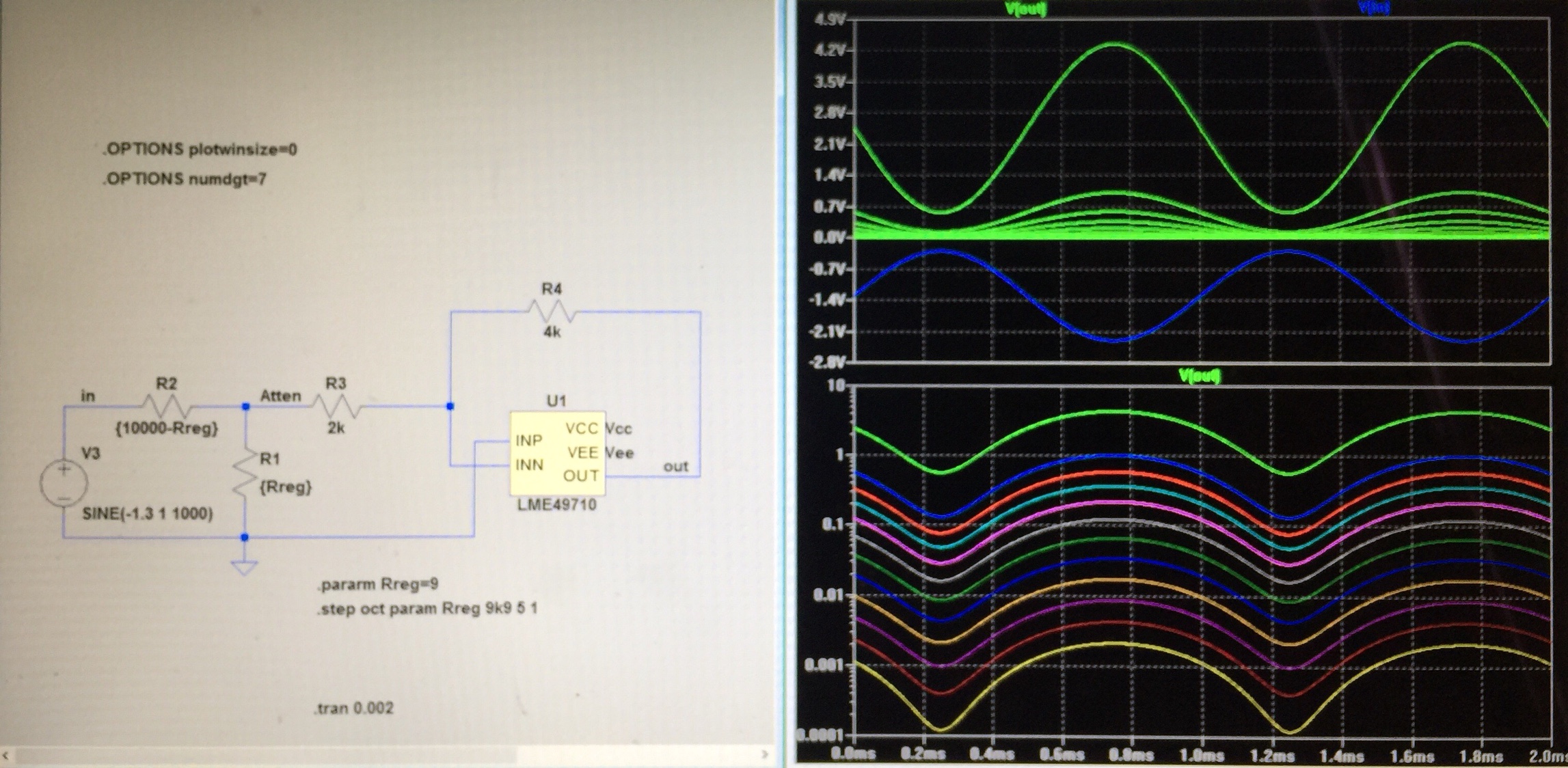

You could do it this way if you really want everything powered from usb: pcm2707-i2s-pcm5102-potentiometer-lme49721 as buffer-opa1688 as output.
The pcm5102 has a 2vrms output centered at gnd so it's not putting any dc on the pot. 2Vrms (5.7vp-p) is too much for the usb powered opamps, so you need to reduce it down to at least 1.5vrms (4.25vp-p). Easily done by a resistor ahead of the pot. The lme49721 has rail to rail input so you can use it in non-inverting fashion, granting you a high impedance load for the potentiometer. And the opa1688 has a high current, rail to rail output. So you can use it inverting as the output.
Obviously, you need a cap ahead of the opamps and at the output.
