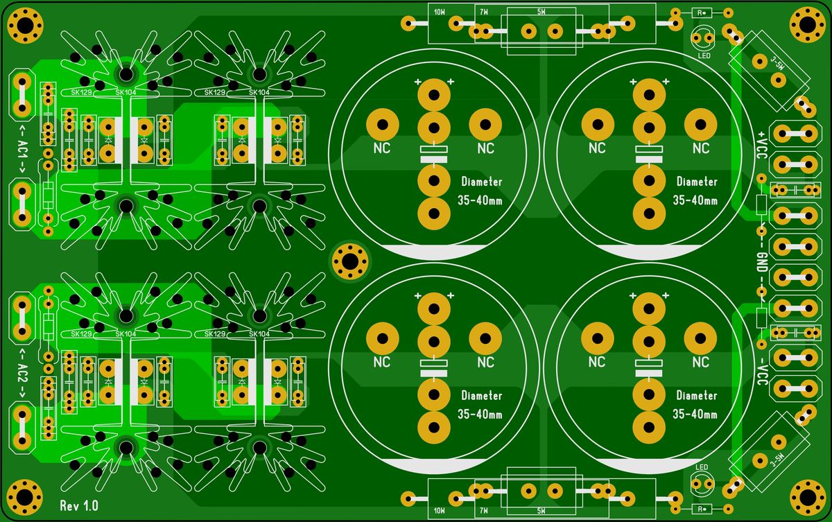

Warning
An error sending bad files to Jim's Audio!
For PCBs that are sold at Jim's Audio the four capacitors are reversed in polarity so it is impossible to use five-pin versions.
For those that does not pose problem it will be necessary also to reverse the legs of LEDs
For the rest everything is good

For the PCB at Jim's audio we can use five-legged capacitors with the implantation as it is drawn if we put the sikscreen underneath, the polarities are correct and the output polarities too.
The rectifying diodes will therefore be inverted and everything will return in order.
With the silkscreen on top the polarities of the capacitors have to be reversed and one can only put snap in two legs, the polarities of output are inverted.
