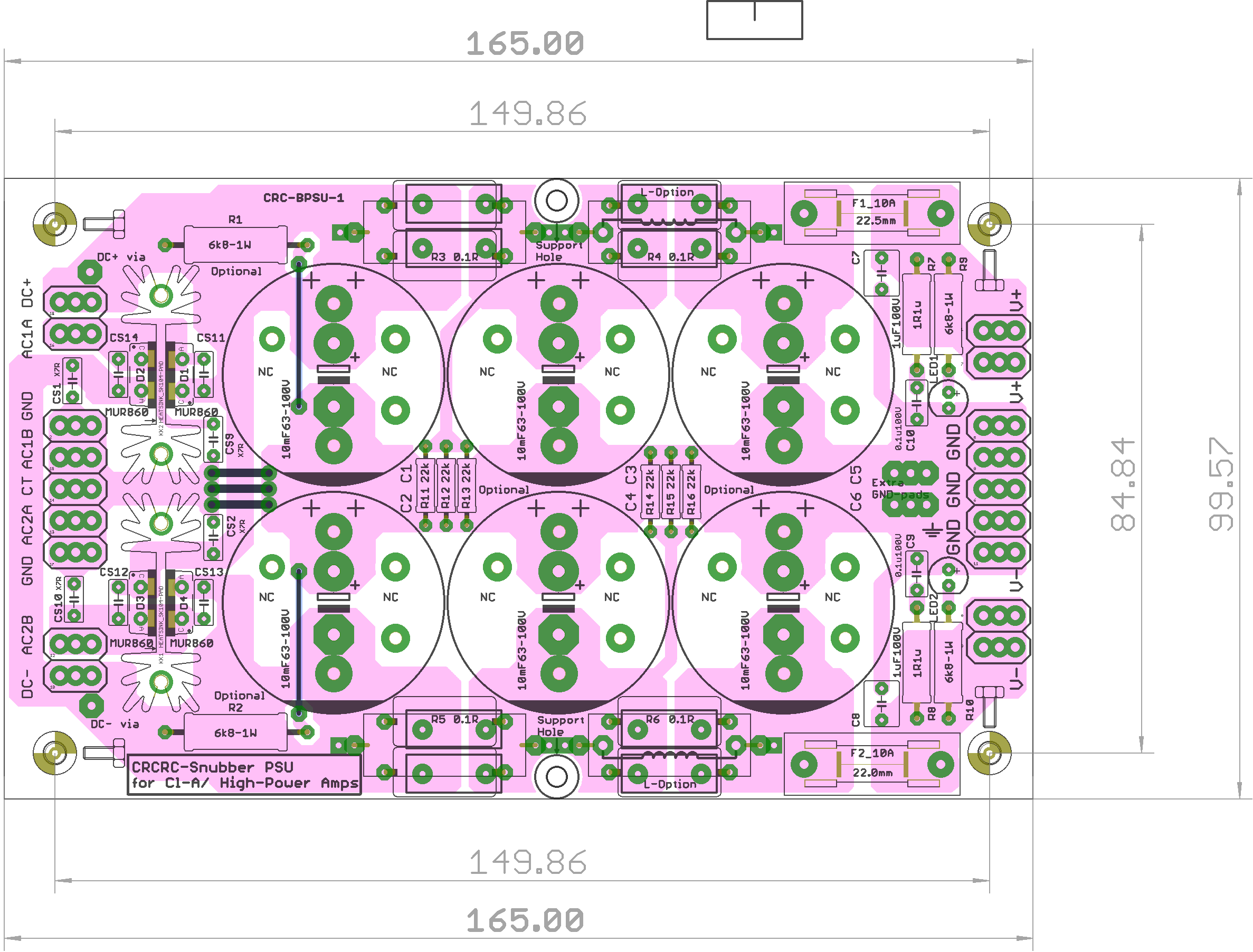

Hi all, I expressed interest in this Gb but since the max quota is over, I have urgent need to produce another PSU (C/C/C , CRCRC/CRCLC/CRCC etc with snubber and etc) for my amplifier builds(psu for a diy sub amp based on 2 pair peeceebee). pl note layout is not for sharing.
Here is a pic, 165mm x 100mm. I plan to make 70um PCB, if any one is interested, pl let me know, I can make different GB.
I hope no harm done to the thread starter, as the current GB already full.
i forgot, its based on modified AN-1849 An Audio Amplifier Power Supply Design, TI application schematic without the soft start portion of the app note.

Hi Prasi,
I would use a dual bridge configuration this way you isolate the circuit from the AC center tap gnd, just a thought.

I second this, and will go in for 4 boards if you make those changes. Thanks

thanks for your suggestions and interest. The changes would call for significant changes in design which i am not prepared to do due to lack of time. may be some other time.

both of your assumptions/comments (about not being flexible and that i expect community to lower my production cost) are wrong and uncalled for. I only said i do not have time to do the modifications that you require!. as simple as that.
I would be more than happy to get the boards from project16 and let my design gather dust. but unfortunately it seems i am too late to the party.
