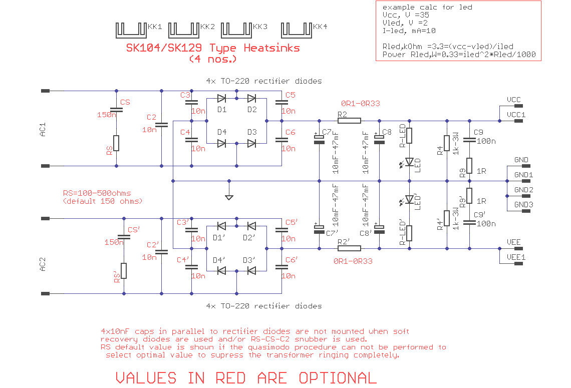

Here is a somewhat useful sch that I made .

Referring to the sch posted by me (post #285),
You could start with RS-CS-C2 default values.
Use MUR 1560 diodes
dont use the caps parallel to diodes (10nF)
you could try to get 33000uF 35V caps (2pin-10mm pitch/4pin-22.5mm pitch) from a known manufacturer (Rubycon/Nichicon) and get them from mouser/element14
CRC resistor could be 0.1-0.22ohm 5-7W, could even be 3W depending on amplifier current consumption (use ohms law).
2k2 to 6k8 1/2 W carbon/MFR for led resistor, LED could be any generic 5mm/3mm. bleeder could be 1k -3W MOR/MFR
use the o/p snubber as 0.1nF 100V and 10R 1/2 W MFR.
However it could be better to consult the amplifier designer for PSU caps requirement or go with amp builders opinion in that thread.
these are just generalized suggestions, people could use whatever suits their requirement and wallet.

Hi Outtek,
you could calculate the power resistor wattage if you know the current demand from amp.
Also you could piggy back the resistors (one on top of other) if you want to be safe. see XRK's build.
my 2c.
