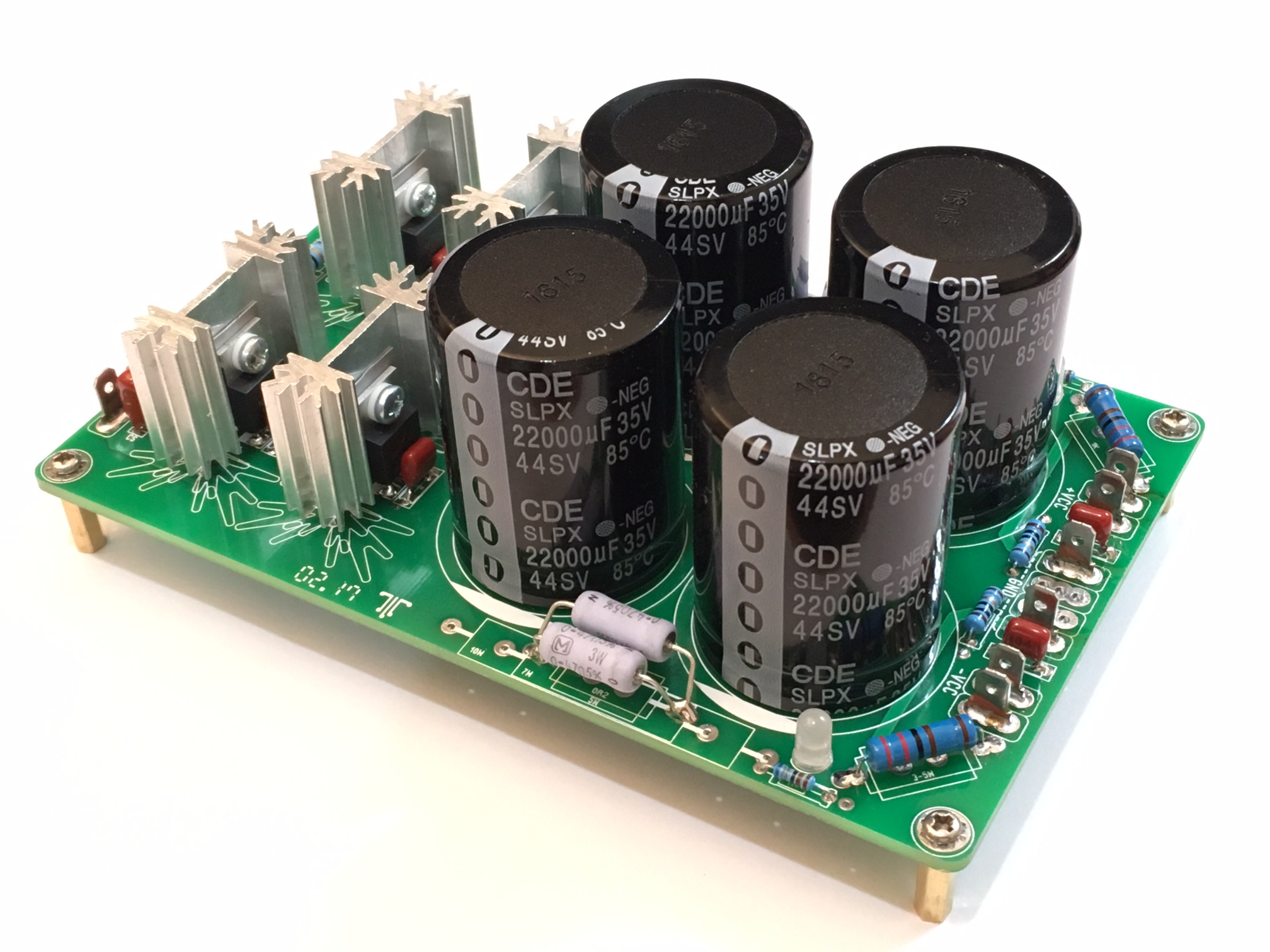

Are there caps compatible with the boards?
ESMH630VQT333MB80T
HiPaulo,
Those are 5 pin caps (VQT series), the board is made for 4 pin caps, hence VQT cant be fitted.
Out of the series in the datasheet, VSN, VNN,VRD, VND, VQD are compatible with the board.
reg
Prasi
P.S. Project 16 is developing a new CRC PSU for 5 pin, 4 pin, 2 pin all typesof caps upto 40mm dia, as posted by him some pages back.

Here is my build. Using MUR880, 0.1uF 100v CBB MKT at each diode, 0.1uF 450v CBB MKT and 10R 1W snubber, 22,000uF 35v Cornell Dubelier caps, Panasonic. 0.47R 3W thin film resistors x 2, white LEDs and 6k8 resistors, 2k2 2W bleed off resistors, 0.1uF 100v CBB MKT and 10R 1W output snubbers.
The PCB is very well made. I have never seen such a thick FRP board before. The traces are also thick copper. Everything fit perfectly. I tested with 400VA 18V toroidal trafo and got +/-24.2v and 7mV ripple no load.

That looks fantastic xrk971! 🙂
How did you calculate the output snubbers? I plan to build a quasimodo to figure out the values of the input snubber but how did you do for the outputs?
Is your board for a class A amp? What bias?

@PaoloPT:
I didn't. 😛 Although 0,1uF and 10R should absorb most RF > 200kHz, maybe not "critically" absorbed.
Yes, it is the Pass M2, as a test case, preparing PSU for a ZenMod Babelfish J. As with most Pass Class A amps, the supply is meant for 24v rails at 1.25amps. My toroidal trafo seems to be having an issue generating a strange hash of noise. I have been debugging it for some time now and have a thread here:
http://www.diyaudio.com/forums/power-supplies/306411-strange-forest-noise-linear-psu.html
It seems the trafo might be saturated as my mains are 123vac and design spec was 115vac. It's an Antek - which I have been very happy with in general as they have great selection and very reasonable prices. This new CRC board does no better than my P2P CRC (really did not expect it to - but was hopeful).

I just used up all my TO220 heatsinks on this beast. Just ordered a bunch more - but black anodized and bigger this time. They get hot at 2w dissipation each for 2.5amps.
Don't use SLR - use your phone's cam (short focal length so depth of field is very good) and a sheet of white bond paper to place it on.
