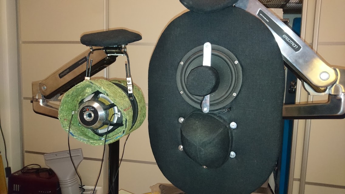

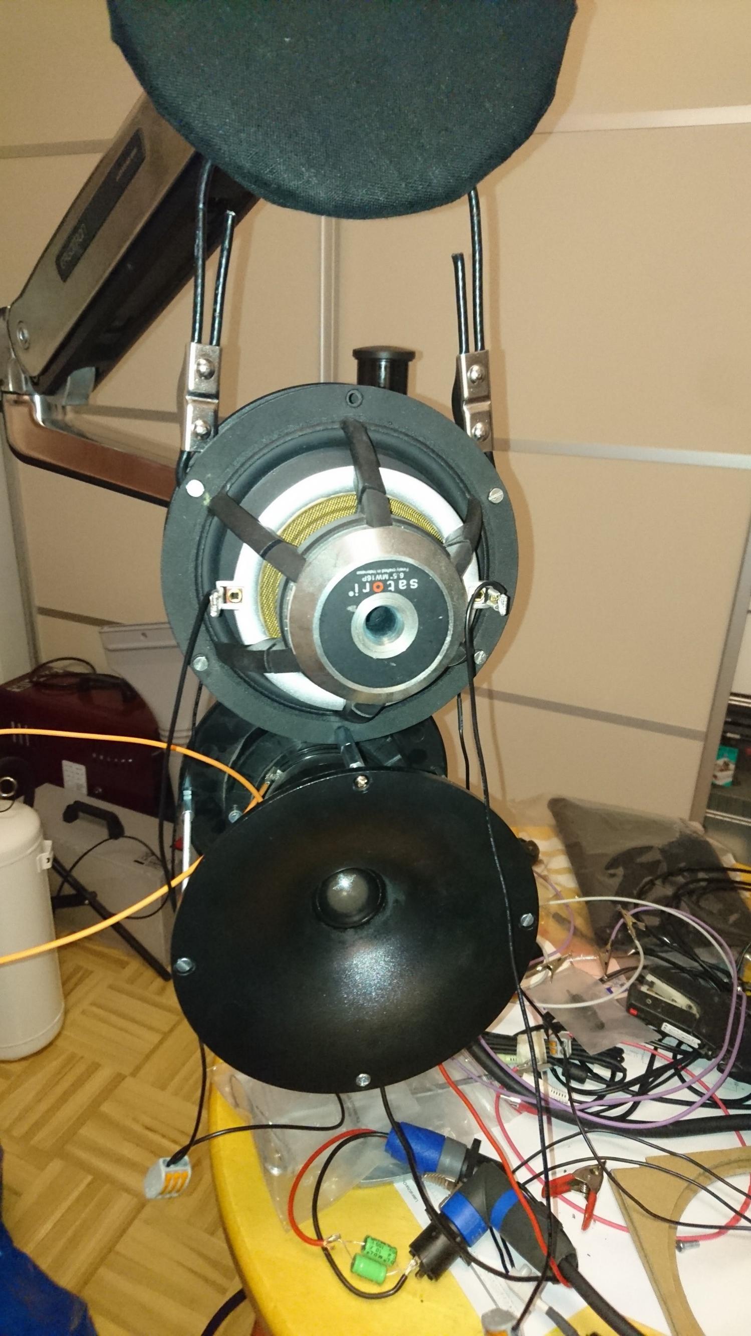

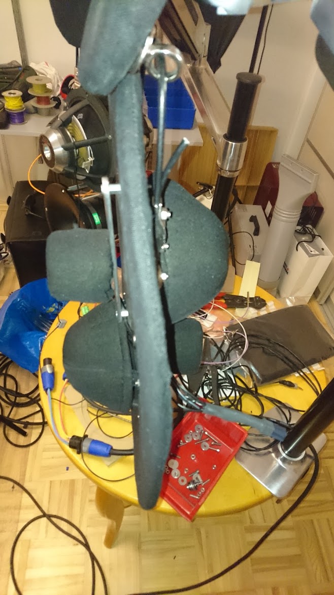

For a while now I've been doing some crazy experiments on different dipole configurations but this time I think I struck gold.

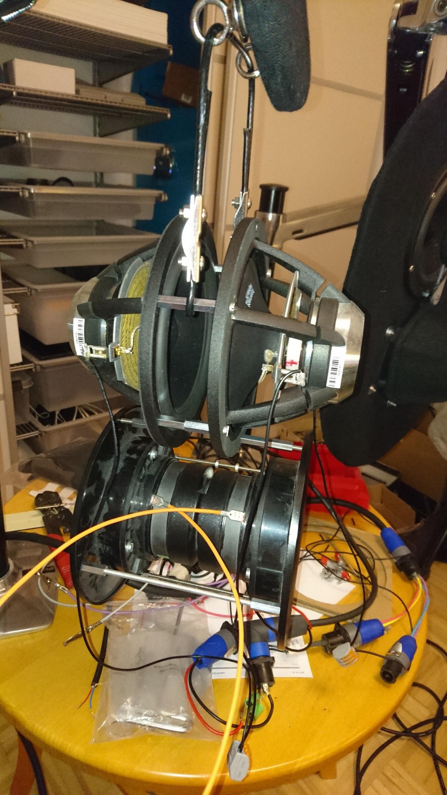

The setup is two opposed drivers mounted front to front. The rationale is that the distance between them is small enough that I can cross semi high, say 1500 hz ish but at the same time have perfectly symmetric front back dispersion.

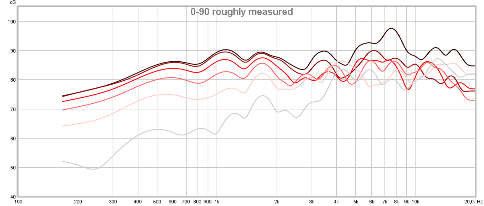

It does look crazy though, so I tought it would measure well enough up to 1 khz but above that show problems. In my measurements it performs nice enough up to 2 khz which is far far higher than I expected.

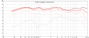

Last is the rough measurements after fooling around with some EQ and
adding the tweeter (Monacor DT-300 with WG-300 waveguide) crossed LR4 @ 1600 hz.
Lastly, all measurements are indoors at ~ 30 cm distance, far too cold for me to measure outdoors here in Sweden this time of the year

Are the drivers in-phase or out-of-phase?
Out of phase electrically.

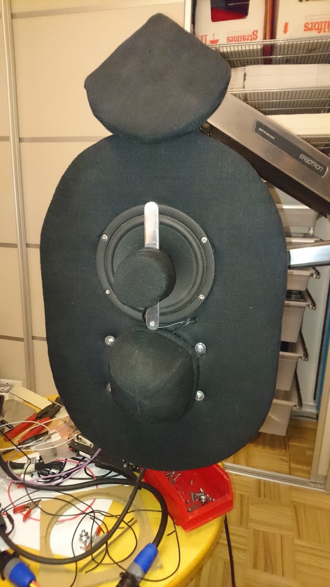

A normal top bottom configuration with DIY coaxial tweeters (Baffles are wool encased in linen):
Works pretty nice, great dipole radiation at 0-60 degrees. 60-90 between 2 khz and 6 khz is not a perfect dipole though so there is some bloom here. This was what I assumed was good enough with the drivers at hand which is why I was so suprised the front to front setup seems to work so well.
Then the gap is doing virtually nothing - may as well not have it.
I'd be interested to see what happens if they are in-phase. Then the gap would be critical and varying it would be quite interesting.
Yes, clamshell might be interesting. If they were in phase they wouldn't be a dipole

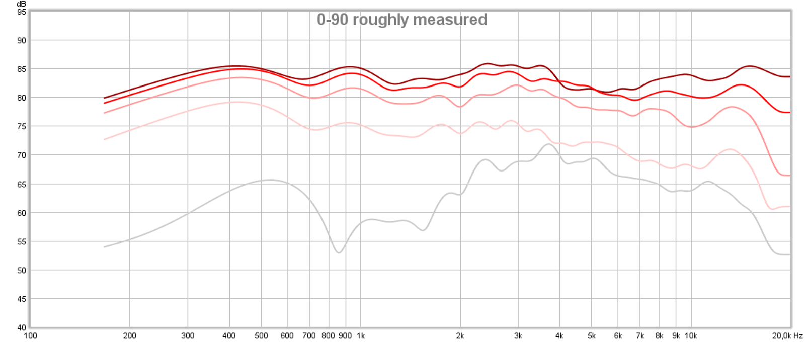

More data!

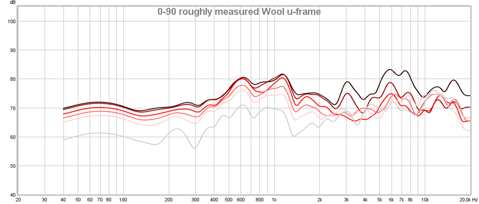

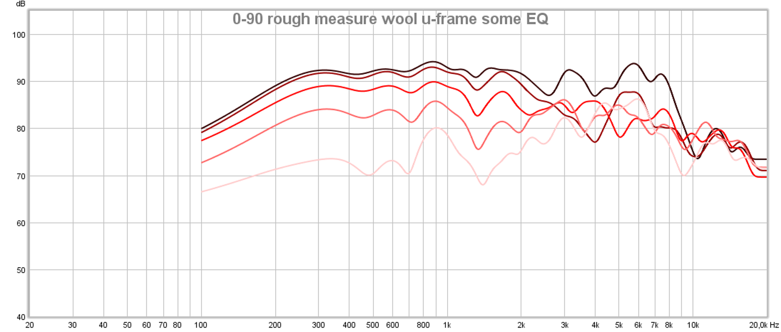

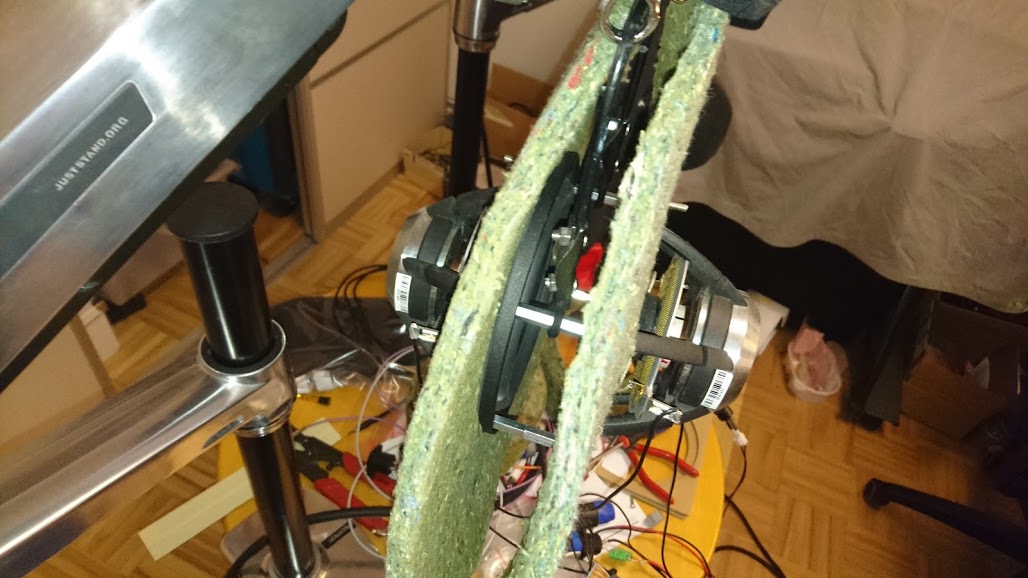

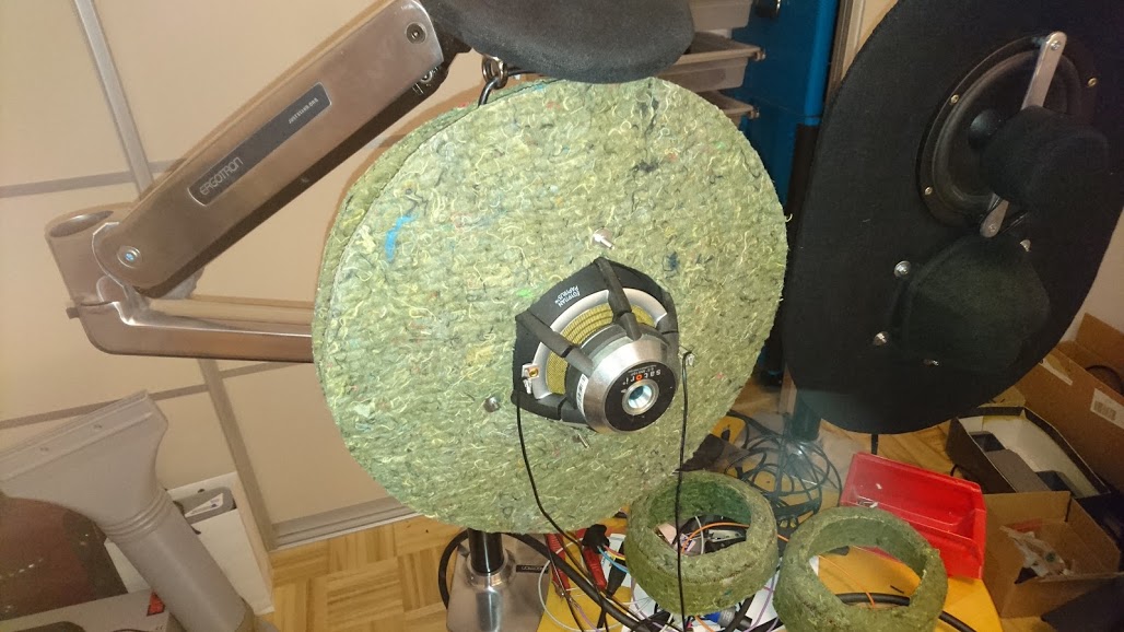

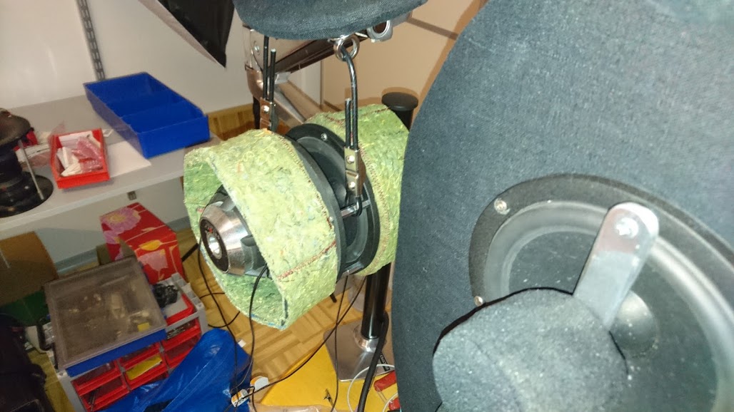

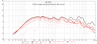

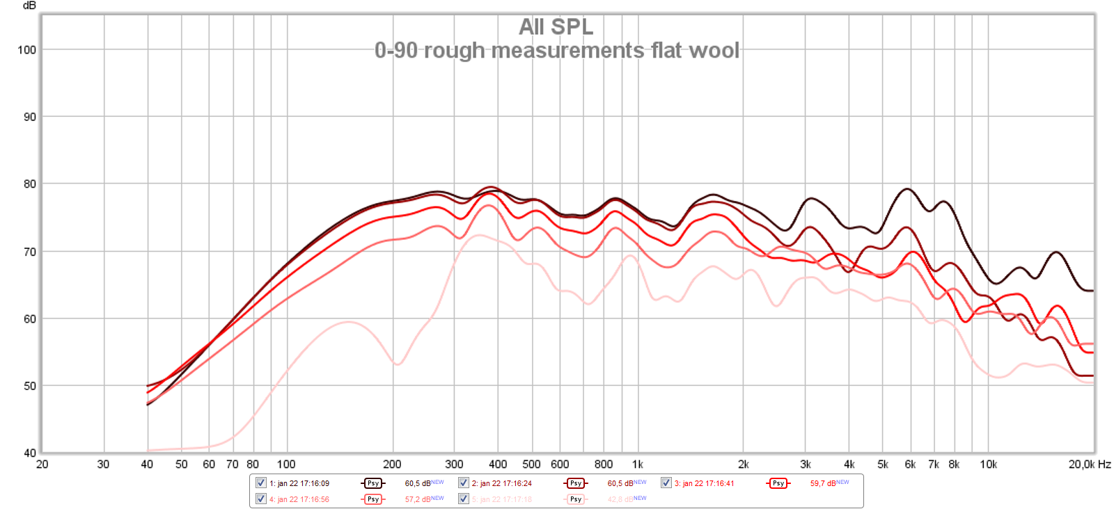

First up is wool U-frames to increase the low frequency output.
The first measurement is without EQ, the second with.

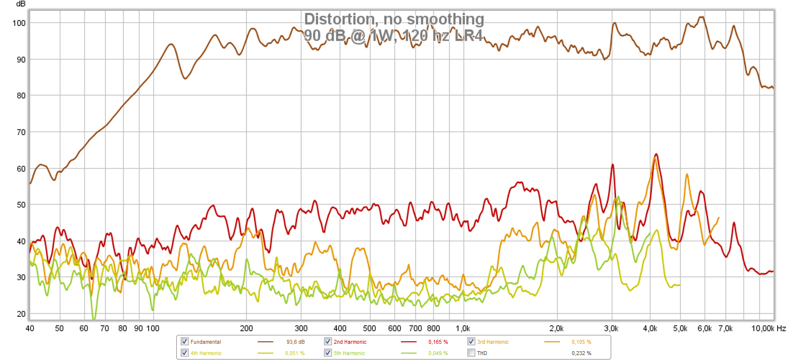

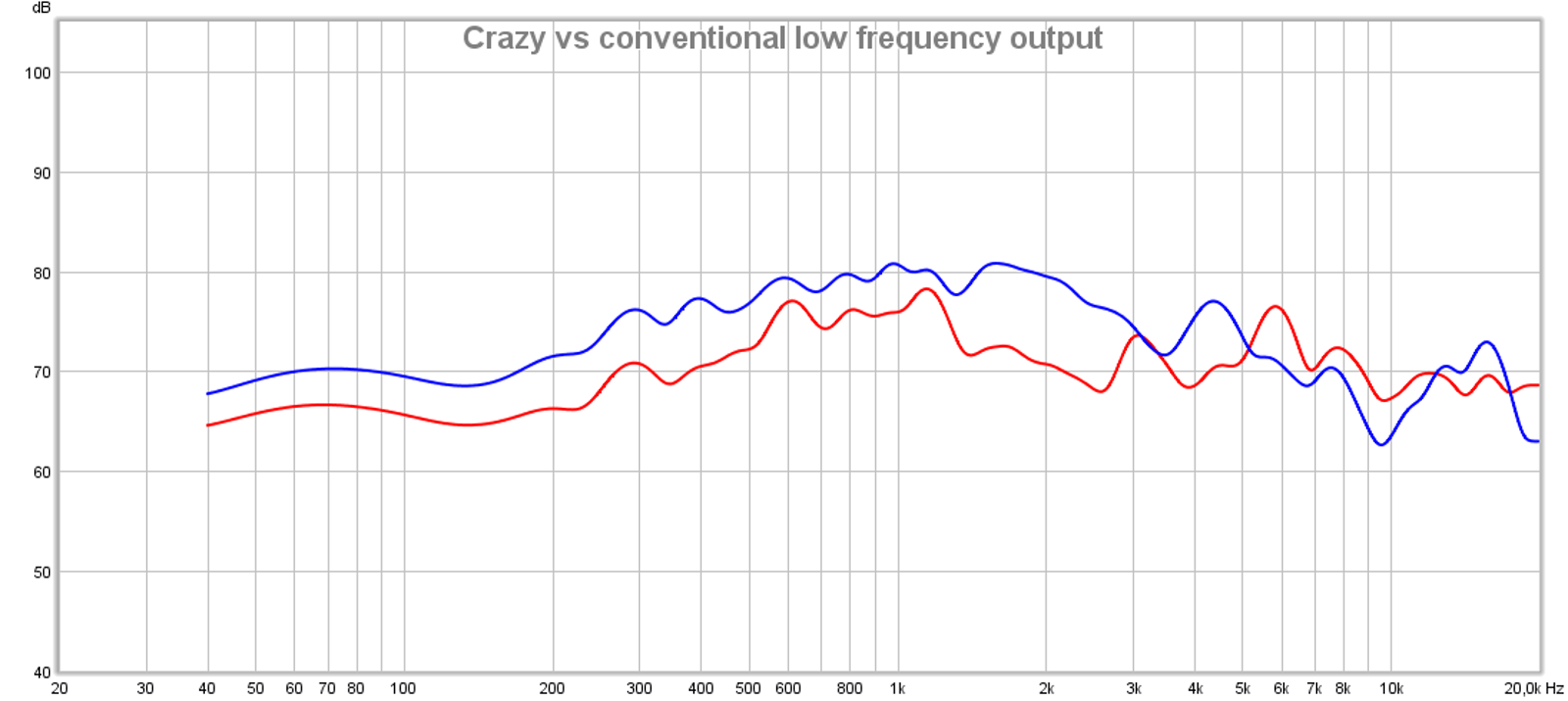

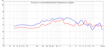

Next is comparing 0 degree response of the front to front u-frame to the top-down normal baffled dipole. I loose about 3 dB low in low frequency response but I gain a much more compact package. Pretty nice.
For science I also included distortion measurements @ 90 dB @ 1m and there I can verify that I can play as loud as I want to anyway. The amplifier is a F6 with a current feedback loop instead of voltage, ~ 600 ohm output impedance.
Next is a front baffle:
I only measured here with EQ, the same EQ as I used on the U-frame. I got about 1 dB more sensitivity on the low end but the side null isn't as nice as the u-frame and the setup is much larger so my current conclusion is to discard a flat baffle with a front to front setup.
From these experiments I'll probably go down the U-frame route if I continue along the front to front path.

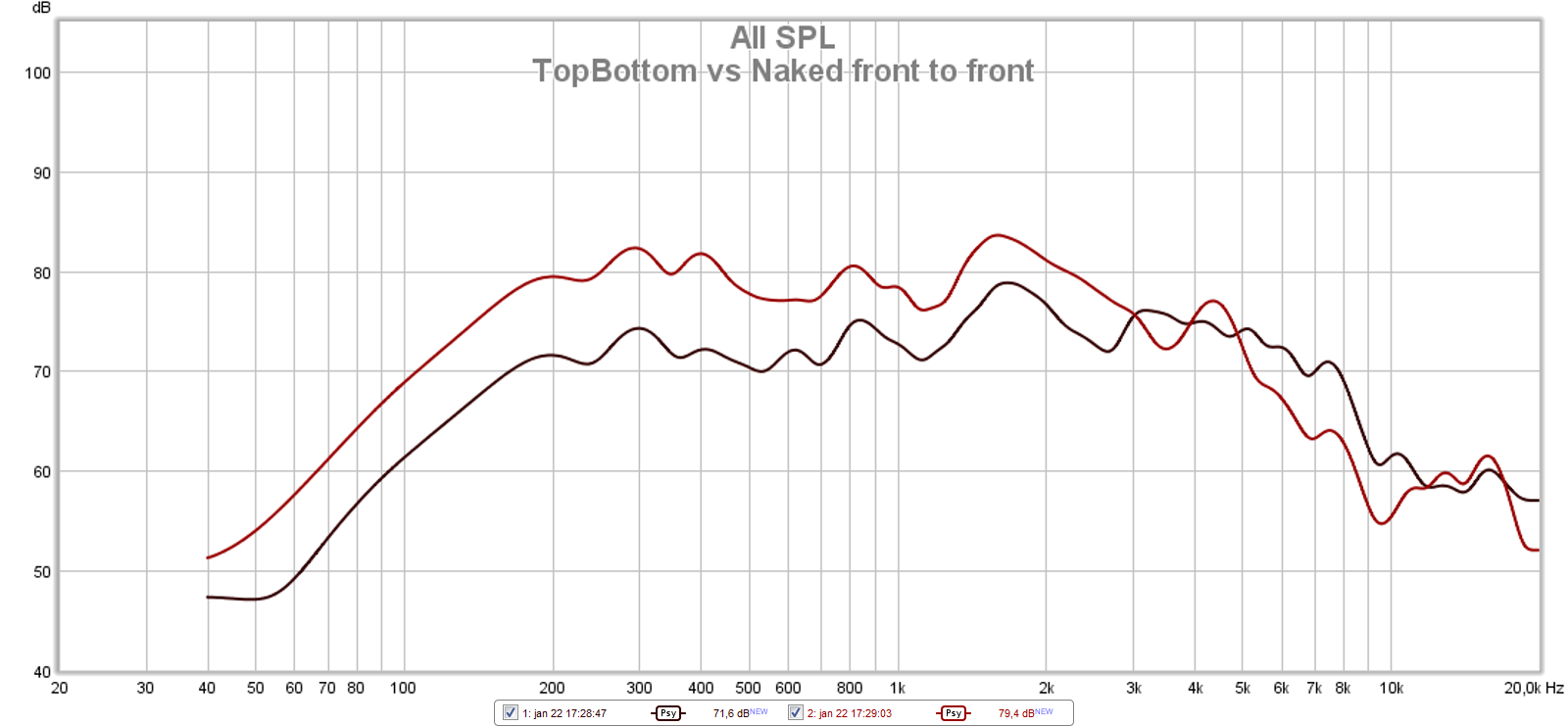

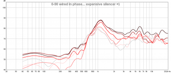

And now the extra measurements:
I compared the 0 degree low frequency output of a naked front to front setup compared to the conventional top bottom wool baffle, about 8 dB difference.

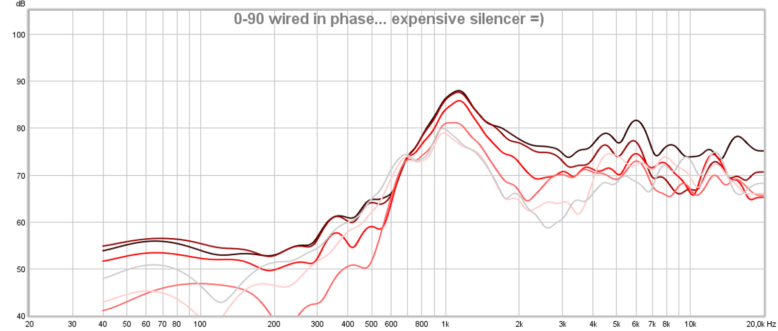

I also did a 0-90 where the drivers were wired in phase... an exotic way to generate silence in the bass region

That's an interesting setup, but I do not see any real advantages over a single woofer... at all. All this does is position the acoustic centers of the front and rear radiation farther apart, which just makes the dipole fall apart at a lower frequency. This is not an "advantage" AFAIK.
Also, the tweeter pair is too far apart to make a good dipole, as evidenced by all the crossing on and off axis responses above 2kHz. The lines should follow each other, tracking together, as much as possible. Instead it's a bit of a mess. If you measured with higher resolution you would see this more clearly. This is exactly what others have reported when trying to use two tweeters back-to-back as a dipole. Because of the magnet structure it is impossible to get the two acoustic centers close enough to create a dipole at high frequencies, where you want to use them.
But hanging the drivers by wire or string IS a good way to isolate the drivers from other drivers in the system. Good job there. I would not hang the tweeter from the woofers, however. All drivers need to hang separately. I use this approach in a "nude OB" system I built recently, and it works well. I used monofilament nylon (like very heavy duty fishing line) which is unobtrusive.
