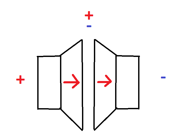

Please clarify some points about your woofer setup...
Unless I am mistaken about how you are driving these two, it has the same output as a single driver. You said in post #3 that they are "out of phase electrically" yet they face each other so physically this reverses the "phase" of one of them with respect to the other. This means the pair is operating "in phase" that is the both cones move either forward or rearward together. Is that right? You can check this with a very low frequency signal (like 2 Hz), or by connecting a 9V battery in place of the amp and inspecting how the cones move.
If instead the cones are moving in opposite directions, e.g. first towards each other and then away from each other, then you have two closely spaced dipoles that are out of phase. Not sure what that is... (GedLee mentioned "quadra pole") but since your off-axis measurements look more like a dipole I am guessing this is not how you have it set up.

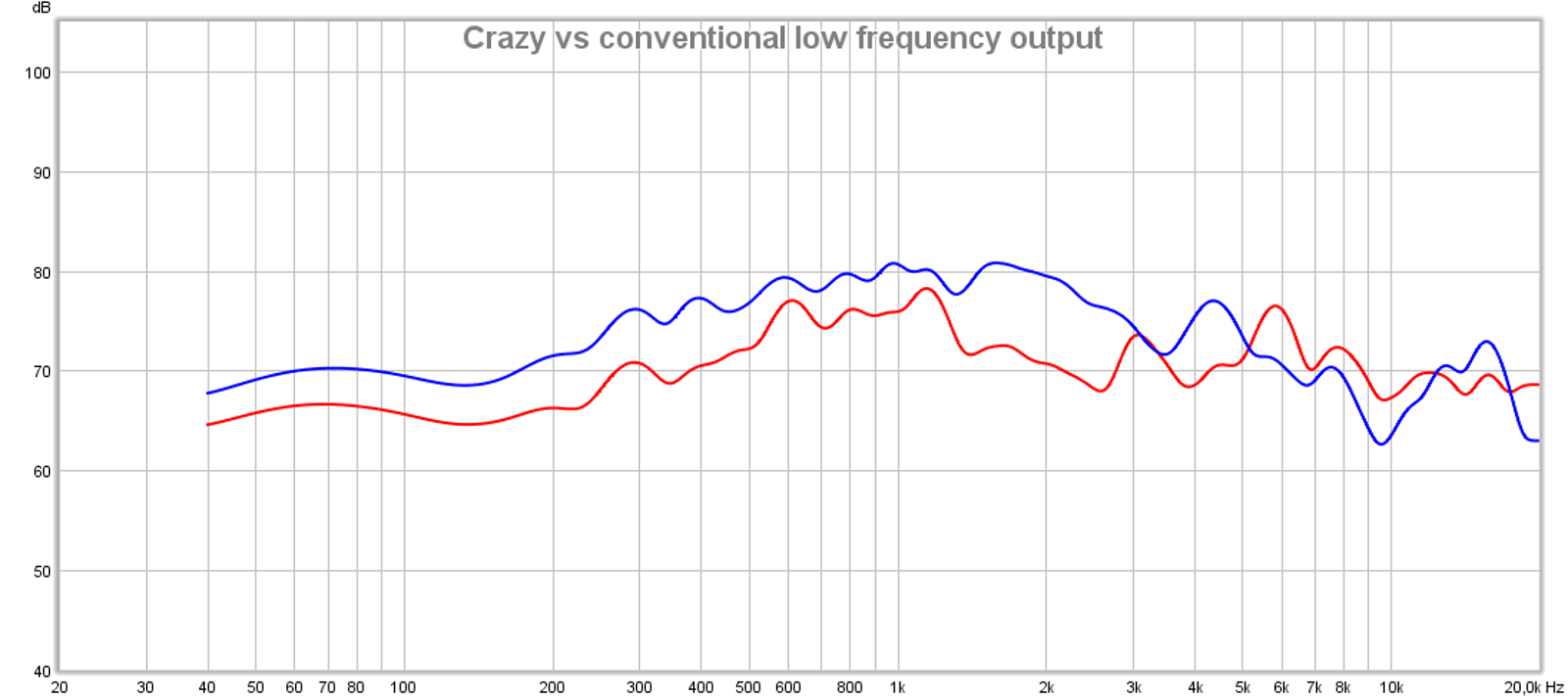

They are moving out of phase thus as a dipole. If I seal the cavity then I agree, Linkwitz calls them compound dipoles and predicts that they should sum as two dipoles with a distance D like if I would place them on top of another in a normal setup. My measurements support this as I have just 3 dB dipole loss due to smaller baffle when comparing the U-frame and the bigger and the conventionally baffled dipole, blue is conventional and red is the compound.
If I wire them in phase then I don't get any bass output at all as they eliminate everything less than 1 khz very efficiently =) See second measurement here.

I think it's not really going to function as a compound dipole because the drivers are so close together, but maybe... The SL illustration is found here:
Electro-acoustic models
What you have is essentially just a bad dipole. I say "bad", because it is worse than one driver alone, but has no benefits over a single driver. That is in general how I think about higher order gradients, too...
All this arrangement really does is move the distance between the "front" and "rear" sources a bit farther apart compared to a single driver. This makes the dipole pattern break down at a lower frequency. It's the exact same thing that is plaguing your tweeter pair. Also, the magnet is right in front of both drivers, and that will cause some minor irregularities (or even some major ones if the magnet is larger than with these drivers).
