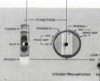

On topic, I note there is phono 1 and phono 2. Are they two preamps or do you switch the cartridge input?
Yes there are two physical input connectors for two turntables.
