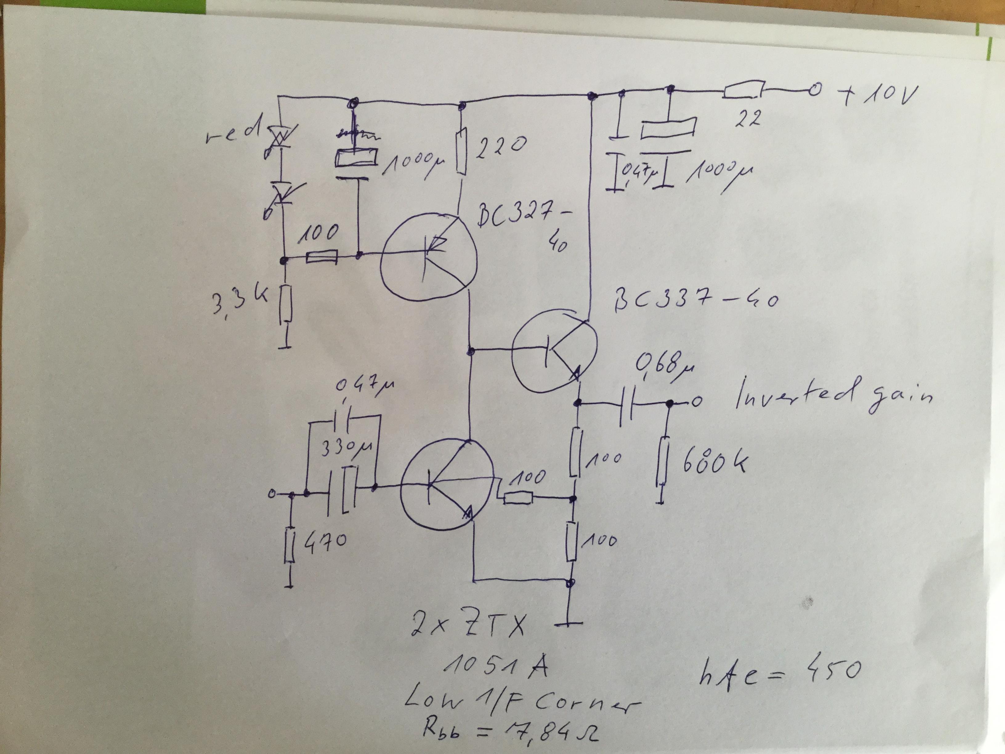

coupling caps for phono prepre
This may well develop into one of the many "phono input bias current"
discussions (at least a few minutes ago).
I built a large number of phono stages, some of them using Jan's regulators,
a few even using boards that he designed (these two amp examples not of
my design) and do not use input coupling caps. Be it base or emitter input I
never had any problems with input offset or current flow. This is a more than
25 years experience now.
Any electrolytic coupling cap is in big disadvantage here, because these do
not want to work without dc applied and this is also a big long term quality
problem in a particular historic amp series with only 0.5 V on the caps (emitter
voltage).

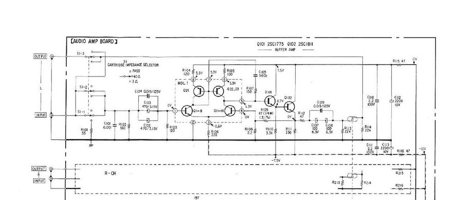

[HA-55 is very close, both use parallel tantalums too

Concerning the Sony circuit I do not think that a differential amp is a good idea for a pre-pre.
It has 6dB more noise then a parallel symmetric design. They may have used it for other good reasons like low distortion and good DC precision. They use a massive 40mA idle though and in that time they had the great Toshiba, ROHM and Hitachi devices, long gone now, that combined super low Rbb with high and linear Hfe, plus high early voltage and low Miller capacitance. That where the days folks ! And I was just a child working with NE5534 and BC550,560.

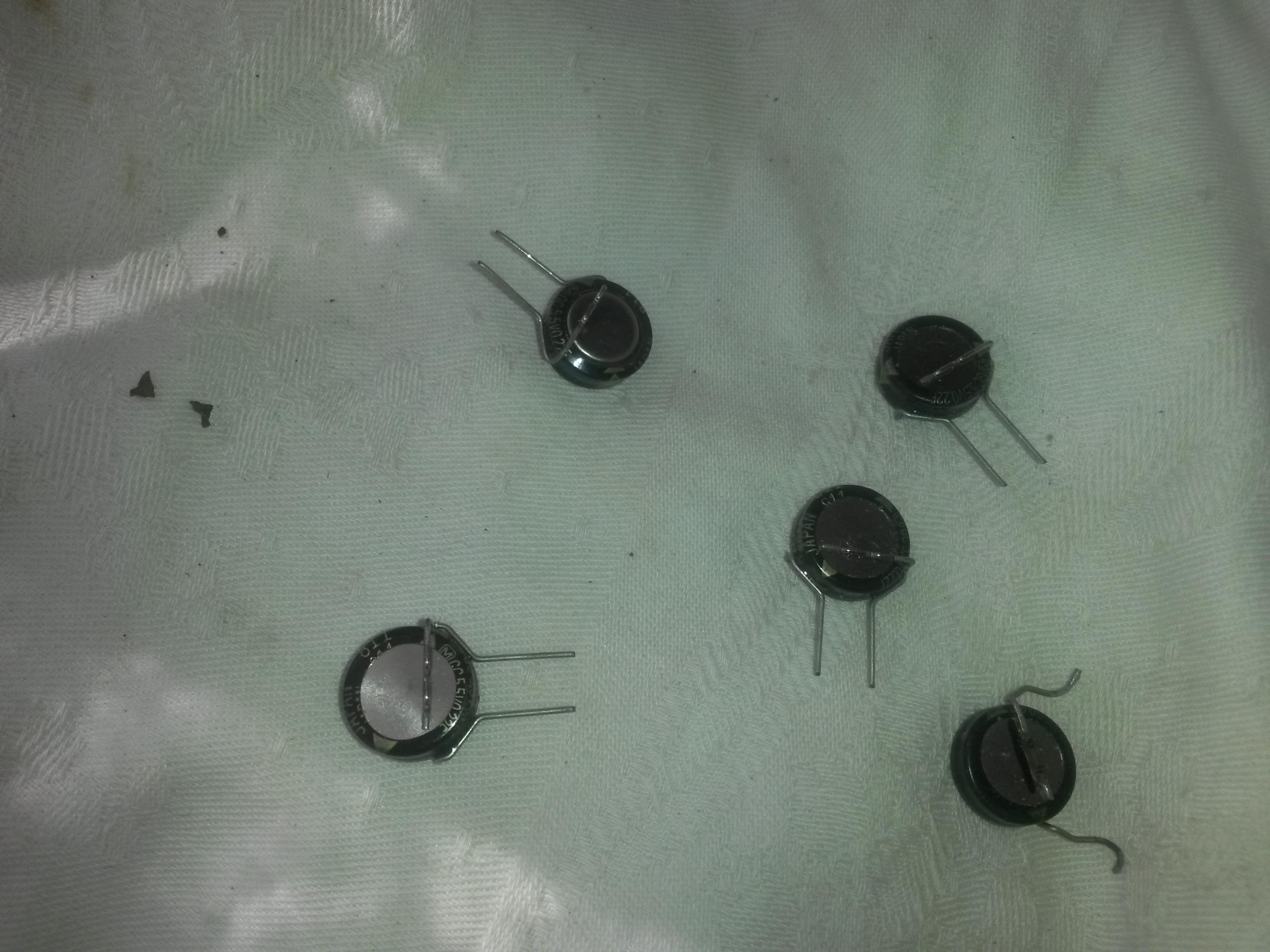

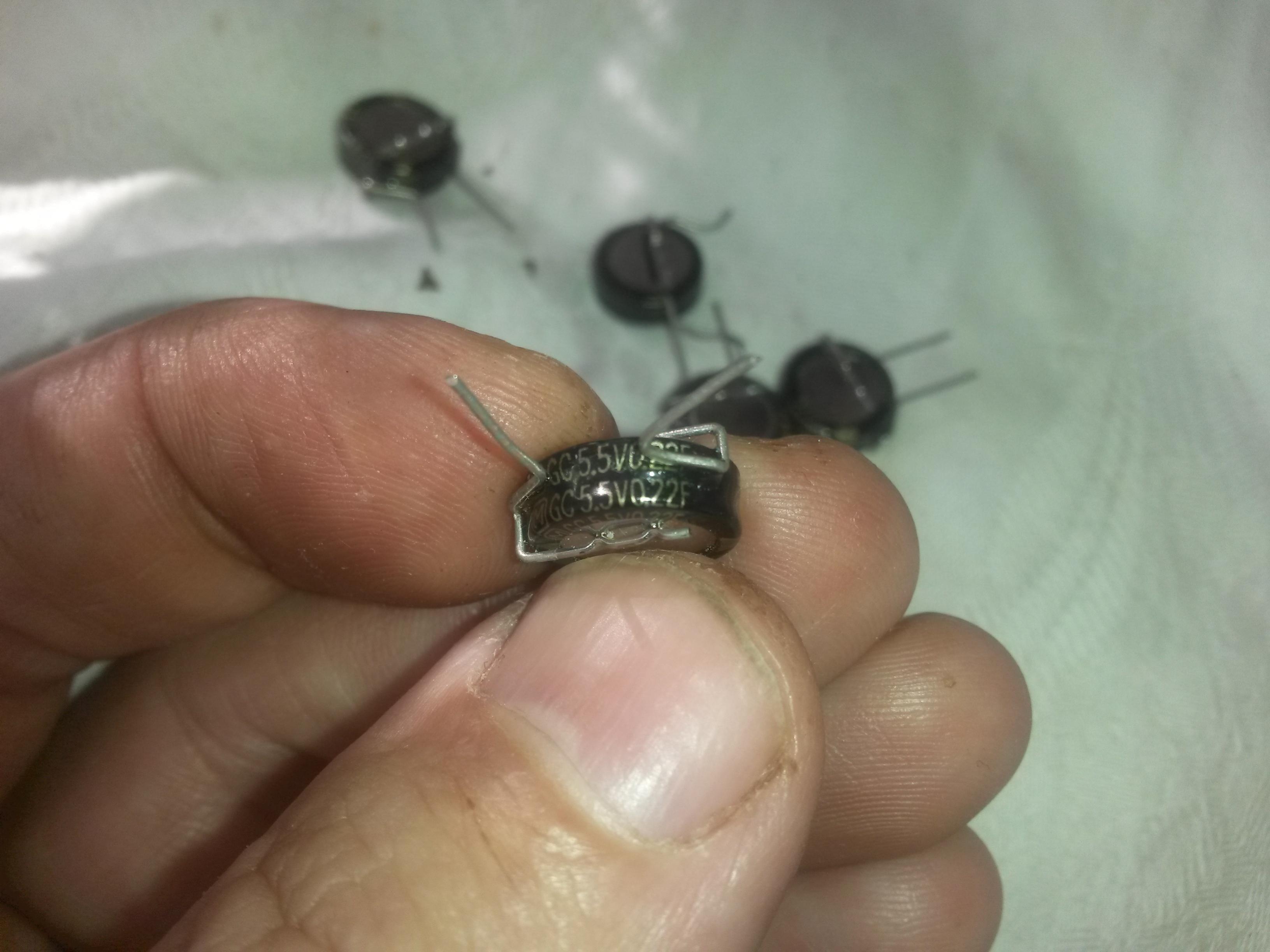

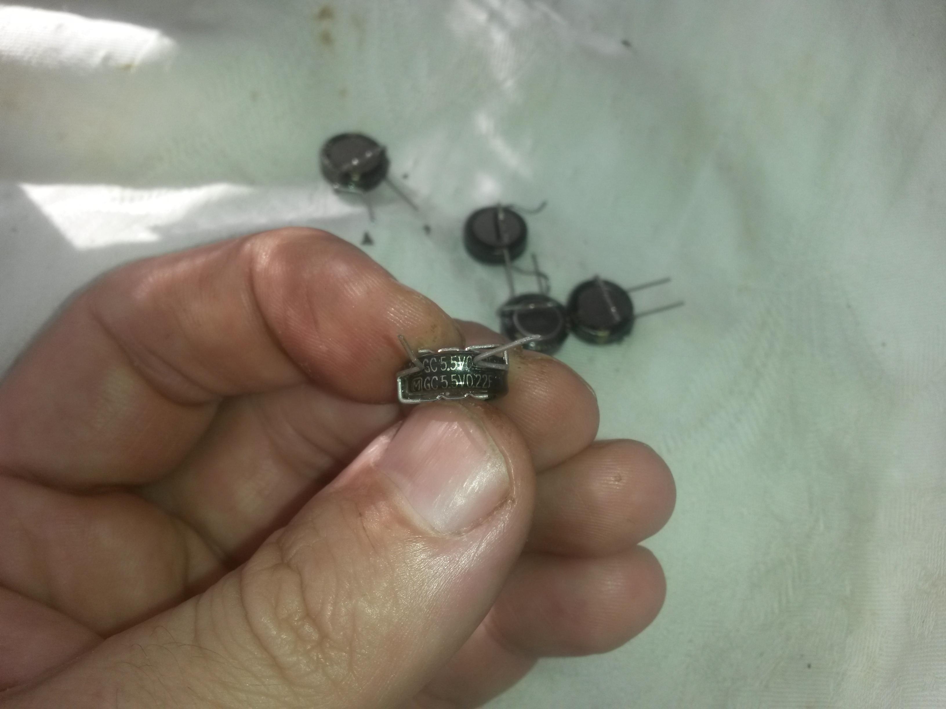

i wonder if this type of caps are the perfect cap for this application.these are the ones used as battery for memory dumps.220 000uf/5.5vdc although i have a feeling that the writing on themmight be wrong and the actual value is 22 000uf.still very high.I can't measure it anyway.
