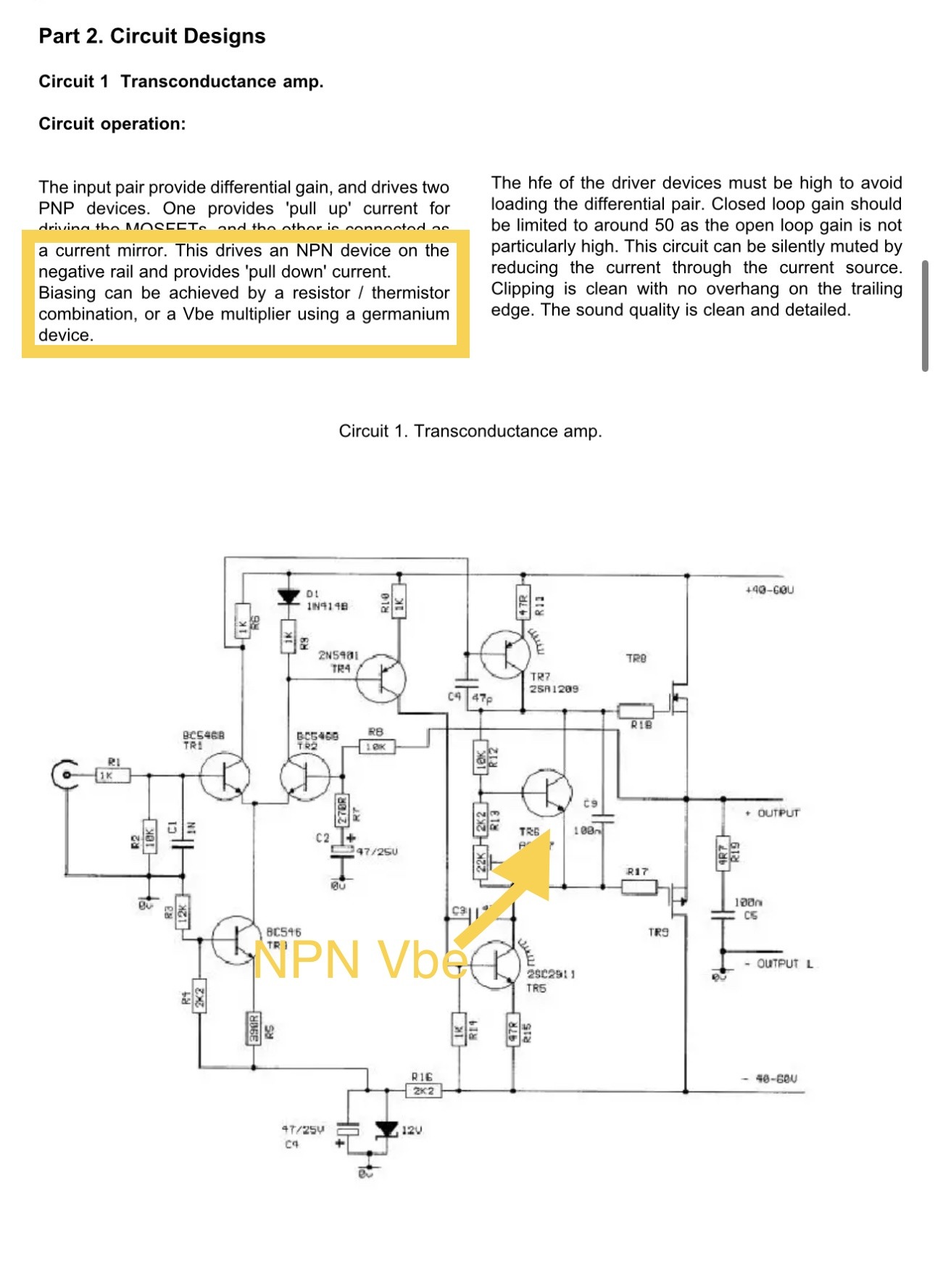

I think if the endings are bjt the vbe multiplier requires bjt in TO126 container or similar. I think if the finals are MOSFETs the VBE multiplier requires MOSFETs like BS170 or similar. I think if the finals are hexfet the vbe multiplier requires hexfet type IRF840 or similar. More or less.

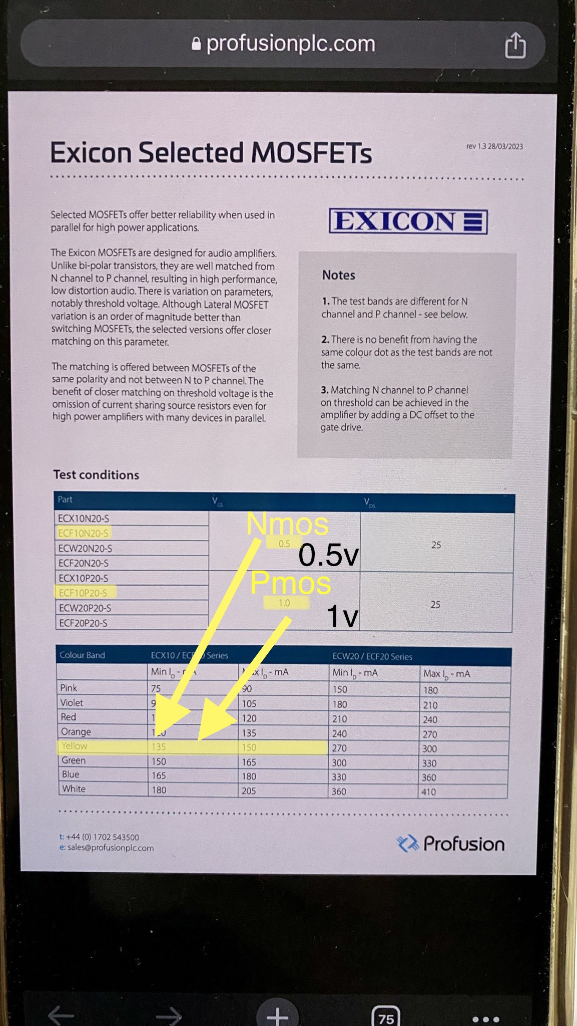

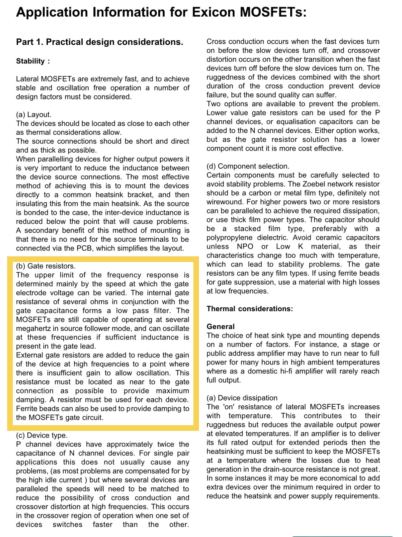

All right. I have studied it for a long time, and I found that there is a problem with my previous bias. Exicon's mosfet Nmos vgs is 0.5v Pmos vgs is 1v. Well, so I have to pull vr2 to adjust the DC offset. After adjusting, the center point comes to 326mv in the simulation software. Well, if you maintain the R17 of 22.1k after adjusting the offset, even if you short R15, you can't let the voltage be lower than 1.2v. Obviously, this can't be used... Well, I simulated three of them, two of which are to remove R17. The only difference is that R15 is changed to 100k or 47.5k. I think 47 .5k is better because vgs can lower the modulation, and the bias at the largest point of the vr adjustment channel will only be about 1.48v and will not exceed 1.5v. The other is to change 15 to 47.5k R17 to 5.1k, which can also get the required bias 0.5v and 1v. Of course, when adjusted to the maximum, it will exceed 1.5v and reach about 1.75v. Well, should I choose R1547.5k, remove R17, or change R17 to 5.1k?
Well, I have seen a lot of mosfet exicon showing that he is a negative stability system and will reduce vgs by himself when the temperature rises. Really? So why do you need temperature feedback... Well, in short, the official said that it will drop about 0.1v-0.2v vgs. According to the temperature curve of 2n2222A, it will be about 0.4vbe 75 degrees and about 0.5vbe at 25 degrees. Well, it seems that the amount of feedback will not be too large.
Well, I also noticed that exicon wrote that ferrite can reduce oscillation. Should I change it? When replacing the burning gate-level resistor, the 16 ferrite bodies installed in the original factory were removed.

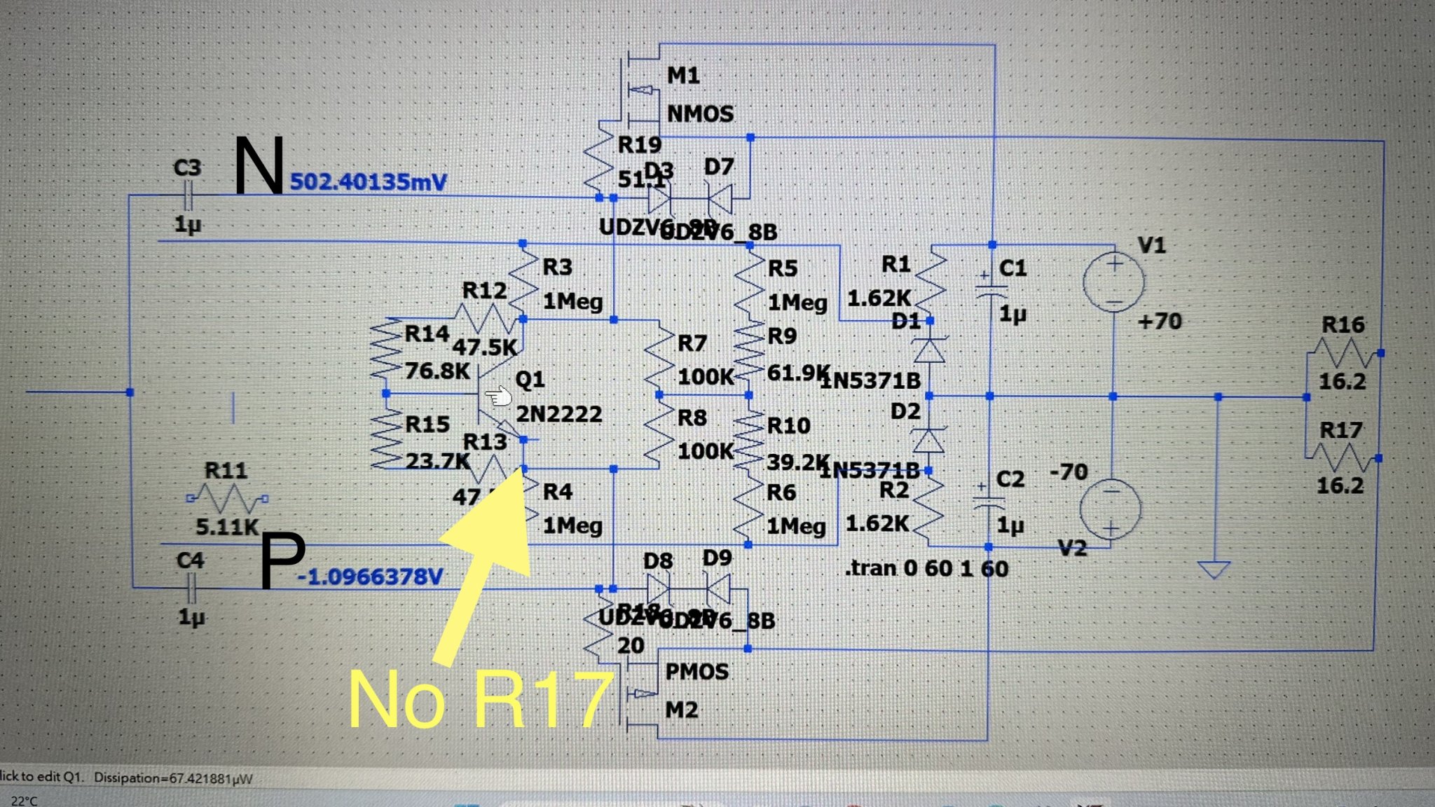

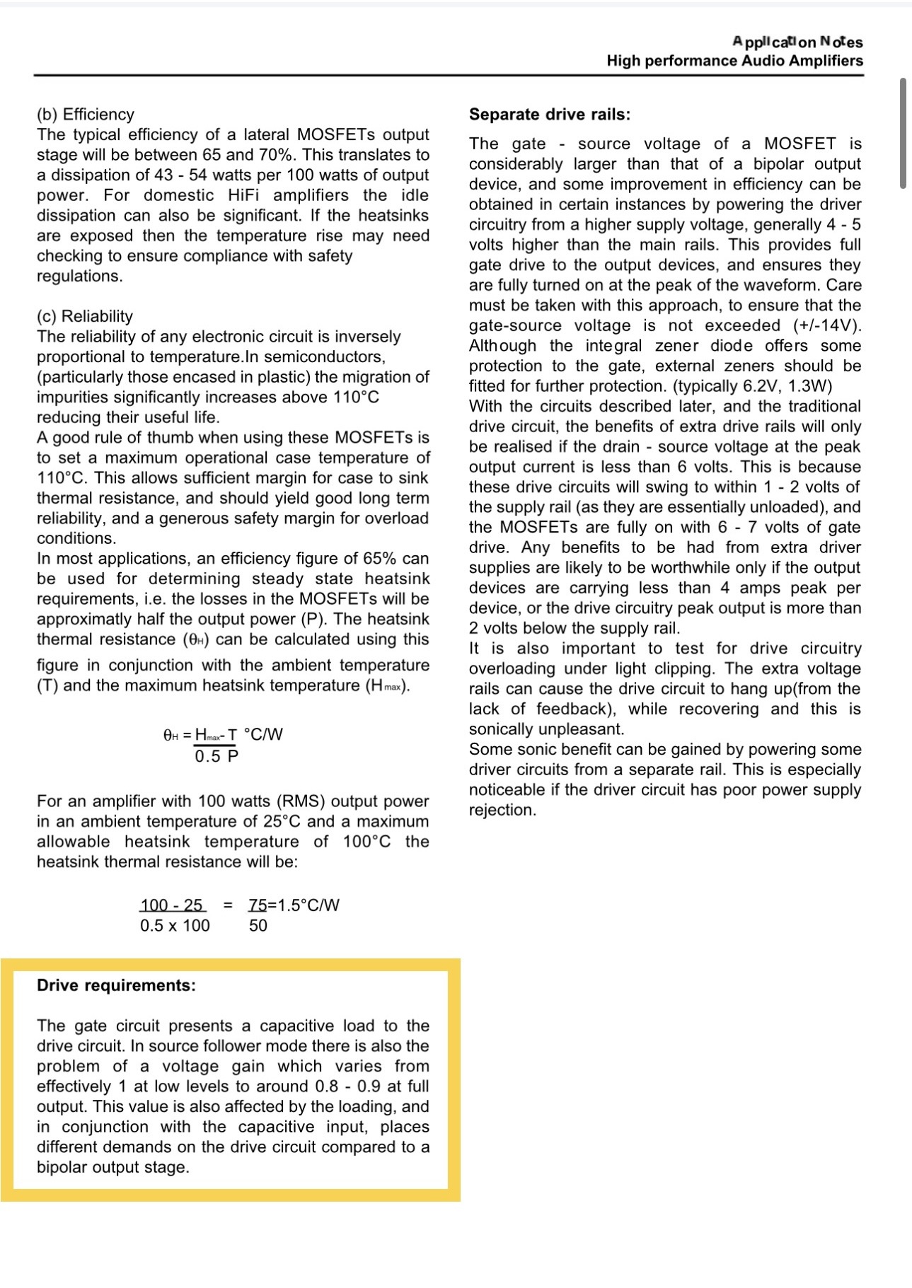

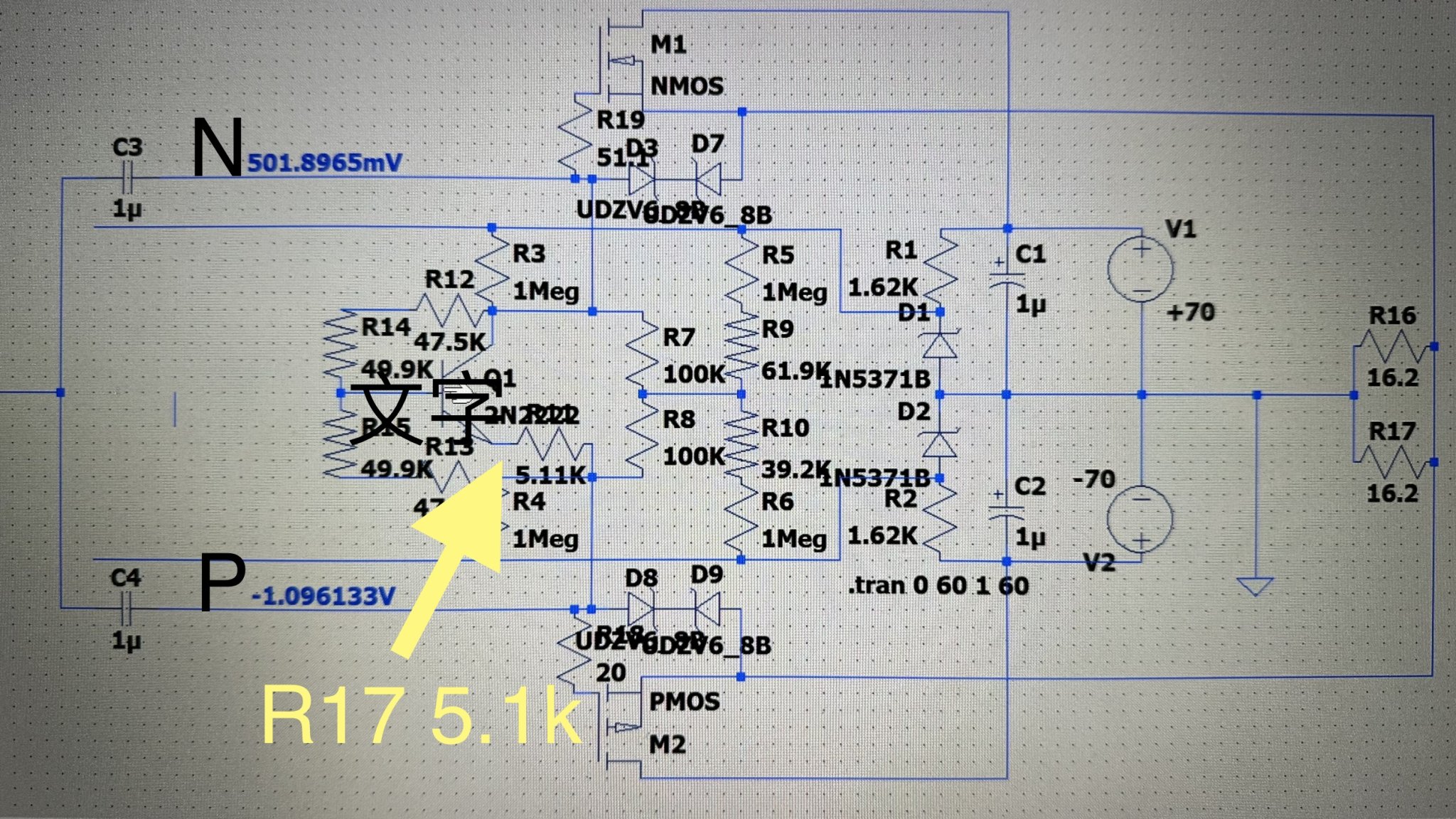

Finally, well, I have to make the selected version of mosfet yellow, so 135ma*8*70 will have nearly 75 standby power consumption. Will it be very warm?
In the simulation, in order to pair the mosfet vgs voltage and let the +-channel run at 135ma, is the 326mv offset voltage too high?
Well, do you think it is more reasonable to decide how to change R17 under this situation?

Hi Willam,
At this point you are designing a new output stage. That's cool, really good on you actually.
Damping resistors normally work very well. Lossy ferrites are a good choice too. As for the famous resistor R17, make a space for it that you can short. Then play with the circuit for real - forget the simulator for your final decisions.
I could design this for you - except that I am a working technician and simply don't have time. I'm just restarting my own design that I don't have time for.
Temperature rise has everything to do with dissipated power and heatsink fin area * efficiency. If you look at some heat sink vendor web sites, they may have calculators for you. Measure your heat sink, pick a similar one from their stock to get the efficiency number and use their calculator to figure it out. Airflow is key, so is ambient temperature and that will determine inside chassis temperatures. The SA-100 was too high, measured at 50 °C at idle, ambient running about 21 °C (Canada in the winter with the furnace running, or air conditioning in the summer). So you must pay attention to the internal chassis temperatures as well. Counterpoint lost power transformers due to internal case temperatures, they have a thermal fuse. If you place that amplifier in an enclosed space, expect the temperatures to get really high, even open at the front and back.
Your design goal should be to reduce running temperatures. Run at the lowest bias current to give you good sound and low distortion if possible. A great sounding amp that has a blown power transformer doesn't make a lot of noise. But, it makes a great paper weight!
