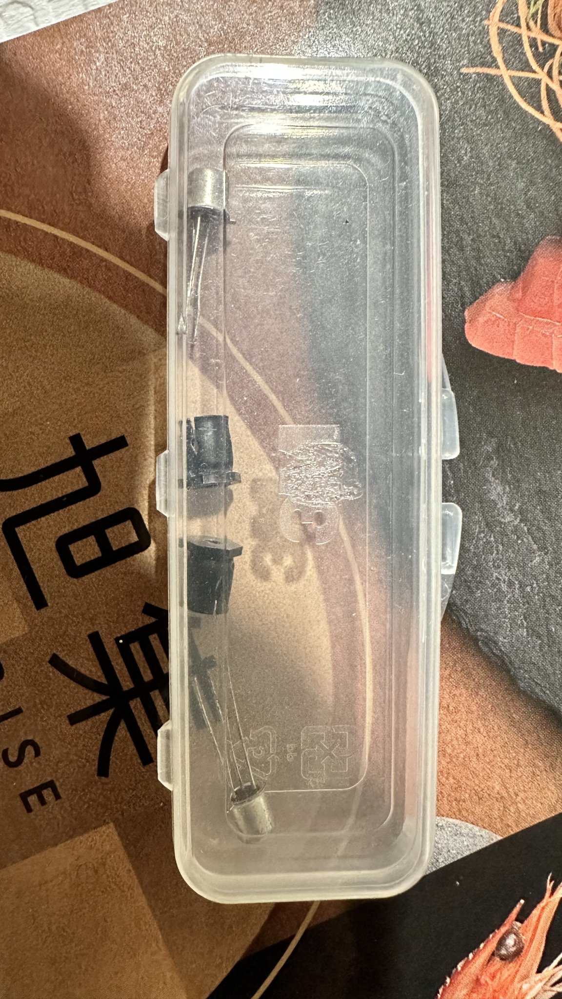

Well, I'm talking about the 2n2222A temperature compensation circuit part.
Thank you very much, Vivavee

Now, the bias control transistor. R17 reduces the amount of compensation the transistor has. So if you short it, your bias current will be reduced too much with temperature. How much do you need? Heck - no idea. You are using different transistors with totally different characteristics. I did outline the procedure for you since you are in an area outside the original design. If I were you, I would start with the original value. My guess is that this value will change depending on the level of bias current you decide to run the outputs at. At this point you really do need an audio distortion analyzer and low distortion oscillator - and an oscilloscope. An HP 339A would be perfect, plus a decent analogue oscilloscope. With those you can determine the most reasonable level of static bias current. Once you figure that out you can work on bias stability (R17).
You might consider changing the 2N2222A to something like a 2N3904 so you don't need that (very) special insulated holder for the transistor. You can simply poke the 2N3904 into a hole in the heat sink, or have it held against that surface. That is entirely up to you.

Thank you very much for carefully explaining the role of R17. I learned that R17 can reduce the low voltage drop caused by temperature compensation after radiator heating. However, I really don't know how much the voltage will drop, so should I try the original 22.1k specification first? Or after measuring the heat of the radiator, adjust the vr1 without R17 and readjust the bias voltage? I realize that if R17 maintains the 22.1k specification, then the b level of 2n2222A will change from - to + to achieve a programming voltage of about 1v.
Uh-huh 😞 I don't have a distortion analyzer, and I didn't even buy an oscilloscope. At present, I plan to buy an oscilloscope first. I need to know whether the wave line and mosfet oscillate. (I don't believe that using listening to judge whether the machine is wrong or distorted.)
I will continue to use 2n2222A. I keep the original heat sink (I think it is for insulation because the 2n2222A shell is charged)

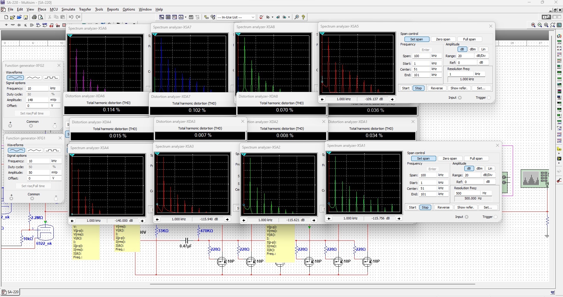

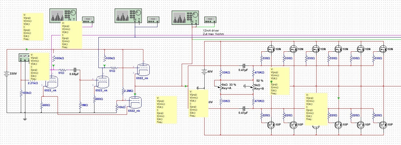

I have always appreciated the Counterpoint hybrid sound, but understood that the way they designed the output stage created a lot of problem with oscillation.
Just like Counterpoint I found that using emitter resistors are very bad for sound quality and I make my designs to avoid the problem as much as possible.
However, I have some Multisim models for Counterpoint power amps set up to learn more about their designs, and I also have The Exicon models avaliable so if interested I quite easily can make a simulation with suitable number of output pairs.
Just like the Hitachi originals Exicon is easy to work with and since they are outside the feedback loop makes it even easier.
I have built several amps based on the Hitachi originals and assume the Exicon's are equally stable and easy to handle with their tempco.

Nice that you're sharing the models. Thanks. I don't drive simulators, so you have me beat there!

Even if it is a simulation I easily can see that the output transistors they used got into oscillation at startup before bias settles. A small source resistor prevent that behavior. I assumed that was the reason for the many broken output stages of Counterpoint hybrids.
Since you know a lot of building electronics, why do you think the output transistors broke down???
Lacking source resistor pushed the transistors into thermal runaway because of positive temperature coefficient???
Regarding the sound quality I do not agree at all. Counterpoints hybrids was among the best and most musical amps I have heard and owned.
If they made them reliable I probably still would own one.
Keeping the output stage outside the feedback loop is a good thing for a hybrid design unless it's very high class A.
Keeping that nasty crossover distortion out of the feedback loop made the tube amplification work much better, and also lower the output impedance enough to be able to drive the input capacitances of the output stage.
Counterpoint run about 4-5mA through the cathode follower and that is not enough to drive eighter the original mosfets nor the Exicon's or Hitachis.
With the feedback loop from cathode follower it barely works.
I would suggest 12mA and not more than 1Kohm output resistance to get a better distortion performance and push -3dB point above 200 kHz.
Regarding using Exicon's as replacement I see that it will keep the amplifier running and get decent result. Similar to the original but with a little more distortion, but not high enough to be detectable at normal listening levels.
Without source resistor the distortion is linear, but with a source resistor mainly odd harmonics is created when pushed into producing crossover distortion.
I assume that's why Counterpoint selected to not use source resistors. They give a harder nastier tone to the sound.
Long time ago a friend of mine built a hydrid design using only two pairs of Hitachi J50/K135 whitout source resistors and outside the loop biased at 100mA each transistor and it sounded very good indeed with most speakers, but run into problems with low impedances. It was too weak for handling impedances below 4 ohms. Four or six pairs would have helped a bit...
That was before I started to build and design myself, but because of that experience I'm not at all afraid of keeping the output stage outside the feedback loop.
One thing I know sound very bad is when creating crossover distortion at the output stage and send it back to the input stage.
Generated crossover distortion MUST be kept out of the feedback loop otherwise you get that "transistor" sound most of us hate to much.
So I wouldn't say that Counterpoint made a bad design by keeping the output stage outside the feedback loop.
For their design it probably was a good choice since it might have messed up the tube amplifier section too much.
I see the reason for their design choices during simulation, but I also see their flaws.

- Counterpoint-SA220-pwr to Exicon mosfet 10N20 10P20 TO3
