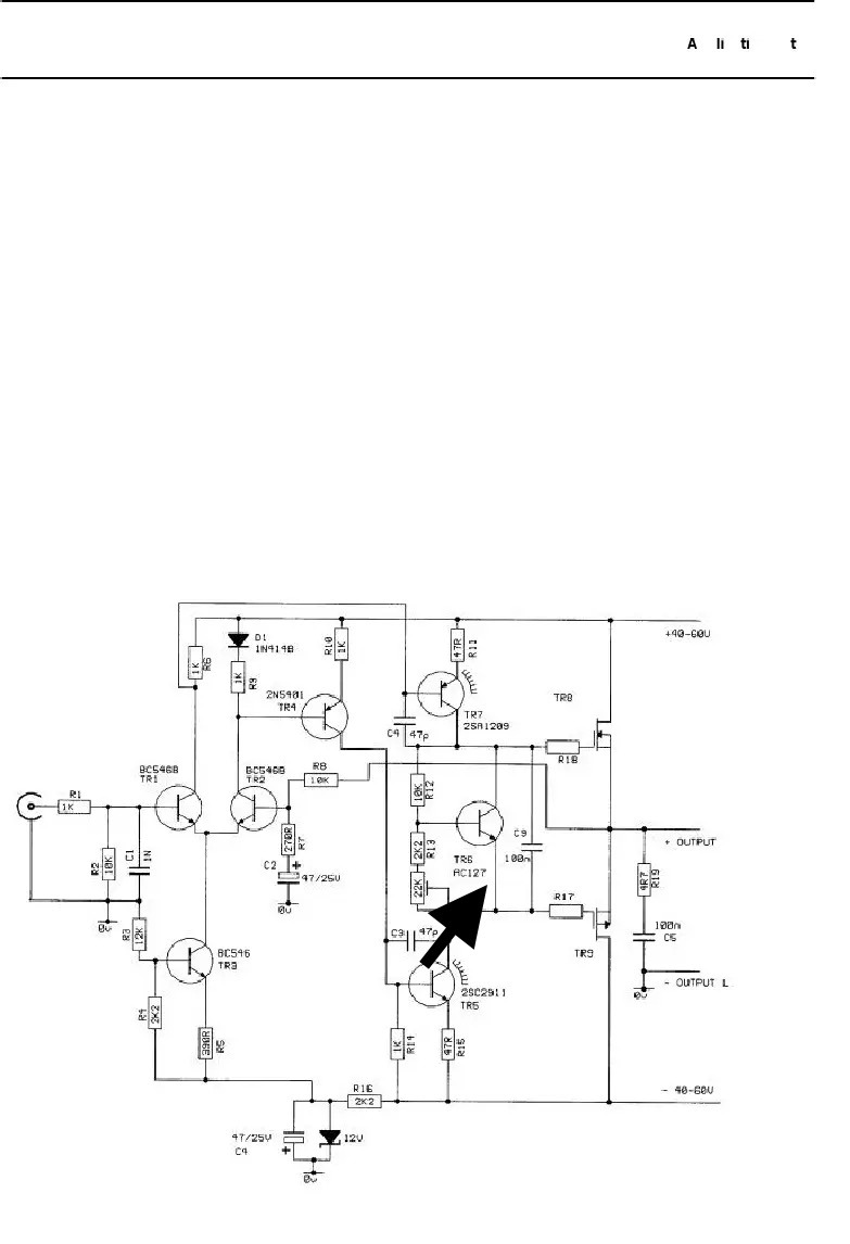

I don't want to make too many changes to the amplifier. At present, I want it to run close to the original circuit. But the deviation of the horizontal mos must be changed or it cannot operate.I don't believe that any circuit is modified without understanding the principle, which will no longer be Counterpoint.
Thank you, Anatech. But I really need to confirm whether the output DC is biased to be modified.

Hi William,
I hear you.
The original circuit is heavily flawed. Counterpoint didn't do power very well at all. That goes for solid state amps and even tube based high voltage regulators.
I'll be honest with you. If you change the design and it stills sounds like a Counterpoint, it's a Counterpoint as if someone who knew what they were doing designed it. The design isn't greatly deviated and I used the original PCB in early adaptations. Added are better housekeeping stuff, and the output stage change.
The original output design is garbage. it is unreliable, non-linear and simply a source of trouble. There is zero point in attempting to preserve that part of the design. But, you do you. I can only tell you what decades of experience has taught me.
I hear you.

Well, I spent a lot of time looking up the circuit. I think Counterpoint's as series power amplifier circuits are similar, basically drain valve circuits, so the amplification signal processing is all on the two gauge axes in front and behind c5 c6. 2n2222A is temperature compensation and vbe biased to vr2 to adjust DC offset.

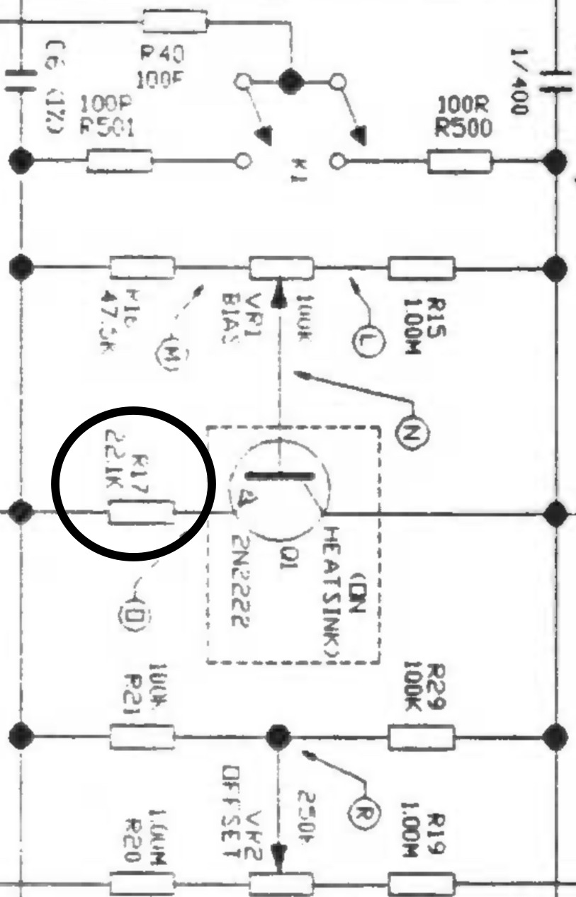

Among them, my question is what does R17 do? I want to remove R17 in my modification idea.
I also studied the diamond buffer circuit, which can well achieve differential and impedance matching, and has a good design.
Use two capacitors in Counterpoint to achieve the difference.
I'm trying to understand the compensation

R17 modifies the compensation. You need to keep it, but change the value.
The junk on the side was an analogue protection for temperature thing as I recall. Overly complicated and turned off from the factory (minimum effect). I have always ignored it. So when designing a new output stage, simply ignore that junk. It will hurt your head (I understand it) and it isn't used to begin with. It was an idea to try and calculate instantaneous output device temperature.
A power diamond buffer is used in the Marantz 300DC and Nakamichi 620 (? I think) amplifiers. Probably others as well. It can sound very smooth. My main and bench amplifiers are both modified Marantz 300DC amplifiers. The main speakers are 4 ohm, 86 dB/watt PSB Stratus Gold, so not an easy load. The diamond buffer got my attention in many signal circuits and a few amplifiers that all sounded great (Cyrus Power is another). Some research and experimentation really sold me. So far it seems to be perfect for the Counterpoint amplifiers.

What that resistor does is affect how strong the temperature compensation is, not the voltage.
Counterpoint does not use a diamond buffer at all. Read up on them.

R17 will affect the compensation intensity rather than the voltage. Well, how to calculate its specifications?

Hi William,
What I would do is set the bias with the resistor value as it is, then see if the bias remains stable or not. Vary the value of the resistor so the bias remains the most constant with temperature. Run the amp after that to get it warm, then check to see where the bias ends up. Allow the amp to cool while on and just see how stable the bias is. Don't expect perfection, some increase while warm is expected, but it should not go too far high, and also return once the heat sink cools down to normal idle temperature.
Alan is correct. The fuse is only there to open if you have a fault.
I'm sure someone could stick it in spice. I'm not going to even try to work it out.R17 will affect the compensation intensity rather than the voltage. Well, how to calculate its specifications?
